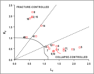

The wide plate tests were analysed in accordance with BS7910 level 2a or 3a, approximately equivalent to FITNET Option 1 (initiation route and tearing route), as follows:
  • The membrane stress applied perpendicular to the flaw at the point of failure was treated as the primary stress, Pm.
  • The fracture toughness Kmat used in the analysis was taken as the lowest of three SENB test results or equivalent (ie Minimum of Three Equivalent or MOTE) at the appropriate temperature and section thickness.
  • Analyses were carried out using a BS 7910 Level 2a FAD. This is very close to the FITNET Option 1 FAD for continuous yielding.
  • The appropriate tensile properties for each test temperature were estimated from the properties measured at +70°C (this simplification allows all results to be plotted on a single FAD). Note that in practice the material showed discontinuous yielding, which is reflected in the shape of the FAD for Lr>1.
The results of the analysis are given in Figure 1. Numbers adjacent to each data point indicate the test ID as shown in Table 2. It can be seen that all the specimens failed in the 'unacceptable' region of the failure assessment diagram (FAD), as expected. Results fall in the fracture-dominated (ID 2, 8, 15, 16, 40), 'knee' (ID 14, 41) and collapse-dominated (all other data points) regions of the FAD, depending on the test temperature.
Option 1 of FITNET gives the user the choice of an analysis based on initiation of fracture only, or a full tearing analysis. All of the single points in Figure 1 correspond to initiation of fracture (analysis to BS7910 level2a).
The results of test ID 1 have also been interpreted using an Option 1 tearing analysis (BS7910 level 3a); the result can be seen in Figure 1 as a locus of points corresponding to various levels of tear length between 0.2and 5mm. At low levels of tear length, Δa, the initiation and tearing analyses are virtually coincident.
Fig. 1. FITNET Option 1 (BS 7910 Level 2a/3a) failure assessment diagram for A533B wide plate tests

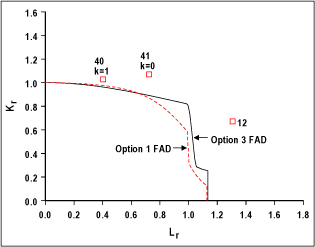

Selected low-temperature tests (ID 12, 40 and 41) were analysed next using the FITNET Option 3 (BS7910 Level 2b) FAD. Results of the analysis are shown in Figure 2. Note the slightly different shape of the FAD (solid line, based on the actual stress-strain curve at -96°C) compared with the Option 1 analysis (dashed line). Since the Option 1 failure line lies wholly inside the Option 3 line, there is a slight benefit in using Option 3, although this is more apparent for test ID 12 than for the other tests.
Fig. 2. Results of selected wide plate tests using FITNET Option 3 (BS 7910 Level 2b)
The CCT tests on 50mm thick plate at -100°C (ID 40 and 41) proved to be particularly amenable to analysis using the more advanced options in FITNET. Numerical analysis[7] of the CCT test configuration had predicted a strong effect of biaxiality on the effective toughness of through-cracked plates tested in the lower transition, with uniaxially loaded specimens showing an effective toughness some four times higher than that of SENB specimens. Conversely, equibiaxially loaded specimens (k=1) were predicted to have an effective toughness approximately the same as that of an SENB specimen. This trend, initially predicted by numerical analysis, was confirmed by wide plate testing. The effect can be seen in Figure 2 by comparing the positions of the analysis points 40 (equibiaxial loading) and 41 (uniaxial loading). The latter point lies further from the failure analysis line, ie the safety factor associated with the standard analysis route is higher.

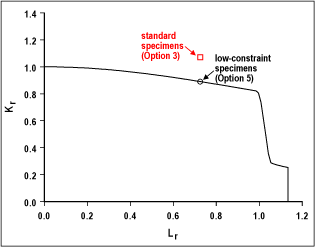

Later, further analysis of the CCT wide plate test results was carried out under the European SINTAP ('Structural Integrity procedures for European Industry'[8]) programme.[9,10] A series of low-constraint small-scale fracture mechanics tests was carried out using shallow-notched SENB specimens as part of the validation of Appendix 3 of the SINTAP procedure, which addresses the treatment of crack tip constraint. The uniaxial wide plate test (ID 41) was then re-analysed using the SINTAP 'constraint matching' option, equivalent to FITNET Option 5. The equivalent analysis was not carried out with test ID 40, since the similar constraint conditions in deeply-notched SENB specimens and equibiaxially loaded CCT plates would produce similar results to those of an Option 3 analysis.
Figure 3 compares the results of a 'standard' analysis to BS 7910 (FITNET Option 3) with a more advanced analysis (FITNET Option 5) using the constraint matching approach. The datapoint associated with 'constraint-corrected' data lies much closer to the failure analysis line, indicating the benefits to be gained from using constraint correction.
Fig. 3. Results of uniaxial wide plate test (ID 41) using analysis based on both deeply-notched and low-constraint specimens (FITNET Options 3 and 5)

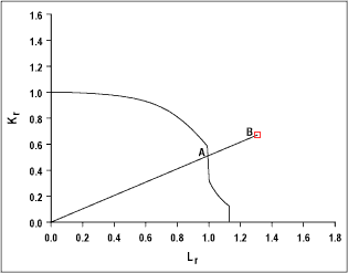

In order to compare the various assessment levels, the associated safety factors were calculated, as shown in Figure 4. If O represents the origin of the FAD and B represents the analysis point associated with the test result, the line OB intersects the failure analysis line at A. The ratio OB/OA represents the safety factor associated with the analysis.
Fig. 4. Definition of safety factor

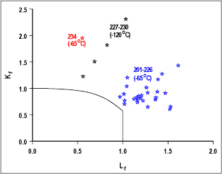

Results of all 31 tests are shown in terms of a BS 7910 Level 2a (FITNET Option 1) FAD in Figure 5. The value of fracture toughness used in the calculation is based on (µ-1SD), ie one standard deviation below the mean value of fracture toughness, measured on a large sample of specimens in terms of critical J. A cut-off of Lr,max=1.0 has been used, since the material has a discontinuity (a Lüder's extension) in the stress-strain curve. Note that results corresponding to parent materials tested in the transition region (ID 201-226) are clustered in the 'knee' area of the FAD, whilst the four tests carried out at -120°C (ID 227-230) and the single result for the ring-welded specimen (ID 234) lie in the fracture-dominated part of the diagram.
Fig. 5. Results of all wide plate tests (ID 201-230 and 234) carried out at -65 and -120°C

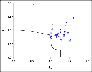

A more accurate analysis of the tests carried out at -65°C is given in terms of a Level 2b/Option 3 analysis in Figure 6, which shows failure of several specimens in the so-called 'knee' region, very close to the failure assessment line. This phenomenon (the observation of lower inherent safety factors in the knee area of the FAD) has also been discussed by Muhammed et al[12] in a separate study of a large number of wide plate tests.
Fig. 6. Results of wide plate and mini wide-plate tests (ID 201-226 and 234) at -65ºC; Level 2b analysis

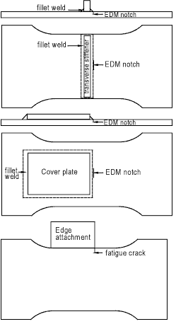

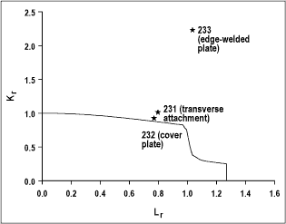

The tests were carried out on surface-notched and edge-notched plates representing various bridge details, as shown in Figure 7.The tests were carried out on surface-notched and edge-notched plates representing various bridge details, as shown in Figure 7. Standard K-solutions for surface-cracked plates, modified to take account of the presence of a welded attachment, were used for the analysis of the first two cases. In other words, the presence of the welded attachment was accounted for by using an Mk correction factor, derived from the attachment length in accordance with BS 7910 using the 2-D Mk solution. The depth of the welding residual stress field was calculated from the welding heat input as per Annex Q of BS 7910:2005. Note that the very bulky cover plate on the second test stiffens the right-hand side of the specimen, and induces a bending stress, even though the loading applied was nominally tensile. This bending stress, determined from strain gauges, was included in the analysis.
The third case represents an edge-welded detail, which is considered to be very detrimental to structural integrity and is thus not permitted by many codes for load-carrying members. This was analysed by calculating a stress concentration factor (SCF=1.6) at the position corresponding to the crack tip, using a finite element model of the uncracked geometry. It was then analysed as an edge crack in a plate.
Note that, in spite of the presence of welded attachments, all crack tips were located in parent material, so that the tensile and fracture toughness properties from the original ECSC programme (see Table 5) could be used. Welding affected only the details such as secondary stress, determination of Mk and local bending in the cover plate detail.
All three assessment points (see Figure 8) lie outside the FAD, with the cover plate and transverse attachment details relatively close to the failure assessment line. The analysis point for the edge-welded detail (ID 233)lies well outside the failure analysis line (Kr=2.2), suggesting that a more advanced analysis (e.g. using Option 4 of FITNET) might be beneficial, although such an analysis has not been carried out at the time of writing.
Fig. 7. Geometry of specimens used for bridge detail tests; tranverse stiffener detail (ID 231, top), cover plate detail (ID 232, middle) and edge-welded attachment (ID 233, bottom)
Fig. 8. BS 7910 level 2b (FITNET Option 3) failure assessment diagram for bridge detail tests (ID 231-233)

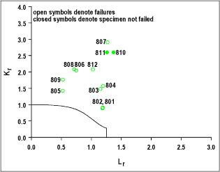

Analysis of the parent metal wide plate specimens has been carried out in accordance with BS 7910, with toughness given in terms of Kmat calculated from J. Results are presented in Figure 9. The effects of warm pre-stressing (WPS) can be seen qualitatively by comparing ID 803 (no WPS) with 804 (WPS), and ID 805 (no WPS) with 806 (WPS). Points associated with WPS specimens lie further from the failure line, suggesting a WPS effect (although it is marginal in the case of ID 803/804).
The analysis of the welded specimens takes the effects of WPS into account by using the measured values of residual stresses (a centre hole strain gauge rosette technique was used for surface readings, and block removal, splitting and layering for through-thickness measurements).
Note that the equibiaxial test at -70°C (ID 809) led to failure under a membrane stress of 136N/mm2. A similar plate was warm prestressed and then re-tested at progressively lower temperatures. The first test (ID 810) did not fail at the load limit of the test machine at -70°C (equivalent to a membrane stress of 345N/mm2), nor again at -90°C (ID 811, Pm=345N/mm2). Failure finally occurred in the third test at -120°C (ID 812, Pm=351N/mm2), indicating a strong effect of WPS.
Fig. 9. BS 7910 failure assessment diagram (level 2b, FITNET Option 1) for ID 801-812
This series of tests provides an interesting validation case for examining the effects of proof loading and warm pre-stress, of particular interest to the pressure vessel industry. The analysis shown above is based on the main clauses of BS 7910. Re-analysis in terms of Annex O of BS7910 and/or FITNET Section 11 is therefore recommended.

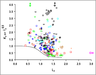

The tests described in this paper cover only a small percentage of the 300 test cases analysed by TWI, which in turn constitute only a part of the validation package (section 13/Volume 3 of FITNET). Nevertheless, the 64 test results presented above provide some flavour of the overall dataset, a summary of which is shown in Figure 10. All points represent failure of a test specimen or component; when conservative but representative input data were used, as recommended by BS7910 and FITNET, the analysis points fall outside the failure analysis line, confirming the validity of the fracture assessment procedure.
Fig. 10. Summary of failure points using BS 7910 level 2a (FITNET Option 1) FAD
