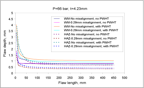

Fatigue and fracture engineering critical assessments (ECAs) were carried out to the procedure specified in BS 7910: 1999 [5] . The ECAs considered pipes with an axial surface-breaking flaw at the ERW weld seam and corresponding HAZ. It was assumed that the joints were initially proof tested (on commissioning of the pipeline in 1982) at a pressure of66barg.
Fracture ECA
The level 2B (material-specific) failure assessment diagram (FAD) was employed. The lowest experimentally determined values of fracture toughness for the ERW weld and HAZ at -10°C; CTOD =0.007mm and CTOD = 0.018mm,respectively, were used in the ECAs.
From the tests conducted on the 6 sections, the lowest stress-strain curve and tensile properties (0.2% proof strength of 372.4 and tensile strength of 499MPa) for the parent material at -10°C was used in the ECA.
Fatigue ECA
A 2.5-month record of cyclic pressure variation in the pipeline during normal operation was extended over a two-year period, to estimate typical, future operation of the pipeline before shutdown. The full cyclic data was simplified to a single spectrum, using the rain flow technique; the pressure drop associated with shutdown and pressure is associated with start-up periods were also added. The number of times the pipeline was pressure tested at a pressure range of 66barg, was also considered in the fatigue spectrum. The resulting 2-year block was repeated to simulate the 22 years of pipeline in service-life. This simplified spectrum was applied to the wall thickness case of 4.23mm.
As the product will be transported in a dry condition, the appropriate fatigue crack growth equation for steel in air, as recommended in BS 7910: 1999, was implemented.
The worst case ECA is shown in Fig.8.
Fig.8. ECA results for 4.23mm case

Upon review of the work conducted it appeared that the results would support the up-rating of the line. The six burst tests demonstrated that leakage or rupture typically initiated in the parent material, at regions of external or internal damage, suggesting that the seam weld had sufficient integrity, however the poor toughness results could not be ignored. The poor toughness results also impacted the ECA tolerable flaw size calculations resulting in some doubtas to whether they would be picked up during inspection. The ECA procedure includes a high degree of conservatism and some of the assumptions made could be relaxed if more appropriate data were available. If the operator were able to prove that the minimum temperature would be above -10°C perhaps not below 0°C, improvements in toughness could be achieved and possibly improve the ECA results. It was also apparent that the inline seam normalising process carried out during production was not as effective as it should have been resulting in a less than satisfactory microstructural refinement. This contributed to poorer material properties.
Conclusions
Based on the results of the study the following conclusions were drawn:
  • The review of the data illustrated that the area having lowest fracture toughness at -10°C was the ERW bond line.
  • The ECA showed the tolerable flaw sizes to be very small, potentially below the limit of detectability of current inspection techniques.
  • The lowest rupture occurred at 2.3 times the proposed future operating pressure.
