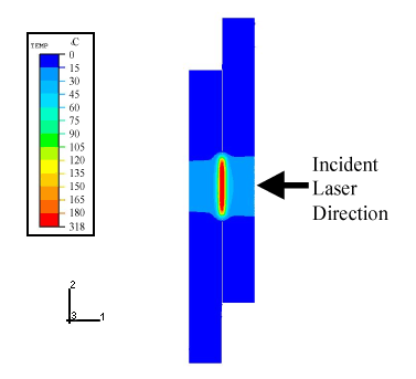

Fig.7. Estimate of the thermal profile of laser weld using infrared dye from finite element analysis
The visible and NIR spectra of the substrate/film/substrate ensemble were measured before and after the welding. The low concentration of the dye in the film makes ready discrimination of the differences in these spectra difficult. However, spectral measurements of the colour coordinates through the welded parts show a neutral colour result of the weld. Analyses on the molecular fate of the dyes having undergone the welding procedure are underway, however it is believed that the dyes at this interface will have been decomposed to colourless organic molecules from the temperatures believed to have been attained at the weld interface.

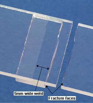

Welded samples have been tensile tested using standard procedures. Failure is observed to occur not across the weld interface but in the parent material near the edge of the weld ( Fig.8). The failure force was 50N per mm weld width.
Fig.8. In tensile testing of a lap weld in PMMA made with infrared dye impregnated film at the interface, the failure position is in the parent material at the edge of the weld
