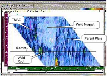

5.4 Noise distribution results and analysis
During the data collection, it became clear that there was a clear noise pattern associated with the FSW nugget, as shown in Fig.9 below.
Fig.9. Sectional image through Weld T4 with some entrapped oxide
In Fig.9, the pale blue zone shows the grain scatter noise from the weld nugget, whereas the darker blue zones correspond to the parent plate. In this sample the low noise zone does not extent for the full depth of the parent plate. Additionally a high noise zone can be seen corresponding to the Thermo-Mechanically Affected Zone (TMAZ). The TMAZ generates ultrasonic back-scatter noise from the relatively large, vertically orientated grains in this zone. These relatively high amplitude signals can be above the normal aircraft industry reporting threshold, causing false defect calls. For this reason, simple amplitude crossing defect rejection criteria cannot be used for these inspections. Figure 10 below shows a macrograph of weld T4. This weld shows an entrapped oxide defect in the root of the weld with a through wall depth of 0.4mm. This corresponds to the depth of the ultrasonically higher noise zone in the weld root shown in Fig.9 above.
From consultation with TWI and other welding engineers it was determined that, where the weld nugget is correctly forged through to the weld root, entrapped oxide defects should not be present. Hence, if a method could be developed for determining the depth of the correctly stirred zone, a quality control method could be provided to ensure that the welding process was in control and there was a low probability of entrapped oxide defects being present.

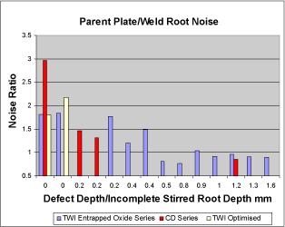

To provide a quantitative inspection method, a stable measure of the mean noise level within the weld root was required. Initially the ratio of weld root noise to weld nugget noise was studied and reported [2] . From further study, the ratio of the parent plate noise to the weld root noise was chosen as the most stable measure, this ratio normalising all the inspection parameters to that of the parent plate material noise. The initial work was undertaken with Tomoview software, which was found to be suitable for the development work. More recently the R/D-Tech Quickview was chosen to provide a route to export the data to the FSW welding control system. Both software versions provide a tool for area noise assessment. This tool provides two numbers: average amplitude of signal amplitude within the contour on the display, and the standard deviation of the amplitudes within the contour. The accompanying picture is a display of the maximum amplitudes within a defined weld volume. In Fig.11 this is at a depth of 2 to 3mm from the weld root.
The results illustrated in Fig.12 are of four welds in aluminium alloy 2219, identified as CD2, CD5, CD7 & CD9. Weld CD2 was fully penetrated with no welding flaws detectable ultrasonically or by micro-section. The section through weld CD2 is shown inFig.13. Note that an un-forged weld root has a noise ratio of one, i.e. the same grain structure and noise as the parent plate.
Fig.12. Graph of noise ratio vs distance from weld root
Fig.13. Macro-section through weld CD2
Samples CD5 and CD9 ( Figure 14 shows the micro section of CD9), have no entrapped oxide but the weld nugget was not fully penetrated. Figure 12 clearly shows that for a defective weld the ratio of weld noise to parent plate noise is near one. Weld CD7 is noisier than the parent plate because of the presence of a void. In a good weld (CD2) the weld noise is lower than the parent plate by a factor of three. For welds CD5 & CD9 ( Fig.12) for a distance of 0.5mm from the weld root the noise approaches that of the parent plate but the noise ratio rapidly increases away from the root. A nominal ratio of 1.5 is presented on the graph, which could be used for an on-line quality control rejection level.
Fig.14. Macro-section through weld CD9 showing a 0.2mm high coarser grained zone in the root
Statistical analysis of all the data has been performed to determine the reliability for individual measurements. Part of the analysis is given in Fig.12. which shows that, for a completely forged weld (CD2), all the results fall within the estimated 80% confidence intervals (shown by the error bars in Fig.12). It also shows that at a constant depth within the weld the data has a very consistent noise ratio. Samples CD9 and CD5 show that the noise ratio progressively increases with height within the welds. As the distance from the root increases towards the centre of the weld, the degree of forging increases and the noise ratio increases. It can be seen that the confidence interval for these measurements is equally small as for the other samples.
Figure 15 shows a graph of noise ratio for 16 weld samples of differing degrees of weld penetration. It must be emphasised that for each TWI weld a different welding tool design was used. Thus, for a constant weld set-up, the variation in material noise ratio will be extremely small and the NDT method will be monitoring changes along the weld and not between deliberately different welding parameters. Figure 15 shows that the ultrasonic inspection method can clearly identify welds where the weld root has incomplete forging to a depth greater than 0.5mm. Furthermore, where weld roots are fully forged, they can be clearly identified.
Fig.15. Graph of noise ratio for 16 weld samples with varying degrees of entrapped oxide
