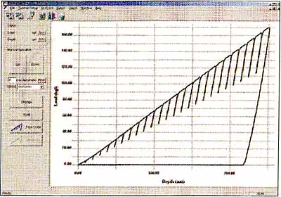

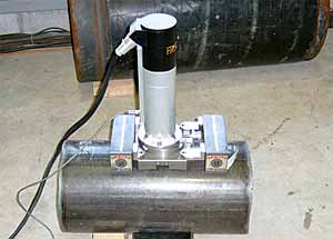

IIT is different from a conventional hardness test. For the purposes of determining tensile properties, a spherical indenter is driven at approximately constant speed into the surface of the material to be measured, Fig.1. The load required to reach the penetration depth is recorded. At specific depths, the indenter is unloaded and withdrawn slightly and then reloaded to a greater depth in a series of increments until the test is complete.
Fig.1. IIT unit magnetically attached to API 5L X60 pipe, showing umbilicals to a data processing computer
Indentation load-depth curves are obtained from this measurement procedure for each repeated loading and unloading cycle, Fig.2. There are three stages of deformation in the indentation process: elastic, elastic-plastic and fully plastic. The load/unload data points are defined by measured indentation parameters, eg. contact depth, indentershape, and the morphology of the deformed surface (ie. elastic deflection and the plastic material pile-up around the contacting indenter). A true stress-true strain curve is then derived by an algorithm that fits a curve to the load/unload data points, given knowledge of the generic type of material.
Fig.2. Typical load depth curve showing loading/unloading steps (Courtesy FRONTICS Inc)

  • Secure attachment of the IIT unit (eg. for plates or small diameter pipes, flat or curved magnets can be used; for large pipes a chain lock system may be used);

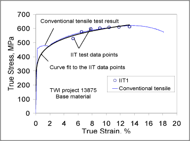

One of the groups of specimens investigated were API 5L X60 carbon-manganese steel pipes, with 20mm wall thickness and 508mm outside diameter, some of which were girth-welded by the GMAW process. Figure 3 shows the IIT results for the parent material. Both weld and parent materials exhibited Lüders plateaus in their stress-strain curves.
As was the case for all the specimens within the group, the IIT tests resulted in lower tensile values than those from conventional tensile tests, especially in the areas near the yield and the Lüders plateau. Yield strength was underestimated by 10-23% (mean underestimate of 16.5%) and ultimate tensile strength by 2-7% (mean underestimate of 4.5%). The level of underestimation was greater for the yield strength than that for ultimate tensile strength.
In summary, IIT was found to be capable of estimating the stress-strain curve to within a reasonable and safe range of that obtained from a conventional tensile test. The technique gives repeatable results (within the band of normal variability) so long as surface finish, test piece clamping and machining have been carried out correctly.
Fig.3. Experimental versus fitted indentation stress-strain curves, for X60 steel parent material
