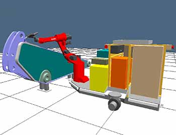

The greatest potential for productivity improvements comes from using robots in construction. Japan still leads the work in new robot installations per annum, but generally robot take-up for welding is slow in building and bridge construction because manipulation and good fit-up are difficult on large structures, which may comprise one-off designs. Only in situations where product repetition and/or tonnage throughput are high, combined with relatively standardised designs, are robots being employed. [2] Robot profile cutting is increasing in usage and in Japan, some building frames are now being welded on robot lines and agile robots are also used for site welding building column joints at height. The applications most suited to robot use involve butt and fillet welds in the fabrication of beams, welding of stiffeners to beams, welding of end plates and the assembly of panels or decking.
A likely trend is to 'take robots to the work' and use them for large part and sub-assembly manufacture in cells which house autonomous vehicular robots. [3] These robots, mounted on moving platforms are manoeuvered around the parts to be welded and are capable of all-positional welding using the MAG process with tubular wires,( Fig.2). The part positions are accurately determined within the cell using cell roof sensors and the robot can then traverse the cell, locate the parts and then the joint to be welded using local sensors. Welding under sensor control then follows. This arrangement is particularly suited to large numbers of parts that are of a modular shape but where dimensions can vary, such as in earth moving equipment, or bridge modules.
Fig.2. Schematic diagram showing autonomous robot vehicle navigated by vision system, being used for all positional MAG welding

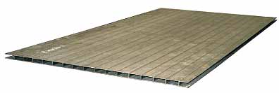

Laser welding following laser cutting can bring further benefits. One new opportunity in the construction industry for which laser welding is highly attractive is the manufacture of steel sandwich panels which can give a 10-foldincrease in stiffness and 50% reduction in weight compared to solid panels ( Fig.3). Again, the shipbuilding industry has shown the way and one yard is routinely using sandwich panels for decking and bulkheads in passenger shipping. [4]
Fig.3. A typical laser welded sandwich panel and advantages over conventionally stiffened panels (photograph: courtesy Meyer Werft)

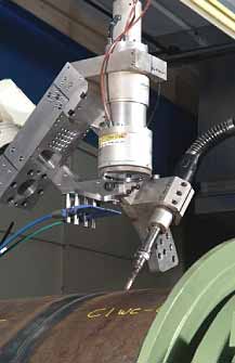

Considerable effort is now being put into gas transmission land pipeline cost reduction by increasing the speed of girth welding and reducing the number of welders and welding stations. Lasers and hybrid systems offer a solution to this challenge and girth-weld procedures are under development using either a high power CO 2 lasers alone [6] or Nd:YAG laser/MAG hybrid welding. [7] Advantages of the latter approach are that Nd:YAG lasers offer fibre delivery and are more easily containerised for on-site use than CO 2 lasers. Further, the hybrid approach offers greater tolerance to fit-up and the increased heat-input gives higher travel speeds or deeper penetration, There is also an opportunity to modify and control weld defects and microstructure by using appropriate filler wires.

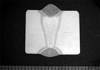

The equipment being developed is shown in Fig.4(a) and a typical macro section in Fig.4(b). To date, successful welds have been made which meet the requirements of pipeline specifications such as API 1104 in terms of criteria for imperfection limits, hardness and low temperature toughness.
Fig.4. Nd:YAG laser - MAG hybrid process being developed for land pipeline girth welding Fig.4a) welding head
Fig.4b) macrosection showing MAG root and cap beads and central hybrid weld bead

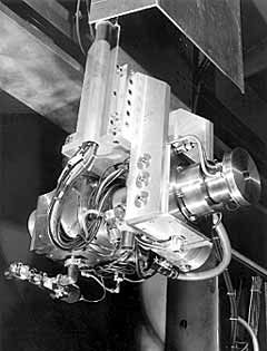

In conventional EB technology, triode guns with directly heated cathodes are prone to short filament lives, beam voltage and current ripple, and a tendency to gun discharges that can create sporadic but serious weld defects. These problems have been solved at TWI by the development of special indirectly heated cathodes, the use of RF excitation for cathode heating (simplifying the cabling), and the use of a diode rather than triode gun design. A switch mode power supply coupled with these changes in gun design have resulted in small, more compact and much more reliable guns, giving enhanced beam quality, Fig.5(a).
Fig.5. Reduced pressure electron beam welding system Fig.5a) gun column

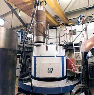

Fig.5b) arrangement for one shot girth welding of steel pipes
Reduced pressure EB welding using chamber pressures of around 1mbar has been another major step forward in simplifying EB welding operations. The beam shape and beam penetration at, say 5mbar, is identical to that at the more conventional pressure for EB welding of 5 x 10 -3 mbar. This reduced pressure option does away with the need for large vacuum chambers and worries about leaks and seals. Simple mechanical pumps and local seals are sufficient to achieve ~1 mbar. These systems are also more tolerant to fluctuations in working vacuum pressure, gun to work distance and workpiece cleanliness.
TWI has developed a 200kV 100kW system which can operate over the full range of vacuum, namely, from 1000 mbar to 0.01 mbar. Reduced pressure applications using ~1mbar are being developed for pipeline girth welding, Fig.5(b) and for manufacturing large copper containers for nuclear waste storage. Whilst both applications are not yet using these improved EB technologies in production, the developments are at an advanced stage. The reduced pressure process seems well suited to long lengths of one-pass welding in structural steel for thicknesses up to 100mm, but is obviously restricted to shop welding or to controlled environment cells on site.
