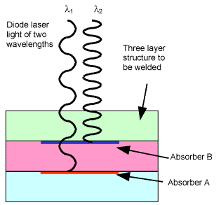

Triple layer joining
Figure 7, shows the absorption coefficient of two particular infrared absorbers (A and B) of the type used in the Clearweld ® process, plotted against laser wavelength. The 808nm and 940nm wavelengths were obtained from a diode laser and the 1064nm wavelength was obtained using an Nd:YAG laser. The figure shows clearly how wavelength sensitive the absorbers can be and this sensitivity can be put to some interesting uses. The nature in which a diode laser is constructed makes it relatively easy to assemble a single laser, capable of operating at two separate or combined wavelengths, simply by switching the power to different stacks of diodes. TWI has such a diode laser capable of producing 150W of power at either 808nm or 940nm. 300W of power is available if both wavelengths are used simultaneously. Conveniently, both wavelengths are focussed with the same set of optics. Using this laser and two selected absorbers, it is possible to simultaneously weld three sections of plastic material together, as depicted schematically in Figure 8.
Fig.7. Absorption coefficient of two absorbers as a function of laser wavelength
Absorber B, highly absorbent at the shorter (808nm) wavelength, but able to transmit a significant fraction of laser power at the longer (940nm) wavelength is applied to the top surface of the intermediate layer, whereas absorber A, strongly absorbent at the longer (940nm) wavelength, is applied to the lower side of the intermediate piece. This assembly is then subjected to a single pass of a laser beam containing both wavelengths, resulting in a triple layer weld. The technique has been applied to both solid plastics and fabrics, as can be seen in the weld section shown in Figure 9, made using 300W of laser power, at a travel speed of about 500mm/min.
Fig.8. Schematic representation of a triple element weld, made using two infrared absorbers and two laser wavelengths
Fig.9. Section through a triple layer joint made using two infrared absorbers in 2mm thick sheets of clear PMMA

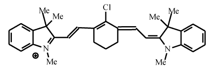

The ideal near-infrared absorber for laser welding, whilst producing minimal marking in the visible region, should have the following attributes:
  • A narrow absorption band near the laser wavelength with a high molar absorption coefficient.
  • Little if any absorption in the region 400-700nm.
  • Good solubility in the host material.
  • Good stability towards the incorporation method used.
  • Should not degrade to coloured by-products.
If all the known near-infrared absorber systems are considered, the vast majority can be discounted on the grounds that they have pronounced visual colour. Others can be disregarded because of their instability or their low absorption intensity. Selection of the most appropriate candidates from the remainder then becomes a matter of trial and error. Examples of three absorber types which can satisfy all of the above requirements are the cyanine absorbers, e.g. ( Fig.12), the squarylium absorbers ( Fig.13) and the croconium absorbers ( Fig.14).
Fig.12. Example of cyanine absorber [ λ max = 785nm; ε max ≈ 360,000 1.mol -1 .cm -1 in dichloromethane]
Fig.13. Example of squarylium absorber [ λ max ca.800nm; ε max ≈ 150,000 1.mol -1 .cm -1 ]
Fig.14. Example of croconium absorber [ λ max ca.820nm; ε max ≈ 200,000 1.mol -1 .cm -1 ]
