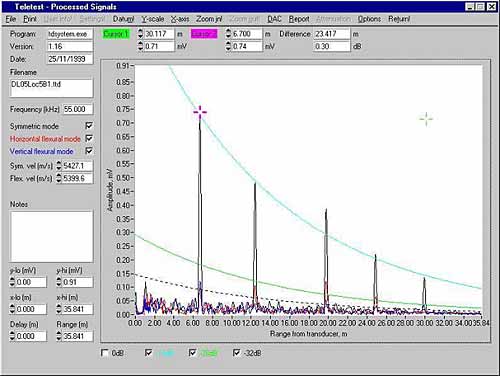

Guided waves propagating in the pipe wall, similar in nature to Lamb waves in plates, can propagate many hundreds of metres in plain pipe. However, unlike bulk waves used for conventional ultrasonic testing, where generally only a single mode such as either compression or shear exists, a large number of guided wave modes are possible. Consequently, the test system, the transducer array and the test parameters, such as frequency, need to be carefully designed to ensure that only the relevant wave modes are generated. One major difference between long range testing and conventional UT is that the test frequency needs to be as low as 20-30 kHz in order to reduce the number of wave modes present and to enable non-dispersive wave propagation. If the appropriate test conditions are chosen, the test results are readily interpretable. An example result is shown in Figure 2.
An important point to note is that the long range techniques currently available are screening tools and do not provide the same kind of resolution as local thickness measurements. The aim is to provide a rapid method of screening so that more appropriate test methods may be directed at areas requiring further attention in an efficient manner. Most importantly, long range UT does not provide a direct measurement of wall thickness, but is sensitive to a combination of the depth and circumferential extent of any metal loss, plus the axial length to some degree. This is due to the transmission of a circular wave along the pipe wall which interacts with the annular cross-section at each point. It is the reduction in this cross-section to which the long range technique is sensitive. This is shown schematically in Figure 3.
Fig.3. Guided wave tests are sensitive to flaw area as a proportion of the pipe wall cross-section, as shown. It is equally sensitive to internal and external flaws. The effect of multiple flaws is additive
