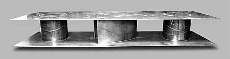

A schematic of the demonstration component is shown in Fig.1. The component comprised the following parts:-
  • Two rectangular C-Mn steel plates of dimensions 2200x700x8mm thick. These were used as base and cover plate (a in Fig.1).
  • Two C-Mn steel tubes (b) of height 284mm, internal diameter 305mm, each with a wall thickness of 6.35mm (1/4"). Each tube had been EDM wire cut into two pieces in a saddle joint configuration, and was to be welded back together around the 360° circumference of the tube. The cutting procedure provided a seam that varied from the normal position to up to 60° to the tube surface. Thus the required penetration over the circumference of the tube varied between 6.4 and 7.3mm.
  • Two laser cut, curved, rectangular C-Mn steel plates (c) of 445x284x12mm thick.
Fig.1. Schematic of 2200x700x300mm steel demonstration component:
a) cover plates
b) tubes
c) curved rectangular plates

The completed component can be seen in Fig.4. Externally, all welds appeared sound, although in some places the top bead surface was not smooth, particularly where mismatch or gaps had been present. The first saddle joint, which was not tacked, was welded in two 190° runs. This resulted in an opening up of the second half of the joint due to local thermal expansion. Nevertheless, the welds showed acceptable penetration and fusion. As a first approximation, the distortion of the final component (measured across the cover plate) was found to be a maximum of 3mm between the extremities (2200mm). The distortion is, in fact, more likely to result from variations in height of the internal plates and tubes (difference up to 1.5mm) than from actual thermal distortion. No cross sections were taken from the component.
Fig.4. Picture of finished 2200x700x300mm demonstration component
