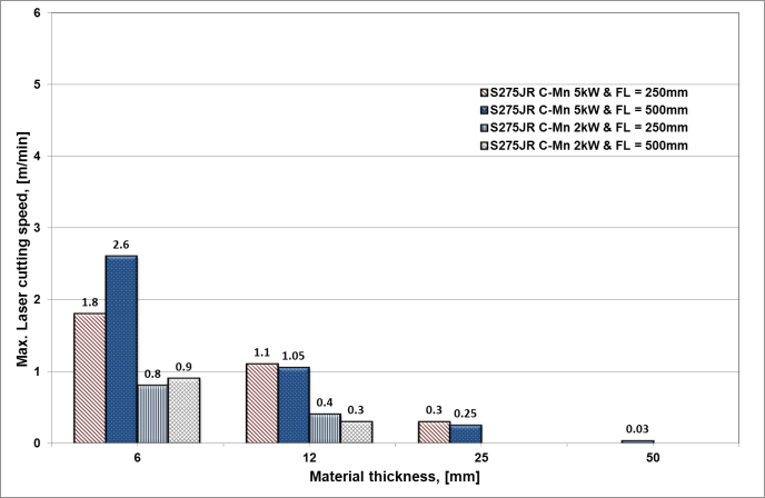

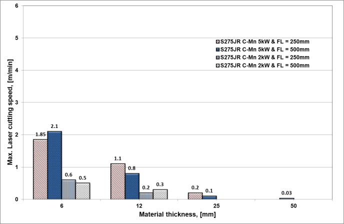

Figures 1 and 2 show the results of plotting the maximum laser cutting speed against the material thickness for the CMn steel, at the two laser powers used and for each focusing lens. Two extremes of standoff distance are also included, 5mm (ie close to the nozzle tip) and 25mm (ie far from the nozzle tip). These results show, as expected, that the cutting speed drops (for either lens) as the material thickness increases. However, the differences due to choice of focusing lens are not particularly great. In addition, the results at the two extremes of standoff distance are also not large, indicating the high tolerance of the laser cutting process used in this mode of ‘severing’.
Fig 1. Cutting results on CMn steel
Fig 1. Cutting results on CMn steel b)
Fig 1. Cutting results on CMn steel 25mm stand-off (left) 5mm stand-off (right)

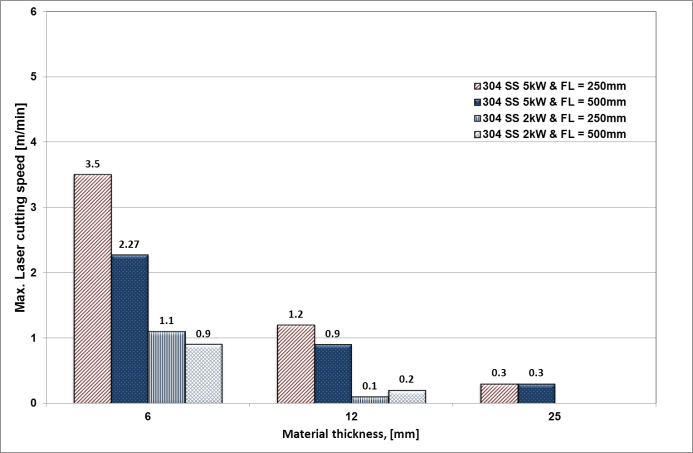

Fig 2. Cutting results on stainless steel
Fig 2. Cutting results on stainless steel b)
Fig 2. Cutting results on stainless steel 25mm stand-off (left) 5mm stand-off (right)

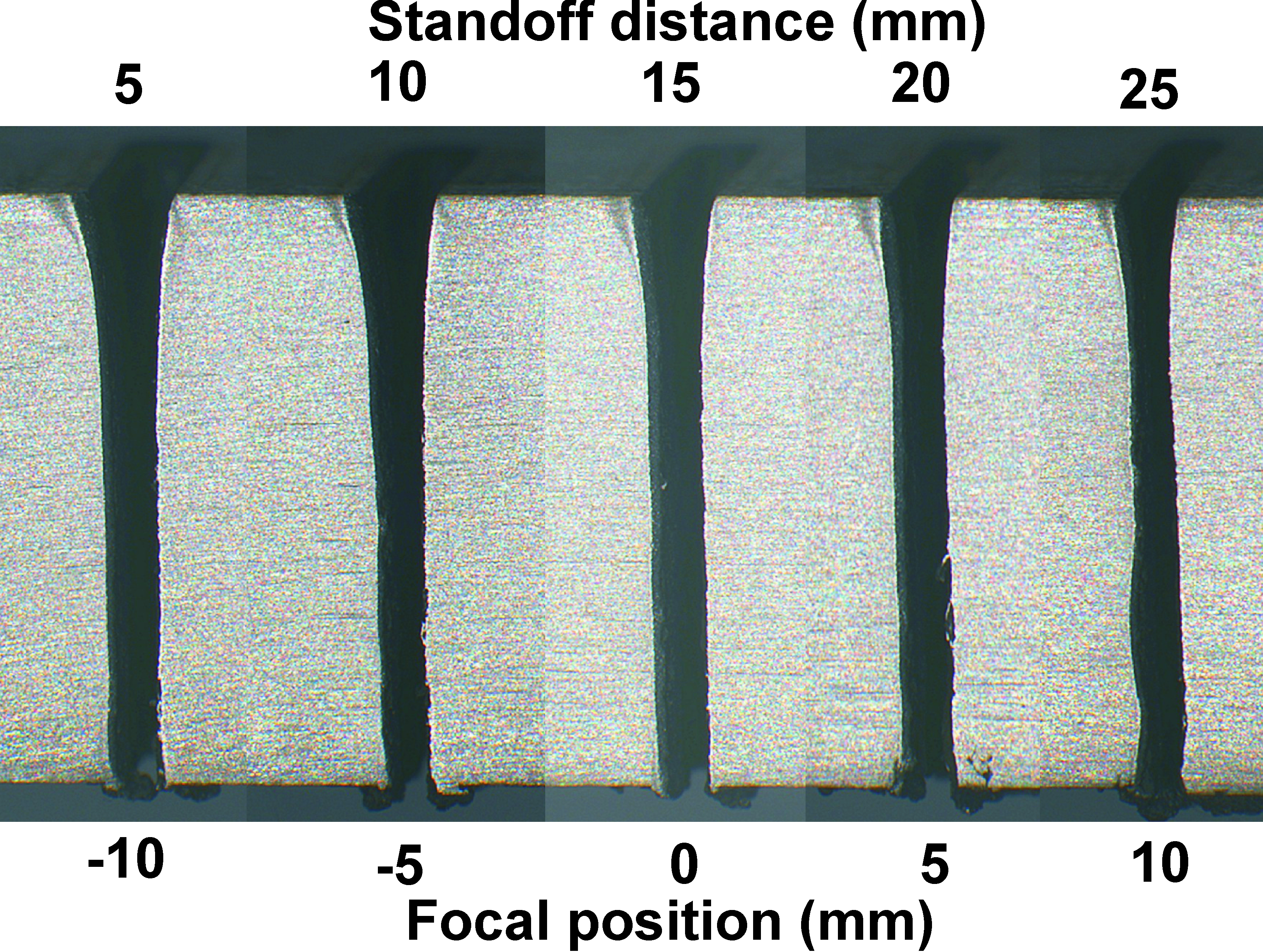

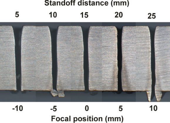

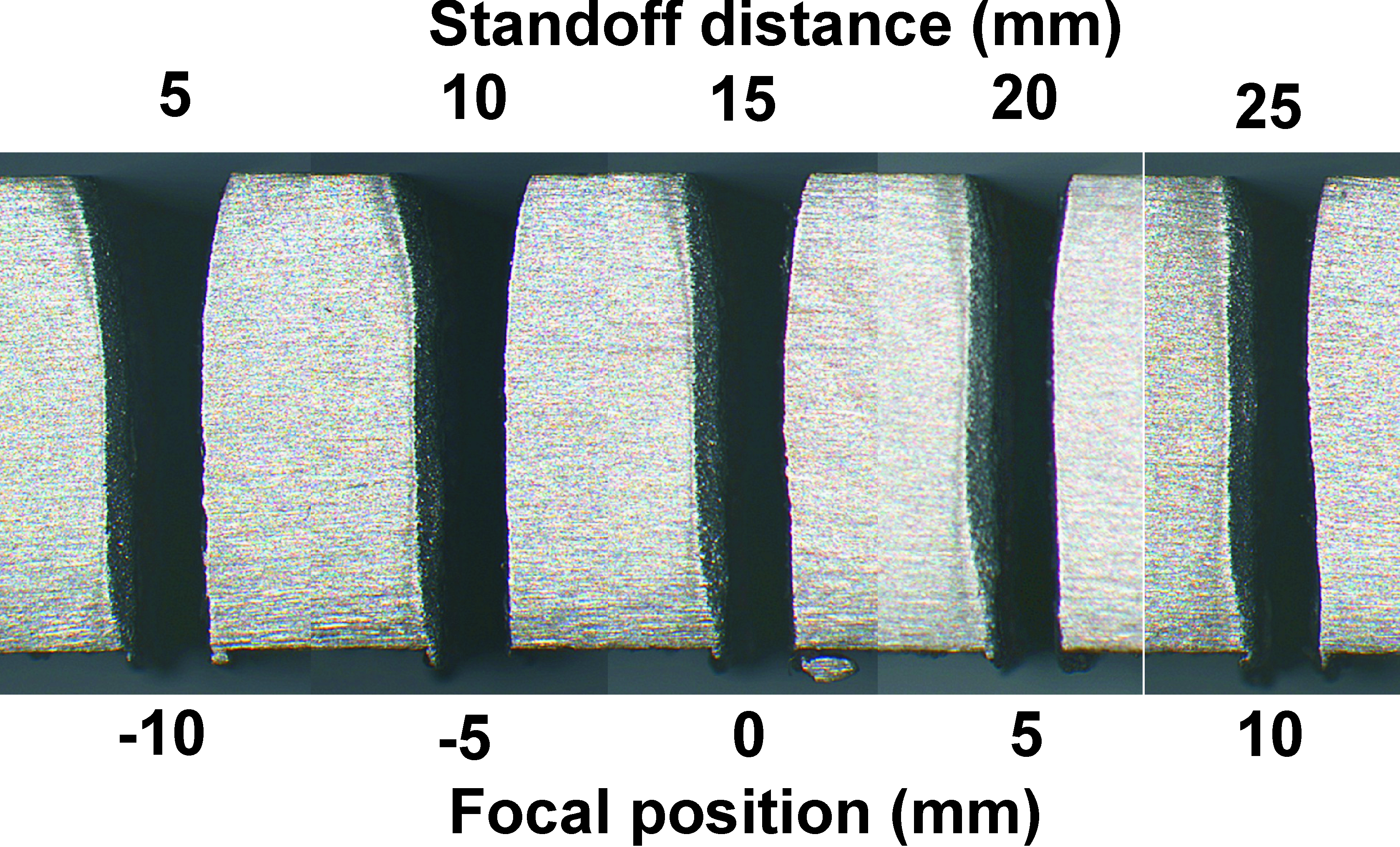

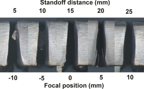

As seen in Figure 2, the trend was similar for cutting stainless steel, although higher cutting speeds were recorded for the thinner materials. The maximum cutting speeds obtained when using the 500mm focusing lens, determined for particular combinations of laser power and standoff distance, were used to cut simple kerf slots in the 6 and 12mm thickness C-Mn and stainless steel plates. Selected cross-sectional images of such kerfs for CMn steel are shown in Figure 3, and for stainless steel in Figure 4 at a laser power of 5kW.
Fig 3. Kerf cross-sections for 12mm thickness CMn steel (left) and 6mm CMn steel (right)
Fig 3. Kerf cross-sections for 12mm thickness CMn steel (left) and 6mm CMn steel (right) b)
Fig 3. Kerf cross-sections for 12mm thickness CMn steel (left) and 6mm CMn steel (right).
Fig 4. Kerf cross-sections for (left) 12mm thickness stainless steel and (right) 6mm stainless steel
Fig 4. Kerf cross-sections for (left) 12mm thickness stainless steel and (right) 6mm stainless steel b)

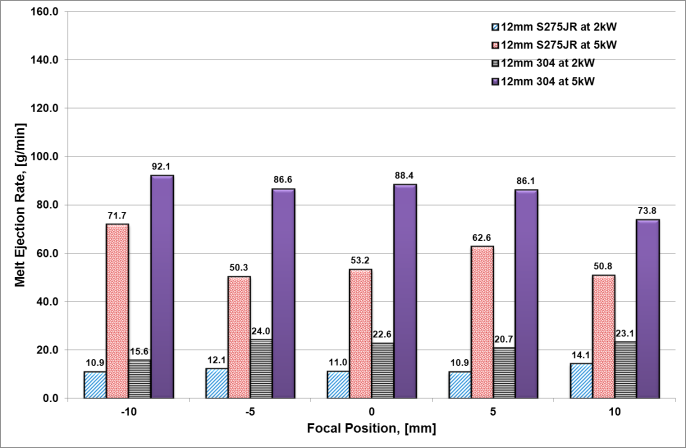

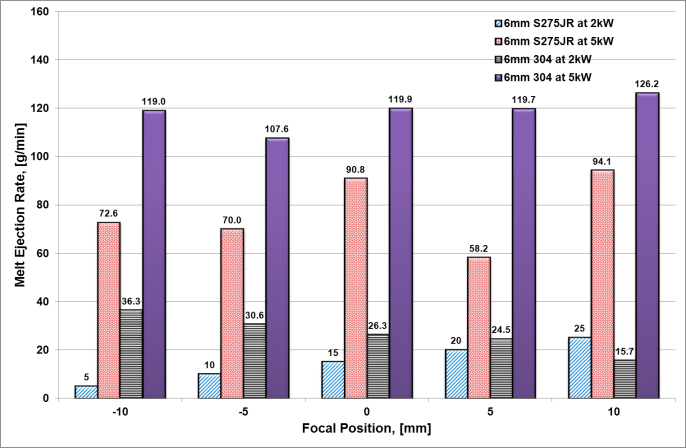

The kerfs were sectioned and their areas were measured. Material removal rates (g/min) were calculated for each kerf. The material removal rate can be considered as the product of the material density, the kerf cross-sectional area and the cutting speed. These properties are influenced by the ratio between the combined energy input from laser beam absorption and gas-jet momentum to the energy released during the melting of the material. The calculated material removal rates are presented in Figure 5, for both stainless and CMn steels and at both laser powers investigated.
For constant laser focusing conditions, this relationship suggests that the material removal rate is directly proportional to the combined laser and gas-jet power, and the physical properties of the materials being cut. This can be seen in Figure 5, where higher laser power generates higher melting rate which is easily expelled by the assist gas-jet. Differences in material properties between C-Mn and stainless steels will result in different melting rates, which can affect the melt expulsion efficiency. The difference in material removal rate between C-Mn and stainless steel is most dependent of the chemical composition, and the difference appears to increase with laser power. Analysis of the kerf cross-sections indicated that the main difference in the melt ejection rates between the two materials could be attributed to side-ways burning of the C-Mn steel during cutting. Such burning probably affects the melt flow.
Fig 5. Material removal rate as a function of focal positions corresponding to standoff distances between 5 and 25mm for 6 and 12mm thickness material and two laser powers
Fig 5. Material removal rate as a function of focal positions corresponding to standoff distances between 5 and 25mm for 6 and 12mm thickness material and two laser powers b)
Fig 5. Material removal rate as a function of focal positions corresponding to standoff distances between 5 and 25mm for 6 and 12mm thickness material and two laser powers.
The side-ways burning of the surrounding material is likely due to the exothermic reaction between the higher carbon content in the C-Mn steel and 20% oxygen in the compressed air gas-jet. Side-ways burning was also present in 12mm thickness C-Mn steel, but was not as pronounced as seen in the 6mm thickness material. Nevertheless, this did result in changes to the kerf cross-sectional areas, which are reflected in the material removal rate results. As presented, the results show the removal rate to be much higher for 5kW than 2kW but it must be remembered that at 2kW, the cutting speed is significantly reduced. In remote laser decommissioning of contaminated nuclear components it is desirable to achieve minimum material removal rate.

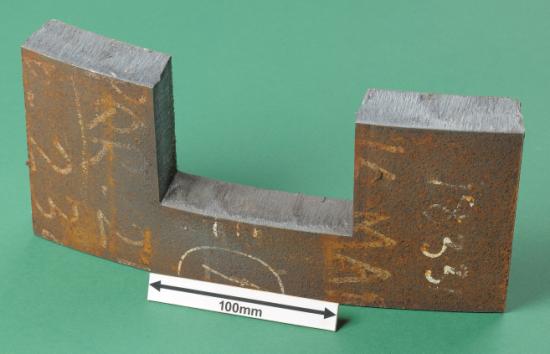

Fig 6. Section from a curved vessel

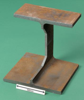

Fig 7. Method to dismantle I beam

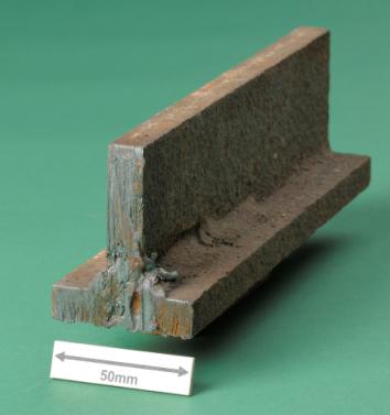

Fig 8. T profile in CMn steel cut in a single pass

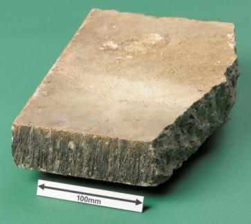

Fig 9. Structural concrete
