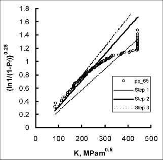

The results from the mml procedure are summarised in Table 1. The fracture toughness distributions predicted from each of the three steps are compared with the experimental data points (all for a reference thickness of 25mm) in Fig.1 to 4. Each step involves a rotation of the fitted curve in an anti-clockwise direction when K o predicted from STEP 1>STEP 2>STEP 3; as illustrated by the results from the parent plate, see Fig.1. However, this sequence does not occur in every case and for the submerged arc weld and HAZ, STEP 2 provides the lowest K o. Indeed, it turns out that for all the materials examined here the mml procedure shows that the K o obtained at STEP 2 characterises each fracture toughness distribution. This is probably because the data sets are relatively large and the distribution is fairly even in the lower tail. With small data sets where scatter is high, the conclusion could be different and STEP 3 is likely to characterise the distribution. STEP 1, the normal mml procedure, does not always provide a good description of the data set as a whole and, in comparison with the other steps, provides an overestimate of K o. This indicates that the Weibull distribution shape parameter of 4 is not optimum. Nevertheless, STEP 2 or STEP 3 does appear to provide a conservative description of the lower tail to the fracture toughness distribution.
Table 1 - K o estimates (reference 25mm thick) from mml procedure
Data setnSTEP 1K o, MPam 0.5STEP 3

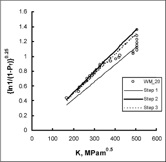

Note: In all cases, K o from STEP 2 characterises the distribution
Fig.1. MML procedure applied to parent plate results at -65°C
Fig.2. MML procedure applied to weld metal results at -20°C

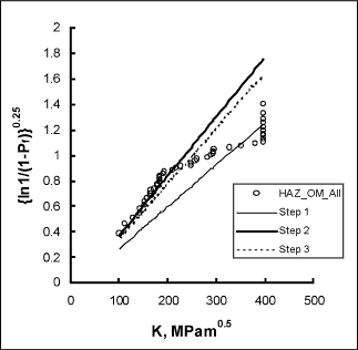

Fig.3. MML procedure applied to all HAZ results from overmatched weld

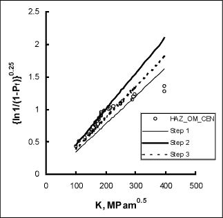

Fig.4. MML procedure applied to censored (by post test metallography) HAZ results from overmatched weld
In Table 1, the effect of censoring the HAZ data by post test metallography to confirm that the HAZ was correctly tested can be noted. When the data set includes all the results from specimens nominally notched into the HAZ (i.e. results from post test metallography are ignored), higher values of K o are estimated for all steps compared with data sets which have been censored by post test metallography. It is clear that for the HAZ, from both the OM and EM welds, censoring provided by the mml procedure alone cannot be relied upon to provide a conservative, lower bound estimate of K o. This is because the data sets are of different sizes and, because high or low fracture results cannot be assumed to actually relate to the HAZ (the results could come from another region, such as parent plate or weld metal). Consequently, it is recommended that the mml procedure should be only applied to HAZ data which have been confirmed by post test metallography to test the HAZ correctly. (Procedures for conducting post test metallography on fracture toughness specimens are described in BS 7448:Part 2:1997).
In the subsequent analyses described here, only the HAZ data sets which have been censored by post test metallography are considered. In these analyses, K o obtained from Table 1 (from STEP 2) is used to derive fracture toughnesses from Eq.[2] so that these can be compared with those predicted from the procedures described in BSI PD6493:1991 and BS 7910:1999.

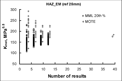

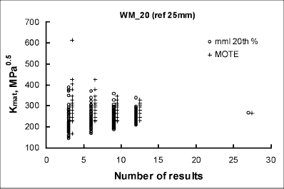

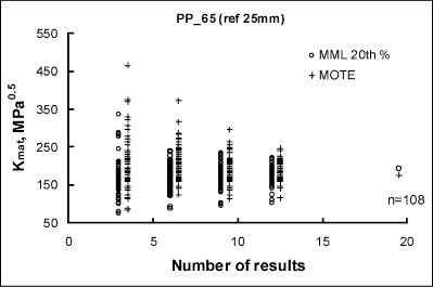

The results from these calculations are presented in Fig.5 to 7 for the parent plate, weld metal and even match HAZ. It should be noted that because the weld metal and even match HAZ data sets are relatively small, the results in Fig.5 and 6 contain a number of repeat K mat values. Also included in the figures are the 20 th percentile K mat predictions from both BS and mml procedures made from the complete data set. For the BS procedure, various statistical distributions were fitted to the censored experimental data using a maximum likelihood method. Results from specimens that did not fracture were censored. However, censoring did not mean the result was ignored. In all cases the 1n-normal distribution was found to provide the best fit, and the fitted parameters together with the 20 th percentile values are given in Table 2.
Fig.5. MML and MOTE procedures for weld metal at -20°C compared for 100 simulations for each sub-set up to 12 results; above 12, 20 th percentile values are shown for both SINTAP and BSI procedures
 Fig.6. MML and MOTE procedures for HAZ even match at -10°C compared for 100 simulations for each sub-set up to 12 results; above 12, 20 th percentile values are shown for both SINTAP and BSI procedures
 Fig.7. MML and MOTE procedures for parent plate at -65°C compared for 100 simulations for each sub-set up to 12 results; above 12, 20 th percentile values are shown for both SINTAP and BSI procedures

Figures 5-7 clearly show that for the simulations, a higher mean fracture toughness is obtained with the MOTE procedure compared with the mml procedure. Scatter is also higher for the MOTE procedure than the mml procedure, especially when the number in the sub-set is 6 or less, but decreases for larger sub-sets. This implies that the mml procedure reduces the risk of overestimating fracture toughness compared with the MOTE procedure, especially for small data sets, e.g. 12 or less. When the data set comprises only three results, both procedures show that a very wide range of fracture toughness estimates is possible. Actual toughness can be significantly overestimated or underestimated, although large overestimates are less likely with the mml procedure. Indeed, these analyses illustrate the problems of attempting to characterise fracture toughness with only three test results.
When the results from the whole data set are compared (for the present purposes, this represents the whole population), the 20 th percentile predictions from both procedures are similar, despite the fact that the mml procedure is based on a 3 parameter Weibull distribution with a shape parameter of 4, and the BS procedure is based on a 'best-fit' ln-normal distribution.
Nevertheless, Figs.5-7 illustrate the particular strength of the mml procedure when dealing with small data sets, in that, in comparison with the MOTE procedure, it reduces the likelihood of overestimating fracture toughness but does not eliminate it. However, the results do illustrate the potential problems of relying on the results from data sets as small as three. The fact that engineering critical assessments (ECAs) employing fracture toughness data obtained from three tests have not proved to be unsafe, as far as is known, must imply that either the assessment procedure contains inherent conservatisms, or that other input data are conservative. It is suspected that in practice, both factors play a rôle. Indeed, this is in keeping with the philosophy adopted in ECAs, which is fracture avoidance rather than prediction of the critical conditions for fracture. Nevertheless, for safety critical components reliance on three test results would appear to be unacceptable, unless high safety factors are included in other input parameters to the flaw assessment.
