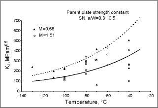

The data were analysed further to establish toughness distributions, and to find the median (50 th percentile), allowing a better comparison of shift in transition temperature. This was done by converting J CMOD to K J values using:
Applying the Master Curve maximum likelihood (mml) procedure [8] which assumes that fracture toughness data follow a Weibull distribution (shape factor 4 and shift parameter 20MPam 0.5 ), the data were replotted in Fig.7. This shows that the 200 MPam 0.5 HAZ transition temperature is approximately 40°C higher in the overmatched weld compared to the undermatched weld.
Fig.7. HAZ K J data with predicted median (P f = 0.5) curves
