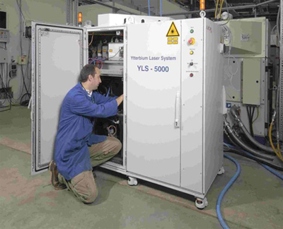

Figure 1 shows a photograph of a 5kW IPG fibre laser. The single cabinet shown contains not only the laser source, but a heat exchanging cooling unit and a four way optical beam switch. The latter can be used to connect more than one fibre and process head to the same laser source.

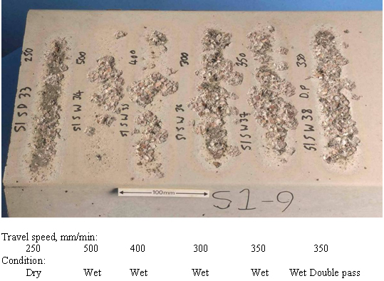

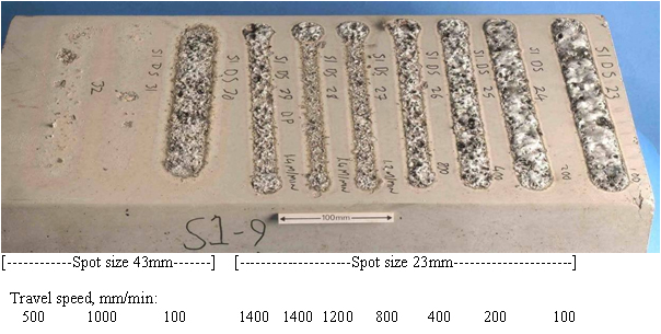

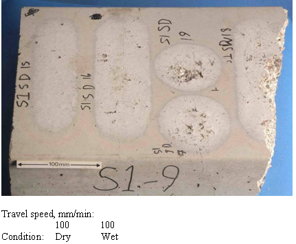

Figure 3 shows the results of a series of affected areas with single passes of the laser beam at two spot sizes of 43 and 23mm at a range of speeds for a dry surface. As can be seen, at the higher power density, all speeds between 100 and 1400mm/min produced different degrees of surface vitrification, with speeds below 200mm/min producing particularly hard surfaces which tend to be a mixture of white and black in colour. At the lower power density very little scabbling occurred for any speed between 100 and 1400mm/min. At the lowest speed a certain amount of vitrification of the surface could be seen, parts of which were very hard. Figure 4 shows a continuation of the work on this concrete at the lower power density to include other speeds and wet surfaces. All the passes at speeds between 350 and 500mm/min were produced with a wet surface to the concrete. One of the two samples shown at the speed of 350mm/min, was a double pass, one on top of the other. In all cases where the surfaces were wet, better performance could be seen. There is a direct comparison at a speed of 500mm/min, between a dry sample (shown in Fig.3.) and the wet sample shown in Fig.4. What appears to be happening, when the surface of this concrete is wet, is that the laser is able to remove the concrete paste at the very surface of the material without breaking apart the large siliceous aggregate underneath. A double pass of the laser beam did not appreciably improve the process. Figure 5 shows the results of applying an even lower power density (from a spot size of 65mm in diameter) on a dry surface. As can be seen, at the two speeds of 50 and 100mm/min shown, the laser beam produced little effect.
Fig.3. Siliceous aggregate. Laser passes at 4000W on a dry surface
Fig.4. Siliceous aggregate. Laser passes at 4000W using a spot size of 43mm diameter
Results - Basalt aggregate

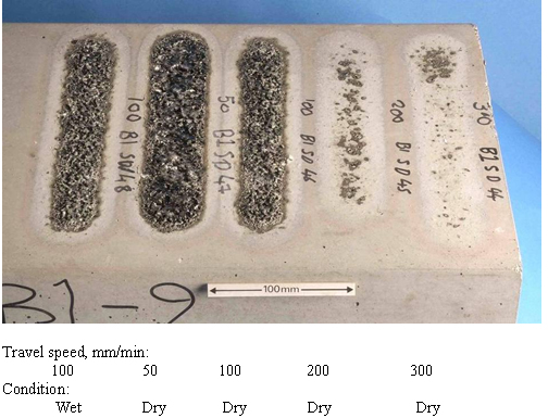

A fractured section of this type of concrete can be seen in Fig.2b. For this concrete the laser power was fixed at 4000W. A laser spot size of 43mm diameter was used, corresponding to a laser power density of 280W/cm2 incident on the concrete surface. Passes were made with the surface of the samples both dry and wet. Figure 6 shows the effects of a series of single passes of the beam over the concrete surface, at speeds from 50 to 300mm/min. For speeds at and below 100mm/min, significant vitrification of the surface was seen producing a very hard black glassy result, so hard in fact that a wire brush could not remove it.
Wetting the surface did not improve the situation, as can be seen if the two passes at 100mm/min are compared. No additional work was performed on this particular type of concrete.
Fig.6. Bassalt aggregate. Laser passes at 4000W using a 43mm diameter spot size

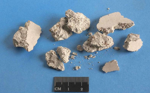

Fig.7. Typical debris from the scabbling process on limestone aggregate concrete

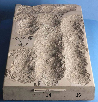

Run 13 - single pass at 100mm/min;
Run 14 - double pass, one on top of the other, both at 100mm/min
Run 13 (single pass) showed a maximum scabbling depth of 11mm and a track width of almost 80mm. At 100mm/min travel speed, approximately 55cm3/min of material is being removed. Run 14 (double pass one on top of the other) showed a maximum scabbling depth of 20mm and a track width of 110mm, larger than for the single pass. Accounting for the double pass at 100mm/min this equates to a material removal rate of 65 cm3/min. Run 11 (double pass side 3/min.
Within this sequence of results the effect of wetting the surface of the concrete before the laser beam pass was investigated. Generally a wet surface improved the width of the scabbled track, (by up to 60%) but did not appreciably increase the scabbling depth. However, the volume of the material removed also increased by about 50%.

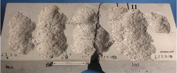

When the scabbling process worked (on concrete containing limestone aggregate) a maximum removal rate of concrete was measured at 65cm3/min, from a double pass. This also produced the deepest scabble at 20mm. A similar removal rate was observed for a side by side pass, at 63cm3/min, but in this case the maximum depth was 15mm. When wet, the process appeared to be improved in terms of width of track and removal rate, but not in terms of the maximum depth of scabble obtained. For concrete containing siliceous aggregate, it was clear that the concrete paste forming the surface of the block could, under some conditions, be removed. However, in most cases this was less than 1mm thick. Removing this surface exposed the large siliceous aggregate, which was for the most part, unaffected by the laser beam, until the power density became so large that melting appeared to set in. There was no evidence of separation of the concrete at the boundaries between the aggregates. When the concrete was wet, there was some evidence of better performance, but this was slight. When using the basalt aggregate no evidence of explosive scabbling, either for wet or dry concrete was found. In addition, when the power density was increased, the resulting melting produced a surface that was too hard to easily remove by wire brushing.

Run 11 - double side by side pass, each at 100mm/min

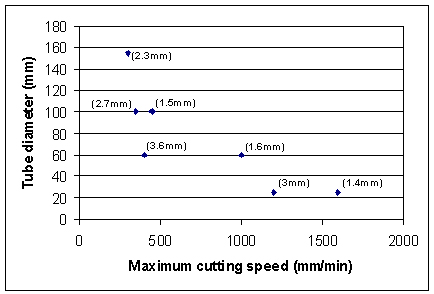

This section is restricted to the results when cutting with the tubes horizontal and the laser beam incident from above the tube. Fig.10 shows a graph of the maximum cutting speed possible for single sided cutting of stainless steel tube diameters from 25 to 155mm. All results are presented using the same cutting lens and the same laser power. In addition the process assist gas used and its pressure in the top of the cutting nozzle were also the same. The numbers inside the graph correspond to the tube wall thickness. This set of results has been chosen to show the range of tube diameters and wall thickness which might be successfully cut varying only the process speed and keeping all other parameters constant.

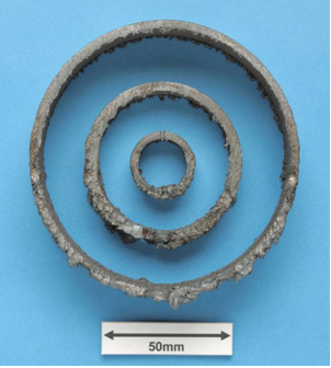

Fig.10. Maximum cutting speed for various tube diameters. The figures in brackets indicate the tube wall thickness
For a given tube diameter it is possible to improve cutting performance shown in Fig.10, by adjusting one or more of the available processing parameters. However, it should also be pointed out that in the trials reported, the range of cutting speed for each tube/wall combination was also established, the only acceptance criteria being separation of the tube. At a cutting speed of 300mm/min, it was in fact, possible to cut all the tubes used in the trials.
Fig.11. Tube edge quality (20-155mm tube)
Fig.12. Tube edge quality (thicker wall)

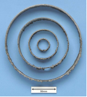

Figure 11 shows the cut edge quality for the four tube diameters used and wall thicknesses from 1.4 to 2.3mm. Figure 12 shows the same for the thicker walled tubes up to 100mm in diameter. What is clear in all cases is, not unexpectedly, that the half of the tube closest to the side of approach of the laser beam is easier to cut than the remaining part. In the instances where a complete separation is not made, the un-cut material is almost always on the far side of the tube.

  1. Using a laser power of 4kW, stainless steel tube of diameter 155mm and wall thickness 2.3mm, has been cut from one side, at a speed of 300mm/min.
  2. Using a laser power of 4KW, stainless steel tube of diameter 25mm and wall thickness 1.4mm, has been cut from one side, at a speed of 1600mm/min.
  3. Using a laser power of 4KW, stainless steel tube of diameter 25mm to 155mm can be cut from one side using a single cutting speed of 300mm/min.
