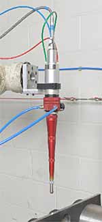

Single-sided laser cutting
Fig.1. The cutting head
Laser cutting of flat plate and tube are very well established manufacturing processes which account for the largest use of high power lasers. The majority of work performed is the cutting of material up to about 20mm thick, with exceptional quality of the resulting edge. In conventional tube cutting, the tube rotates under the laser beam. For single-sided tube cutting, where the tube is fixed in space, alternative approaches are required. The system used in this work is unusual in that its focusing lens had a long focal length of 500mm. The effect of this was to produce a very narrow beam of light, with a large depth of focus. This large depth of focus is a major contribution to the process of single-sided tube cutting. The laser beam was enclosed by a cutting nozzle and a nozzle tip with an exit diameter of about 5mm. In contrast to conventional laser cutting, for tube cutting, the laser beam focus is positioned about 90mm below the tip of the nozzle, allowing tubes up to 170mm in diameter to be cut from one side. The cutting process was also assisted by a jet of air at high pressure, which exited the nozzle concentric with the laser beam. This compressed air was necessary to blow away material in the kerf of the cut, melted by the laser beam and is also particularly important for single-sided cutting, in order to achieve separation of the tube. The cutting head can be seen in Figure 1. This cutting system could also be equipped with a camera, which looks directly through the cutting nozzle, focusing at approximately the same point as the laser beam. This is useful in remotely positioning the cutting head above the tube to be cut. For the work described here, the cutting head was manipulated by an articulated arm robot. All movement of the process head and hence the laser beam, switching of the compressed air and control of the laser, was achieved through the robot controller, located outside of the laser cell.
Using this equipment various options for single-sided tube cutting were possible. Stainless steel tubes from 25 to 170mm in diameter, with a range of wall thicknesses from 1.5 to 11mm, were cut using single pass, two pass and multiple pass techniques. Generally speaking, a two pass technique proved the most efficient for all but the smallest diameter tubes. If the cut edge of a tube is examined, it is clear that the quality of the cut at the side closest to the cutting head is much cleaner than at the opposite side. This is because, on the first pass, most of the energy in the laser beam and the assist gas are used to cut material originally contacted by the beam. Only laser energy and gas which have passed through the upper section of the cut are available to address the lower section and this is cut less effectively. For the second pass, a kerf has been previously opened in the top section and now the majority of the laser energy passes through this and acts more effectively on the lower section of the tube.

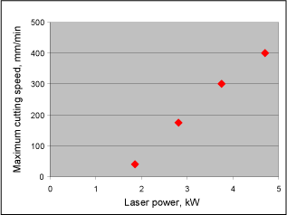

As an example of performance, Figure 2 shows the dependence of the maximum cutting speed at which the tube is severed as a function of laser power. Note that the cutting speed is fairly linear with applied power, at least up to 5kW. The results shown are for a tube of 155mm diameter and 1.5mm wall thickness, for two pass cutting, but similar trends were observed for other diameters and walls. The optimum assist gas pressure appeared to be about 8bar. Figure 3 shows cut sections from 60mm diameter tube, with wall thicknesses from 1.5 to 11mm, again for two pass cutting. Process parameters can be found on the figure caption. In this series of cuts, the only parameter to be varied was the process speed, which was ten times faster on the 1.5mm wall, compared to the 11mm wall. However, it should be noted that all the different wall thicknesses could also be cut at a speed of 100mm/min, thereby affecting cutting of all these tubes without any change at all in the process parameters. The largest tube to be cut in this work had a diameter of 170mm, with a 7mm wall thickness and is shown in Figure 4. This is not believed to be the limit for the laser in use. To go above this diameter, a shorter nozzle assembly would be needed. Using a three pass technique, the tube was severed in a time of 7min, using 4.8kW of laser power. Another possibility demonstrated was the cutting of concentric tubes. For example, a 25mm diameter tube located inside a 60mm diameter tube. In this case a two pass technique was effective in severing both tubes at once.
Fig.2. Cutting speed as a function of laser power for a 155mm diameter tube with a 1.5mm wall. Two pass cutting, assist gas pressure 8bars

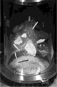

In the laser scabbling process, the laser beam is applied to the surface of the concrete and its energy is absorbed, heating the concrete matrix and the concrete aggregate. Expansion of residual water vapor, probably in both the matrix and aggregate and differential expansion between aggregate and matrix, causes the concrete to break up in a highly energetic fashion, leaving a rough scabbled surface, consisting of matrix and aggregate. Figure 6 shows a still image, taken from a high speed video of the process, showing the energetic nature of the scabbling. In this case the concrete contained limestone aggregate. In the video image, taken through a polycarbonate tube, the laser beam is incident downwards and has a diameter of about 60mm when its hits the concrete surface. From successive images, it was possible to calculate the speed of the concrete particles leaving the surface to be about 18m/sec.
Fig.6. Still image from high speed video of the laser scabbling process
