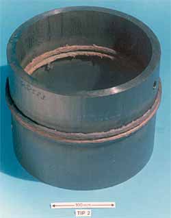

Fig.1 shows a continuous drive rotary friction weld made in a Ti-6Al-4V-0.5Pd pipe, of 246mm diameter and 14mm wall thickness. No shielding gas was used. It is emphasised that the procedures used to make this weld were not necessarily those which might be considered as optimum.
Fig.1. Rotary friction weld in Ti-6Al 4V-0.5Pd pipe

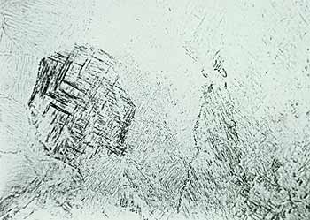

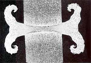

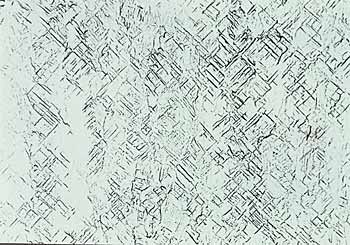

A macro section through the weld is shown in Fig.2. The area of the weld at and close to the bond line is seen to be completely recrystallised, and to consist of fine equiaxed grains showing the typical Widmanstätten transformation products, as shown in Fig.3. There is clear evidence for beta grain growth just outside this area, together with indications of the intense plastic deformation that accompanies this and all other friction welding processes.
Fig.2. Macro section through rotary friction weld in Ti-6Al-4V-0.5Pd pipe
Fig.3. Microstructures in rotary friction weld in Ti-6Al-4V-0.5Pd alloy Fig.3a) weld centre
Fig.3b) HAZ
Fig.3b) HAZ

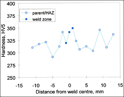

A number of mechanical tests were performed on the welded sample. An initial bend test showed no evidence of failure at the weld, and indeed was bent through over 45 degrees before failure started to occur at a location away from the weld. A number of tensile tests were performed, and the data is given in the attached Table. It is evident from these data that there was no reduction in strength as a result of welding, and in fact all failures occurred away from the weld zone. Thus, the mechanical properties equal or exceed those of the parent material. A hardness traverse ( Fig.4) shows a slight increase at the weld line, and this is consistent with the tensile data.
Fig.4. Hardness traverse across rotary friction weld in Ti-6Al-4V-0.5Pd alloy

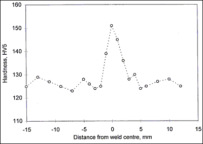

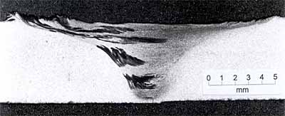

Preliminary data only is available from work on CP titanium. Details of the welding procedure remain proprietary, but a typical macro section is shown in Fig.5. The dark etching areas are regions where the titanium has been heated above the beta transus, and has therefore transformed to a characteristic Widmannstätten microstructure on cooling. The remainder of the weldregion consists of very fine equiaxed alpha grains, with a grain size substantially less than measured in the parent material. The partial transformation in the weld zone gives a good indication of the maximum temperature reached during this process, as the alpha transus would normally occur at about 900°C. Initial hardness tests indicate that there is no loss of mechanical properties across the joint, but tensile data to confirm this are not available. Data are presented in Fig.6.
Fig.5. Macro section across friction stir weld in CP titanium
Fig.6. Hardness traverse across friction stir weld in CP titanium
