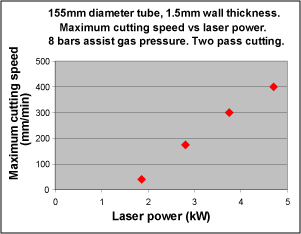

Fig. 2. Cutting speed as a function of laser power

As an example of performance, Figure 3 shows the dependence of the maximum cutting speed at which the tube is severed as a function of laser power, for a tube of 155mm diameter and 1.5mm wall, during two pass cutting. Note that the cutting speed appears to be linear with applied power, at least up to 5kW.
Fig. 3. Cutting speed as a function of laser power
