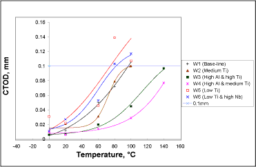

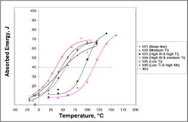

The Charpy and CTOD data, Figures 6 and 7, show a clear difference between welds W3 and W4 on the one hand, which have poor toughness, and the remaining welds on the other hand, which show better toughness. Linear regression analysis was carried out to investigate the possibility of correlation between both the 0.1mm CTOD temperature T 0.1 (°C) and the temperature for an absorbed energy of 40J, T 40J (°C) to the Al, Ti, oxygen, tungsten and Nb contents. The resulting equations are given below:
T 40J = - 21 + 2149 Al + 428 Ti + 1023 Nb
T 0.1 = 42 + 2897Al + 497Ti
Fig.6. Weld metal Charpy data from the weld cap
Fig.7. Cross weld CTOD data
Both equations state that Al has the strongest detrimental effect, with Ti having a smaller effect. Thus, the difference in Al and Ti between the cap and root regions may have contributed to observed differences in toughness between the cap and root Charpy toughness specimens. Niobium up to 0.05% appears not to influence cleavage fracture initiation, although it did feature in the equation for Charpy toughness.
3.4 Examination of selected Charpy and CTOD specimens
Examination of the sectioned specimens in the optical microscope revealed differences between the high and low toughness specimens. In Weld W5, the delta ferrite grains of the solidification structure did not feature predominantly. By contrast, this delta ferrite grain structure was clearly visible in the two lower toughness specimens. Detailed examination revealed small islands of delta ferrite along the original solidification cell boundaries.
All CTOD specimens displayed mixed mode, predominantly cleavage fracture. There were few clear differences between the welds, although the lower toughness of welds W3 and W4 was revealed by the larger number of patches of cleavage fracture that formed during fatigue precracking.

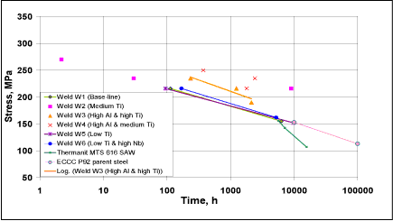

The creep rupture data, for all-weld-metal creep specimens, are presented in Figure 8, together with data from ECCC data sheets [7] for grade 92 parent steel and data for 92 grade Thermanit 616 submerged arc welds. [6,5] Several of the present welds gave actual or extrapolated 10,000h rupture stresses of ~150MPa, which is similar to the creep rupture strength of the 92 grade parent steel. These were weld W1, the two specimens from the cap of weld W2, weld W5 and weld W6. Detailed fractographic examination using an SEM revealed similar microvoid coalescence in all these specimens.
Fig.8. Creep rupture data for all-weld metal test specimens, determined at 600°C. (100h = 4.2 days; 10,000h = 1.1 years). All specimens tested at 216MPa were taken from the weld root; all other specimens were takenfrom the weld cap
Specimens containing a medium amount (~0.06wt%) of Ti, ie root and cap specimens from W4 and the root specimen from W2, show a clear improvement over the rest of the data, with extrapolated 10,000h creep rupture stresses ~30% and ~40%, respectively, higher than the 92 grade steel. Approximate 1,000h and 10,000h creep rupture stresses are summarised in Table 3. The data were interpolated, or extrapolated by extending the lines shown, or assuming the same slope as the 92 grade steel, as appropriate. However, it is recognised that there is a lack of data, especially for W2above 100h, and thus further testing would be beneficial. The next best performing specimens were those taken from weld W3, which contained higher levels of titanium.
A surprising feature of the creep rupture data is the extensive ductility displayed, Table 3, particularly by the two specimens that showed the best creep rupture strengths (W2 root, 8,988h, reduction of area (RA) = 82%, and W4 cap, 2,418h, RA = 70%). They failed by what appeared to be ductile tearing, rather than by creep cavitation on the grain boundaries. The reason for this behaviour has not yet been elucidated, but is presumed to be linked to the presence of a fine distribution of titanium carbo-nitrides, and perhaps to finer-scale alloy carbides on grain boundaries than would be the case in the absence of Ti. Metallographic examination of the longitudinally sectioned creep rupture specimens revealed, as expected, alternate bands of as-deposited and reheated weld microstructure. Detailed examination of the microstructures revealed that precipitation had occurred on the lath boundaries during creep testing, to a similar extent in root and cap specimens. The main difference between root and cap specimens appeared to be the greater density of second phase particles in the former, which were revealed more clearly in the delta ferrite regions. Such a difference is as expected, given the longer test period for the specimen from the root region (9,000h, compared with 2.2h for the specimen from the weld cap).
