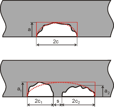

The NDE indication is bound by a containment rectangle, one side of which is typically drawn parallel to the free surface, as shown in Figure 1. The flaw is then idealised as an elliptical flaw, for the case of embedded flaws, or a semi-elliptical flaw for the case of surface-breaking flaws, which is inscribed within the containment rectangle. The ECA is then performed on this flaw. This fundamental step has not changed since BS PD 6493:1980.
Figure 1: Definition of characterised flaw and parameters for flaw interaction

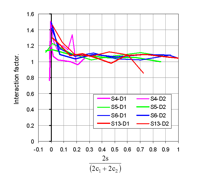

Figure 2 illustrates the amount of conservatism in the PD 6493:1980 version of the flaw interaction criterion. The figure uses the data of Bezensek and Hancock [5, 6] to show the interaction factor as a function of flaw separation. The interaction factor is defined as a ratio of the stress intensity factors for the adjacent to the remote crack tip. Both are derived from the fatigue crack growth data using the Paris law [see reference 5 for details]. The flaw separation is normalised by the average surface length in accordance with PD 6493:1980 criterion. Notable interaction is observed only when the flaw separation, s, is less than 20% of the average flaw surface length. Clearly the criterion of PD 6493: 1980 is conservative.
Figure 2: Interaction factor for two similar flaws in fatigue under bending loading. Adopted from [5] and [6].

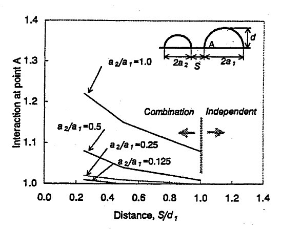

Figure 3: Interaction factor for two dissimilar surface flaws in tension from numerical analysis of Hasegawa et al [7]

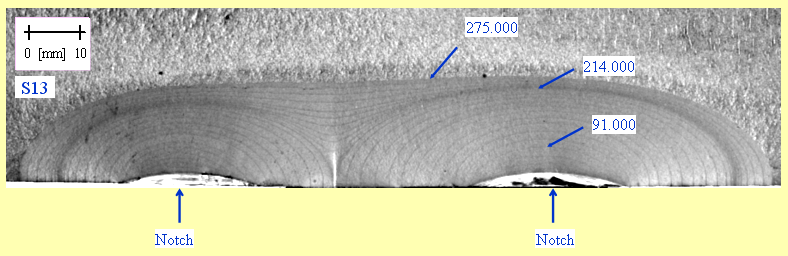

Figure 4: Image of the fatigue crack growth from twin co-planar flaws [5]

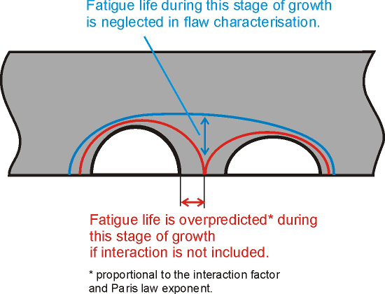

In BS 7910: 1999 the criterion was further relaxed by allowing the adjacent flaws to touch prior to performing flaw characterisation. It may be argued that the overpredicted fatigue life, by not accounting for the interaction in the period of growth up to flaws touching, is compensated by characterising the touching flaws into a bounding flaw. Figure 6 illustrates this idea. This argument could be used in justifying the revision of the flaw interaction criterion to s=0 in 1999.
Figure 6: Illustration of the influence of flaw interaction on the fatigue life if using the s = 0 criterion.
Studies in [5, 6] support the use of s=0 as the flaw interaction criterion in fatigue. There is however an issue with this criterion for assessment of fracture, but especially cleavage, as discussed later.

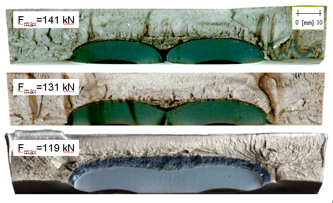

3.4 Flaw interaction in cleavage
Recent studies on flaw characterisation in cleavage by Bezensek & Hancock [11] and Sharples et al [12-14] show that characterisation of co-planar touching flaws may not always be conservative. The issue arises for conditions of limited ductility negating potential benefits of localised plasticity. Both, test data and an analysis using a weakest link fracture based approach indicate that a lower failure load will be attained at a given failure probability for touching flaws compared to a characterised flaw, as shown in Figure 8. This was confirmed by test data although the number of tests was small.
Figure 7: Ductile tearing from co-planar flaws [5]

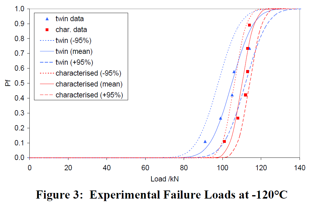

The flaw interaction rules of BS 7910 are sometimes used for other failure mechanisms, such as stress corrosion cracking or creep. There is a lack of data on flaw interaction under these failure mechanisms. The interaction rules developed on the basis of fatigue crack growth are typically used for such cases.
Figure 8: Typical cumulative failure probability for co-planar touching flaws and the corresponding characterised flaw on the lower shelf [14]
