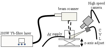

All trials were performed with a redPOWER® Yb-fibre laser (manufactured by SPI lasers), which had a beam parameter product (BPP) of <0.37mm.mrad. The laser source produced a rated maximum output power of 200W ±<0.5%, at an emission wavelength of 1070 ±10nm, which was fibre delivered to a Nutfield Technology XLR8-15-1064 galvanometer driven scan head. A 125mm focal length Jenoptic 03-90FT-125-1064 F-theta lens, protected by a gas-knife, gave a beam width of 38µm diameter, and a working field of ~60mm x 60mm. A linear stage with micrometer adjustment was utilised to adjust the focal plane of the workpiece. Unless stated otherwise, the minimum beam waist was positioned on the top surface of the workpiece. All processing was performed at 200W (requested laser power). WaveRunner, a Windows based software package, was used to control the beam scanner and the delivered power. Processing was performed at atmospheric pressure, either in air or in a chamber supplied with argon (99.998% purity). Argon was fed into the base of the chamber, at four points and through steel, wool to ensure a laminar flow of gas that did not interfere with the process other than to prevent oxidation. The typical experimental set-up is shown in Figure 1.
Figure 1. Typical experimental configuration with argon shielding

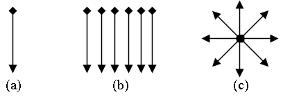

The most basic features that may be created with the Surfi-Sculpt process are those which are produced by repeating a swipe a number of times, in the same position on the workpiece (Figure 2a). The resultant feature is a simple protrusion. Significantly more complex features can be produced by incorporating several swipes into a motif (e.g. Figures 2b and 2c), where the expected protrusion of each swipe is expected to coalesce with the protrusions of other swipes from the same motif. The motif is then repeated a number of times and protrusions are grown simultaneously into a larger feature.

Figure 2. Examples of different swipe configurations investigated
a) single swipe
b) multiple single swipes integrated into a simple motif
c) multiple single swipes integrated into a complex motif

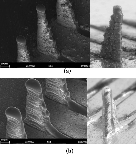

Single protrusions up to 3.2mm in height could be produced with the correct combination of process parameters. Macro images and scanning electron micrographs of typical protrusions, produced with optimised parameters, in Inconel 718 and Ti-6Al-4V are shown in Figure 3.
Figure 3. Typical protrusions produced with a 4mm swipe length, 600mm/s swipe speed, 400 swipe repetitions, at focus, 177ms swipe delay
a) Inconel 718 in air
b) Ti-6Al-4V in argon

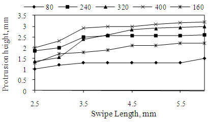

The effect of swipe speed on the resultant protrusion height when processing Inconel 718 in air is shown in Figure 4. Swipe speeds of 400 to 1000mm/s were examined with 160 swipe repeats and a constant swipe delay. In general, higher swipe speeds and longer swipe lengths produced taller protrusions. At swipe speeds above 600mm/s, the protrusions were <1.0mm in height with significant variation noted between identical runs. Relatively small (<0.5mm) protrusions were produced at swipe lengths less than 2.5mm, independent of the swipe speed.
Figure 4. Effect of swipe length and swipe speed on protrusions produced in Inconel 718 in air, with 160 swipe repeats and a constant swipe delay
At the swipe speed producing the highest protrusions, (600mm/s) with a laser power of 200W and a constant swipe delay, protrusions with varying swipe lengths were produced using a different number of swipe repeats. The results, in terms of protrusion height, are detailed in Figure 5. Increasing the number of swipe repeats, and hence the work performed per protrusion, increased the height of the protrusion, although diminishing returns were seen at higher swipe repeat rates. Protrusions up to 3.2mm in height were produced with 400 swipe repeats and a swipe length of 6.0mm, compared to protrusions of height 1.5mm, when only 80 swipe repeats were used for a 6.0mm swipe length. As was observed when assessing the effect of swipe speed on protrusion height, longer swipe lengths produced higher protrusions, although the increase in protrusion height was relatively small at swipe lengths above 3.5mm.

The Rayleigh length and depth of focus (defined here as a length over which the focused beam laser diameter increases by 5%) of the focused laser beam used here are approximately ±0.95 and ±0.61mm respectively. When operating within the depth of focus of the laser beam, up to 1.0mm difference in protrusion height is observed. Protrusions are still produced when operating outside the depth of focus, although their height and reproducibility decreases significantly when working at relatively large distances (i.e. 2.5mm) away from the focal plane.

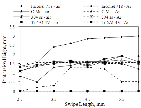

Swipe conditions giving the largest build rate in Inconel 718 in air were transferred to Ti-6Al-4V, C-Mn steel and 304 stainless steel. The conditions were both in air and in an argon environment. The effect on the height of the protrusions is detailed in Figure 6. Protrusions produced in argon in all of the materials were free of oxidation. The protrusions produced in Ti-6Al-4V, C-Mn steel and 304 stainless steel in an argon environment are all of a similar height, independent of swipe length. It is evident that the argon environment aids the build process in Ti-6Al-4V. However, the argon atmosphere hinders the build process when producing protrusions in Inconel 718 when compared to air. Protrusions 3mm in height were produced in air compared to features up to 1.3mm in height in argon.
Figure 6. Protrusion height variation for 600mm/s linear swipes of lengths 2.5 to 6mm with 400 swipe repeats, performed in Inconel 718, Ti-6Al-4V, 304 stainless steel and C-Mn steel in air and Ar environments

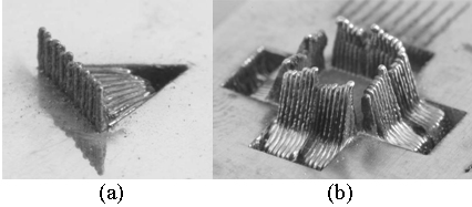

Complex features
The interaction of single protrusions, using parameters developed in the previous section, with other single protrusions was examined here. Linear wall features, such as those detailed in Figure 7, could be produced by reducing the separation between different swipes in the motif. As can be observed in Figure 7, a wall feature can also be produced using a triangular arrangement of swipes. Such a feature allows easy tessellation into numerous arrays of surface features. Although not reported here in detail, management of the heat input between successive swipes was critical in optimising the build rate. The heat input can be efficiently managed by altering the order each swipe is performed in the motif and the swipe delay.
Figure 7. Large wall features produced using several wall features joined in
a) Inconel 718 in air, and

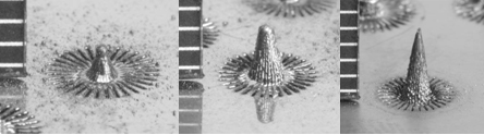

Numerous experimental trials were also performed with the swipes arranged in a circular motif, with the feature intended to grow at the centre of the circle. Initially, eight swipes per feature were used (as shown in Figure 2c) and the swipe delay, swipe speed and swipe length, were all varied according to the values stated in Table 1. Further experimental trials were performed with an increasing number of swipes in the motif (up to 64 swipes) and with very large numbers of swipe repeats (up to 300). Figure 8 details typical conical Surfi-Sculpt features produced.
 Figure 8. Typical conical shaped features produced in a) and b) Inconel 718, and c) Tt-6Al-4V. Scales in mm

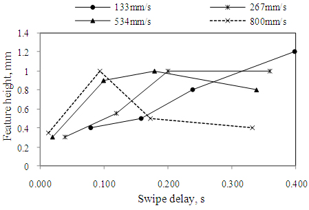

Figure 9 shows the effects of swipe delay (1.5 to 400ms) and swipe speed (133, 267, 534 and 800mm/s) on the height of the resulting feature produced in grade 304 stainless steel with eight 1.5mm swipes in the motif. It should be recalled that the swipe delay refers to the time elapsed between a laser beam finishing a swipe and the beam revisiting that same swipe. However, as all the swipes begin at the centre of the motif, the laser beam will revisit this point on a much more frequent basis.
Figure 9. Effect of swipe speed and swipe delay on the feature height for motifs containing eight 1.5mm swipes, produced in grade 304 stainless steel
It can be seen from Figure 9 that for each swipe speed there is an optimum swipe delay with regards to the height of the feature. A similar trend was observed in features produced with swipe lengths of 2.5 and 3.5mm. In general, a higher swipe speed necessitated a shorter swipe delay in order to maximise the feature height. Little difference was observed between the maximum feature heights achieved with the different swipe speeds, despite the difference in energy input to the workpiece. With nominally identical parameters, features up to 60% taller could be produced when utilising a 2.5mm swipe length, compared with a 1.5mm length. However, the same increase was not observed when increasing the swipe length to 3.5mm and there was no advantage, in terms of feature height, for using this swipe length compared with the 2.5mm length, for the parameters examined here.

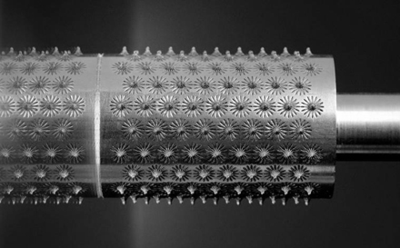

Figure 10 details a typical array of Surfi-Sculpt features produced on grade 316 stainless steel round bar, 32.0mm in diameter. A total of 170 nominally identical features were produced on the bar - which could be utilised for composite to metal joining, crushing of foodstuffs, or piercing thin films.
Figure 10. An array of 170 nominally identical Surfi-Sculpt features produced on 316 stainless steel bar
Currently the production of large arrays of surface features is not possible at high laser utilisation rates, since delays are built in to the program to optimise feature height. Ideally during this time the laser beam would be processing at another position on the workpiece and would return after the required delay. This is not easily achievable with the scan head software used since it was designed for laser marking applications. As a result, the process times observed have been undesirably long. Nevertheless, the optimised processing time (laser beam off time minimised) for producing the features shown in Figure 32 is estimated to be 4s per feature. The build time for the 170

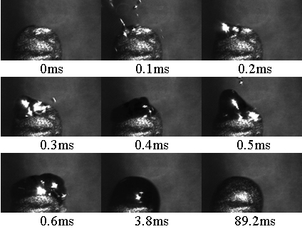

In selected cases, the process was observed with a high speed camera at sampling frequencies of 2-10kHz. Temporal and spatial filtering ensured the attenuation of the high intensity broadband process emissions. A fibre delivered copper vapour laser (primary wavelength of 510.6nm), manufactured by Oxford Lasers, of 20W average power and pulse duration ~20ns, provided illumination of the subject matter.
Figure 11. High magnification pictures of the tip of a single protrusion produced during the laser Surfi-Sculpt process
Figure 11 details a sequence of high speed pictures, taken at a frame rate of 10kHz during the production of a single protrusion in Inconel 718. The beam interacts with the protrusion between 0 and 0.1ms and the applied power density is capable of a creating a keyhole almost immediately. This is evidenced by the spatter ejected from the process in the frame at 0.1ms. The vapour cavity then progresses along the swipe causing a particularly unstable globule of
