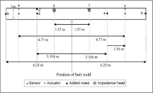

The model tank was designed and built at TWI. It was a 4m diameter tank with a bottom plate comprising two 6mm thick semi-circular plates of steel. The plates were butt-welded together and a 1 metre high shell consisting of three sections was fillet welded to the bottom plate. The three sections were themselves butt-welded together. The bottom plate was trimmed to leave a rim of 100mm. The tank was mounted on sand to represent the foundation material.
In this experiment added mass rather than metal loss represented structural change due to corrosion. Loss of section due to corrosion primarily reduces the local mass and stiffness causing changes in the FRF. An equivalent increase in mass is expected to cause local stiffness increase and comparable changes in the FRF. This approach is also more convenient as it is reversible. There were 2 attached masses and these are illustrated in Fig.2(a) and Fig.2(b). One was a 1kg circular steel disc of 2.5 mm (half wall) thickness and 26 cm diameter. This was attached to the wall with Araldite rapid adhesive. The other was a 0.89kg steel block attached with a G-clamp.

The tank wall was excited with the 'active-tendon' configuration. Each end of the actuator is connected to an adapter that interfaces it with a Dyneema cable (made by Eurocord BV). This material was chosen because it was lightweight and therefore the effects of self-weight would be negligible. The cable is attached to the tank wall with a clamp and a light tension (~100N) was applied. Fig.2(c) shows the actuator suspended in the centre of the tank and Fig.2(d) shows the actuator's wall mounting. The two positions of the impedance heads allowed verification that the force produced by the actuator was undistorted by the cable. Fig.2(e) illustrates the different testing configurations and tank states. In this figure 'W' indicates a wall mounting and the numbers indicate transducer locations. 'Active tendon' was used for excitation of the tank wall. In 'active tendon' there were two possible locations of the cable. In AT1 the cable was connected to location 1, whereas in AT2 it was connected to location 2. Both locations were across diameters of the tank and were at right angles to the each other. The results for AT1 are omitted for brevity, they were generally similar to AT2.

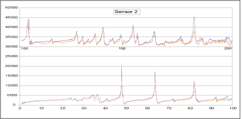

Experiments 1 and 5 were repeat scans at 0.1Hz step size of the tank wall with no modification. Examples of the FRFs for sensors 2 and 4 are overlaid in Fig.3(a) and Fig.4(a) respectively. Note that in these figures the 100Hz to 200Hz range is stacked above the 1Hz to 100Hz range with an arbitrary offset. The repeat scans were taken two weeks apart yet all the scans indicated good qualitative agreement. There did not appear to be any difference in repeatability between the upper and lower frequency ranges. The closest agreement appears to be in the frequencies of the modal peaks. The amplitudes of the peaks are noticeably more variable, although not excessively so. An exception to this is the prominent that mode appears at 97Hz in the FRF of sensor 2 for one experiment but not the other. This is discussed below in relation to results from the 1Hz-resolution scans.

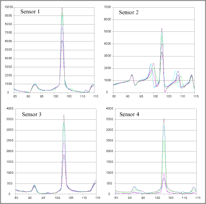

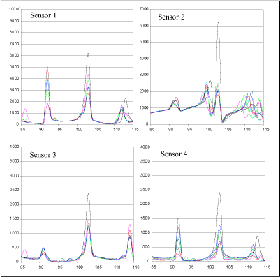

At 1Hz resolution the scans appear smoother than the scans at 0.1Hz but no important information is lost (see Fig.5). This means that future applications of PD technology to tanks could be completed 10 times faster (e.g. 200Hz range could be scanned in 6 minutes instead of 1 hour). Fig.5(a) shows the low resolution scans of the unmodified tank. These show good agreement with the scans taken at 0.1Hz resolution 120 days earlier. The repeatability, illustrated by the proximity of the overlaid scans, is good for these scans which were all taken on the same day. However, the repeatability is noticeably poorer for two modes either side of a prominent mode at 103Hz at sensor 2. These modes exhibit frequency variability that is practically absent in other modes. One of the modes corresponds with the mode that appeared on only one of the repeat scans taken at 0.1Hz resolution (see Fig.3, 97Hz). The different repeatability of these modes suggest that they may be physically different to the other modes. However, further experimentation is required to establish with certainty the nature of these modes. The significance of the observed repeatability will depend on how it compares with the sensitivity of the method to added masses. This is the subject of the next section.
Fig.5. Tank wall FRF taken by stepped frequency scan (1Hz step size) a) Unmodified tank
b) Tank 0.86kG steel block attached to wall

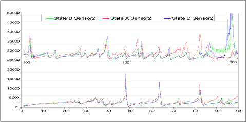

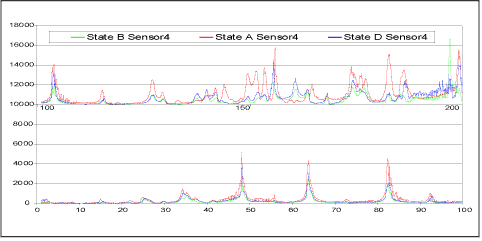

Experiment 2, experiment 3 and experiment 4 were scans of the tank wall with modification 'W(a)', 'W(b)' and 'W(d)' respectively. Examples of the FRFs for these experiments are overlaid in Fig.3(b) (sensor 2) and Fig.4(b) (sensor 4) respectively. Note that in these figures the 100Hz to 200Hz range is again stacked above the 1Hz to 100Hz range with an arbitrary offset. Note also that all three scans were taken over a period of one week. The first point to comment on is that, below 100Hz, there is very little difference between the scans for the modified and unmodified tank (with the single exception of the 90Hz mode at sensor 2 when the tank had modification W(a)). In other words there is generally no sensitivity to structural change below 100Hz. However, between 100Hz and 200Hz there is clearly more difference between the modified and unmodified states, i.e. the higher frequency range has better sensitivity to structural change. The most important differences are discussed below.
Between 196Hz and 200Hz there were dramatic indications on the spectra of the tank modified with 'W(b)' and 'W(d)' on all sensors but particularly sensor 2. A prominent growth in modal amplitude, and a slight frequency shift, occurred at sensor 2 (wall states W(b) and W(d)). Similar indications appeared on the spectra of sensor 1 and sensor 3 (not shown for brevity). Sensor 4 showed slight sensitivity to modification B in this region of the spectrum. In some cases, most notably sensor 2, the change in amplitude is very pronounced. The modal amplitudes for sensor 2 in this region of the spectrum are 12 times higher for states W(b) and W(d) than for the unmodified state.
Inspection of the 100Hz to 200Hz frequency band reveals that, while the spectra of the tank wall in states W(b) and W(d) are similar to each other, that of state W(a) differs noticeably from both of them. In fact the spectrum of W(a) is very similar to that of the unmodified tank, suggesting that there was less sensitivity to this modification than for states W(b) and W(d). There is no obvious explanation for this since all modifications are in the same position relative to the actuator cable attachment points (see Fig.2(e)). However state W(a) does show some notable indications. For example, between the modes at approximately 83Hz and 103Hz on sensor 2 there is a subtle difference between the spectra of the unmodified tank and the tank with the modification 'W(a)' (see Fig.3). Apparently a pair of modal peaks detected on sensor 2 at approximately 90 Hz on the modified tank have slightly shifted frequency and widened (the second of these peaks is interrupted at the break between the two frequency ranges). Indications also appear at about 110Hz in the sensor 2 spectrum of the tank with modifications 'W(b)' and 'W(d)' (see Fig.3). Despite being less dramatic than the modal amplitude increases between 196Hz and 200Hz, these spectral shifts are, nonetheless, consistent in that all of the tank modifications produced a change in this region of the FRF.
The lower resolution (1Hz) scans between 85Hz and 115Hz were conducted to confirm this sensitivity to structural change (using a smaller 0.89kg attached mass) in this region of the spectrum. These scans cannot be directly compared with the 0.1Hz scans because the location and method of attachment of the mass was different. However, the weight and location were similar in magnitude and therefore the damage sensitivity observed with the larger mass would be expected to be comparable with that obtained with the smaller mass. Fig.5(b) shows that the FRFs of sensor 1, sensor 3 and sensor 4 are most prominently changed by the presence of the added mass. The most obvious changes are in the modal amplitudes, which appeared to be related to the torque applied to the clamp attaching the mass to the tank wall. The greater the applied torque, the greater were the modal amplitudes. The effect on sensor 2 was much less prominent. This may have been influenced by its close proximity to the actuator attachment point suggesting that damage sensitivity is reduced as the sensor is brought closer to the actuator attachment point. A less obvious but equally important feature is the slight reduction in the frequency of the mode at 115Hz. Sensor 3 on Fig.5 shows this mode is downshifted by about 1Hz by the added mass. Although only a small shift it nevertheless has significance because of the good frequency repeatability observed at this mode. A similar frequency shift occurs on sensor 1 at the 115Hz mode and at the 93Hz mode, both of which are downshifted by approximately 1 Hz. In fact it does appear that other modes are downshifted slightly, although some by less than 1Hz. Finally, the 1Hz scans revealed two spectral peaks that occur at 86Hz on sensor 1 and sensor 3 of the modified tank. These were observed on only one of the eight repeat scans. This peak might therefore be considered anomalous.
