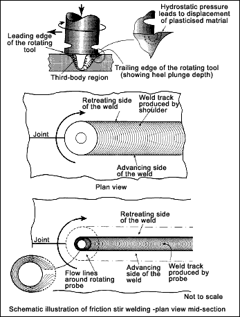

Fig.1. Schematic illustration of friction stir welding
According to the invention the method comprises a FSW tool of harder material than the workpiece material being welded. The marked difference between the elevated temperature properties of the tool and the workpiece, together with a suitable cyclic movement between the tool and the workpiece, generates sufficient frictional heat to cause plasticised (third-body) conditions in the workpiece material. Thus friction stir welding is a continuous hot shear process that involves slowly plunging a portion of a specially shaped rotating tool between and then along the abutting faces of the joint. The contacting surface of the shoulder of the tool, and the length of the probe below the shoulder essentially allows the probe to maintain penetration to the required through-thickness depth.
Although initially FSW was confined to relatively soft workpiece materials such as lead, zinc, magnesium and a range of aluminum alloy materials, the feasibility of joining copper and in this paper, low carbon chromium steel, and carbon steel has been demonstrated. This range of harder workpiece materials has proved possible by continuing to maintain a suitable differential between the hardness and the elevated temperature properties of the tool compared with the workpiece materials.
Friction stir welding can be regarded as an autogenous keyhole joining technique without the creation of liquid metal. The consolidated weld material is thus free of typical fusion welding defects. No consumable filler material or profiled edge preparation is normally necessary. Already FSW is a practical technique for welding aluminium-based materials, ranging in plate thickness from 0.8mm to 75mm and is in commercial production. Low distortion, cost effective, FSW joints are produced, with excellent mechanical properties being achieved in several aluminium alloys.

In friction joining and forming, the process is akin to a fluid layer of high viscosity between solid components in relative motion and under significant compressive loading. The thixotropic properties and fluid flow features that occur in conventional friction welding have been reported (along with friction induced 'third body' conditions and superplasticity that occurs as a result of extreme plastic deformation). Thus the science of these processes, in some respects, is probably closely allied to that of rheology. [17,18,19&20]
The relative motion between the tool and the substrate generates sufficient frictional heat to reduce the yield strength of the material. As the temperature rises the yield strength falls below the applied shear stress so that a 'third-body' region of highly deformed plasticised material forms around the immersed and contacting regions of the tool as illustrated in Fig.1.
The outer edges of the weld track only experience limited friction from the periphery of the tool shoulder. In contrast, and depending on the degree of tool tilt, most of the shoulder acts upon the central region of the weld track. Inevitably, it is the central region that receives most friction as well as the stirring due to the probe.
This highly plasticised 'third-body' material provides some hydrostatic effect. As the rotating tool moves along the joint, this hydrostatic effect helps the plasticised weld material to flow around the tool. The plasticised weld material then coalesces behind the tool, to form a solid phase joint as the tool moves away. Evidence that hydrostatic pressure leads to displacement of plasticised material and recovery of the through-thickness dimension is also shown in the dissimilar metal weld sections. Figs.9 & 10 show that even where the trailing edge (heel part of the shoulder) is sunk below the plate surface during the operation, recovery in plate thickness is possible. In the case of dissimilar materials, preferential recovery occurs with the more plasticised material, especially when positioned on the retreating side of the weld. The presence of a shallow bulge above the plate surface, as shown in Fig.8, confirms this effect.
Both friction stir welding and friction surfacing processes show some lack of symmetry. The use of optimised conditions however, virtually ensures that differences between the advancing side and retreating side do not cause any adverse effects. However, with less suitable conditions, the asymmetric nature of the process can lead to defects. In friction surfacing lack of symmetry can lead to excess expulsion of material at the retreating edge of the deposit, as shown in Fig.17. In FSW, defects can be found such as buried voids, or a surface-breaking groove that usually runs along the advancing side. The inherent lack of process symmetry causes a differential pressure around the probe such that the rotating tool tries to veer away from the retreating side of the weld towards the advancing side. Secure fixturing and robust machine tool equipment prevents any noticeable sideways deflection. [21]
