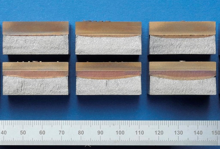

Table 1 Assessment of notch and precrack shapes based on curvature defined from [5]
Specimen
Notch a0 (mm) Crack curvature a0/W
W01-01 to 12 EDM 6.8 0% 0.40
W01-13 Fatigue 7.044 7.3% 0.41
W01-14 Fatigue 7.692 16.7% 0.45
W01-15 Fatigue 7.327 10.6% 0.43
W01-16 Fatigue 7.449 13.0% 0.44
W01-17 Fatigue 7.260 10.2% 0.43
W01-18 Fatigue 7.371 12.8% 0.43
W01-19 Fatigue 7.499 11.7% 0.44
W01-20 Fatigue 7.152 14.3% 0.42
W01-21 Fatigue 7.316 12.4% 0.43
W01-22 Fatigue 7.223 14.6% 0.42
W01-23 Fatigue 7.618 11.5% 0.45
W01-24 Fatigue 7.428 11.8% 0.44
Figure 5. A selection of the fracture faces from SENT specimens tested for the multiple specimen R-curves, notched with EDM alone (top) and with fatigue precracking (below). All specimens had nominal a/W ratio of 0.4.

5.1 Notch Shape & Validity
One benefit of notching solely with EDM is that the notch front is perfectly straight, and there are no concerns about irregular notch shapes which can be an issue when fatigue precracking weld or HAZ specimens. The fatigue precracked specimens tested in this work had precrack shapes assessed according to BS 7448 Part 4 [7], as the maximum difference between any one of the nine crack front measurement and the average crack length, and had curvatures from 7% and 17% (Table 1). These are within the tolerances justified from recent TWI research [8], which recommended that less than 20% curvature to this criterion means that specimens are valid. The variation in the fatigue pre-crack shapes can be seen in Figure 5, against the perfectly straight EDM notched specimens for the R-curve, which then show the stable tearing during the test very clearly. However, none of the fatigue precrack shapes in the SENT specimens tested in this work was invalid, suggesting that using EDM as a way to ensure acceptable notch shapes was not necessary for these surface notched weld metal specimens.
