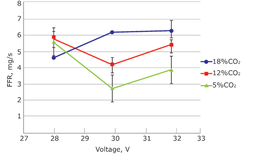

With a shielding gas of argon 18%CO2 at a wire feed speed of 8 and 9m/min a minimum FFR occurred for a metal transfer mode in which a droplet was formed on the end of the wire, of about one wire diameter. With this welding condition (8m/min 32V), which produced a FFR of 4.2 mg/s, the droplet was stable and detached in free flight transfer. For the same wire feed speed of 8m/min at lower voltages, a larger droplet formed. At 28V, the arc length was short and the droplet was observed to touch the weld pool resulting in spikes in the voltage waveform An increase in voltage to 30V produced an open arc condition, but a large droplet formed on the wire tip, producing a FFR of 5.7mg/s. At a wire feed speed of 9m/min FFR increased with a maximum of 6.3mg/s at 28V. At this condition, a large droplet formed on the wire, regularly dipping into the weld pool. At higher voltages, FFRs were slightly lower. Overall, compared to the results for a shielding gas of argon 12%CO2, the FFRs for argon 18%CO2 were higher as shown in Figure 6.
Figure 6. Mean fume formation rate (FFR) for different shielding gases
Trials were also carried out for a shielding gas of argon 5%CO2 at 9m/min. At 28V the short arc length and dip transfer condition, resulted in a FFR of 5.7mg/s, but at higher voltages the FFR was significantly reduced (2.7mg/s at 30V and 3.9mg/s at 32V).
Figure 7. Streaming metal in argon 5%CO2 at 9m/min and 32V
These FFRs are some of the lowest measured. Analysis of the high speed videos shows a streaming metal transfer, Figure 7. Due to the pinch effect (Lorenz force), the metal is transferred in a narrow thread like stream of molten metal. Although the arc length is long, the surface area of molten metal emitting vapour is small, which may account for the low FFR. These results are compared to the other shielding gases in Figure 8.
igure 8. Mean FFR at a wire feed speed of 9m/min for different shielding gases
Figure 8. Mean FFR at a wire feed speed of 9m/min for different shielding gases
