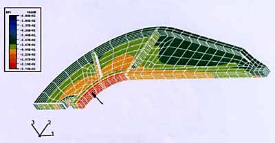

An example of the analysis is shown in Fig.3 for a stiffener and flange width of 60mm, and a web thickness of 8mm. Maximum stresses were 215N/mm 2 at the inside flange radius and 185N/mm 2 on the outside surface of the frame at the end of the stiffeners. In order to provide infinite pulsating fatigue performance of the steel C-frame the material strength can be estimated from standard data. A lower bound estimate of fatigue strength was 52% of the tensile strength in this case. Thus material strength needed to exceed 413N/mm. 2
Fig. 3. Steel C-frame, maximum principal stress contours, N/mm 2
The case of loading with a 1° misalignment of the frame caused offset stresses in the flanges and a peak operating stress of 374N/mm 2 was estimated. This required a material strength of 720N/mm 2 to provide infinite fatigue performance under such conditions.
