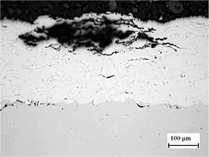

The nature of corrosion attack of the nickel alloy coating during the electrochemical test is being examined. In one test a coating prepared in a similar manner to the coating labelled DJ37 was held at +300 mV SCE for 20 hours to increase the extent of any corrosion attack. The surface of the coating after the 20-hour hold is shown in Figure 11. The surface exhibited a large number of small isolated spots of corrosion. A cross section through one of these corrosion features is shown in Figure 12. This photomicrograph illustrates corrosion of the coating, which appears to have occurred along the inter-particle boundaries. It is also noticeable that there is no visual corrosion of the underlying carbon steel substrate. It is possible that the use of appropriate sealants may reduce corrosion attack of the coatings. This could occur if the sealant is able to reduce access at the coating surface to any open porosity or inter-particle boundaries. However, it is unlikely with such low porosity coatings that the sealant would penetrate into the coating. Further work is underway looking at the use of sealants.
Fig. 11. Surface of nickel alloy 625 coating after exposure to test solution at +300 mV SCE for 20 hours. Bar shown is in mm
Fig. 12. Cross section through coating after exposure to test solution for 20 hours to illustrate corrosion along inter-particle boundaries

  3. The lower level of corrosion resistance of the nickel alloy coating compared to wrought material appears to be related to preferential attack along the inter-particle (splat) boundaries
