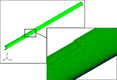

The finite element mesh
A symmetric half model of a 3" schedule 40 pipe was used in all of the models described in this paper. The mesh containing a 'long' defect is shown in Fig.1. The defect was modelled as 'long' in many cases so that reflections from the far wall of the defect did not interfere with reflections from the near wall of the defect. Four elements through the thickness were used. The axial length of the elements was uniform throughout the model and was taken to be a tenth of the smallest possible wavelength in the region of interest on the dispersion curve. The axial length of the elements was chosen such that there were at least 10 elements per minimum wavelength. The circumferential length of elements was chosen so that there were at least 16 elements per maximum cyclic variation around the circumference. For example, for a frequency of80kHz, the bandwidth of a 10-cycle pulse is 64-96kHz and the highest order of flexural mode in this frequency range is F(11,1). Therefore, 176 elements round the circumference were used in this example.
Fig. 1. Finite element mesh of 3" Schedule 40 steel pipe with 'long' defect
The length of all of the models used was such that the length of the incident pulse could fit into the model before hitting the first wall of the defect. The length of the model after the defect was such that the pulse transmitted through the defect would not interfere with any reflections from the defect.

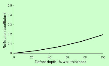

Effect of defect depth
In order to study the effect of defect depth on the reflection coefficient, a mesh was created with a 'long' defect. The defect was assumed to be a rectangular notch and depths of 0, 25, 50, 75 and 100% of the wall thickness were examined. The defect had a circumferential extent equal to the radius of the pipe (~15.9% of the circumference).
The relationship between the reflection coefficient and defect depth was found to follow a shallow parabolic curve, see Fig.2.

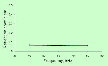

Effect of frequency
Frequencies of 40, 50, 60, 70 and 80kHz were studied for a 50% wall thickness defect. As in the defect depth study the defect was a 'long' rectangular notch. The reflection coefficient was found to have little variation with frequency for this particular case, see Fig.3.
Fig. 3. Variation of reflection coefficient with frequency of excitation in steel pipe

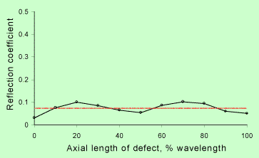

Effect of axial extent
The defect was changed from a 'long' defect as in the previous two studies to have a finite length. The defect lengths were specified in terms of the wavelength of L(0,2). Defects of 0, 10, 20, 30, 40, 50, 60, 70, 80, 90 and 100% ofthe wavelength of L(0,2) were studied. As before the defect was notch like and had a circumferential extent equal to the radius of the pipe.
The reflection coefficient was found to vary cyclically with increasing axial extent. Minima were predicted for defects of 0, 50 and 100% of the wavelength of the incident mode and maxima were predicted for defects of around 25 and75% of the wavelength of the incident mode. This cyclic behavior agrees with the theoretical interaction between the reflections of the wave mode from the front and back walls of the defect. Fig.4 shows the variation of the reflection coefficient with axial extent of the defect.
Fig. 4. Variation of reflection coefficient with axial extent of defect in steel pipe

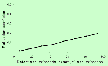

Effect of circumferential extent
For this study the defect was assumed to be crack like (i.e. zero axial length). The defect was specified in terms of the percentage of circumference of the pipe. Defects of 6.25, 12.5, 15.9, 18.75, 25, 31.25, 43.75, 56.25, 68.75,81.25 and 93.75% the circumference were studied.
The variation of the reflection coefficient with circumferential extent of the defect was found to be linear. The reflection coefficient increased with increasing circumferential extent of the defect, see Fig.5.
Fig. 5. Variation of reflection coefficient with circumferential extent in 3" Schedule 40 steel pipe

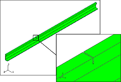

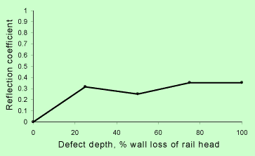

The dispersion curve work in the previous paper [1] led to a discussion of the use of modes that travel purely in the head of the rail to detect defects in the head of the rail. An initial study has been carried out on the effect of defect depth on the reflection coefficient for a mode that travels purely in the head of the rail at ~50kHz. The outline of the model is shown in Fig.6.
Fig. 6. Model of BS113A type rail containing defect with depth equal to 50% of the head of the rail
The reflection coefficient was found to have an unexpected trend with the defect depth, see Fig.7. The FFT (Fast Fourier Transform) of the reflection revealed that there were a lot of mode conversions when the incident mode hit the defect.
Fig. 7. Variation of reflection coefficient with defect depth in head of rail

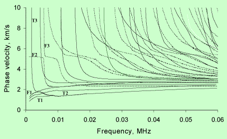

The rail dispersion curve
Fig.8 shows the rail dispersion curves over the frequency range of 0-60kHz for a BS113A type rail. The three-dimensional natural frequency analysis method [1] was used to obtain the points for these curves and the lines were linked using an algorithm written at TWI.
Fig. 8. Rail dispersion curves up to 60kHz (dotted lines represent flexural modes and continuous lines represent torsional modes)
In order to link the points to form lines a large number of points are required especially as there are a lot of different modes in a rail at high frequencies. A two-dimensional approximation has been proposed by Wilcox et al. [7] for commercial FE codes. In ABAQUS [8] this approximation can be achieved by using axisymmetric elements that allow asymmetric deformation. In order to calculate a large number of modes using this method, a large number of Fourier variations around the circumference of the model are required. In ABAQUS the number of variations round the circumference is limited to four, as the method becomes cumbersome for more Fourier modes around the circumference. [8] In order to avoid this limitation the dispersion curves presented in this paper were calculated using the three-dimensional method proposed in Ref. [1] This also avoids any errors associated with the curved geometry inherent in the two-dimensional method.
The authors have noticed that in a recent patent application in which a rail dispersion curve was published, [6] the points have been linked incorrectly at around 5kHz. The lines interestingly get close at around 5kHz but do not cross one another. In the patent application the two lines are presented as crossing one another. The relationship between the two lines can be confirmed by comparing the displaced shapes of the modes for the two lines. The modes have similar displacement characteristics at this frequency; they are both symmetrical vibrations in thewhole body of the rail. However, the phase relationship between the vibrations in the head and the foot are different. For the F2 mode (see Fig.8) the vibrations of the head are out of phase with the vibrations in the foot, whereas, for the F3 mode the vibrations in the head are in phase with the vibrations in the foot of the rail. Furthermore the connectivity ofthe dispersion curves presented in Fig.8 above are in agreement with the curves presented by Gavric. [5]
It is clearly important to link the points correctly. In Ref. [6] the F2 mode has been incorrectly presented as non-dispersive around 5kHz when it is actually highly dispersive at this frequency. This would result in confusing results from field tests in which this mode were used and the predicted group velocity of the modes would have been wrong, resulting in incorrect positioning of the defect.
A deeper examination of the rail dispersion curves has revealed that there are no modes that travel purely in the head of the rail below 20kHz. At low frequencies (i.e. below ~5kHz) wave modes tend to travel in the whole body of the rail. At frequencies above 5kHz the vibrations migrate to one area of the rail for many of the wave modes. For example, the F3 mode (see Fig.8) is predominately a vertical flexing of the whole body of the rail below 25kHz, but migrates to a flexing of the head of the rail alone above 25kHz.
