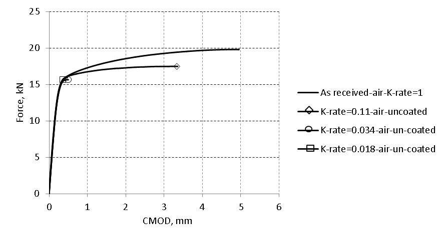

The fracture mechanics test results were in the form of force versus clip gauge extension records. Figure 2 shows force (F) versus crack mouth opening displacement, CMOD (derived from clip gauge extension records and used to calculate elastic plastic J integral). All the baseline tests were performed at a constant K-rate of approximately 1MPam0.5s-1 according to the recommendations given in the standard. The lowest curve from the baseline tests is shown in Figures 2a to 2c for reference and it is evident that the F vs CMOD curves for the tests performed on hydrogen charged specimens in air and in the environment at slow loading rates fall below this curve. These curves show that all the specimens achieved maximum force during the testing without any brittle fracture event during the test. The values of fracture toughness for each specimen were calculated in terms of J integral corresponding to the maximum force point in the F. vs CMOD data.

Hydrogen charged material tested in air
Figure 4 presents the calculated values of J for different tests versus hydrogen content measured after the test. The minimum fracture toughness of the material tested in air (as received with no hydrogen) was found to be 1160 Nmm-1
For the two tests (specimens 4 and 5) carried out on coated specimens in air, it was found that the specimen tested at the lower K-rate (K-rate of 0.06MPam0.5s-1) had very little remaining hydrogen (0.1ppm) after the completion of the test and the measured fracture toughness (in terms of J) was 1096Nmm-1. The second specimen (No 4) tested at a slightly higher K-rate (0.117MPam0.5s-1) had remaining hydrogen content of 0.14ppm and the measured toughness was 906Nmm-1. It appears that the specimen tested at the lower K-rate did not have sufficient hydrogen content by the time the critical load had been achieved to show any noticeable effect on the measured toughness, whereas the specimen tested at a slightly higher K-rate (having slightly higher hydrogen content) retained sufficient hydrogen to reduce the fracture toughness.
Further tests were carried out in air on un-coated hydrogen charged specimens (specimens 6 to 10) at different K-rates. There are five data points (‘empty diamond’ markers in Figure 4) representing the results from these tests. It is evident that lowering the initial K-rate from 0.11 to 0.019MPam0.5s-1 (the test duration increased from two to four hours) has resulted in dropping the measured hydrogen content from 0.41ppm to 0.32ppm. This drop in the measured hydrogen is in accordance with the established understanding, ie lower K-rate results in longer test durations and hence the specimens are likely to lose more of the bulk hydrogen. It nevertheless is evident that the measured fracture toughness of these specimens decreased with decreasing the K-rates. The fracture toughness of these specimens is significantly lower than the fracture toughness measured from baseline tests and tests conducted on coated and pre-charged specimens in air. These observations lead to the conclusion that the un-coated specimens absorbed more hydrogen and sufficient has been retained to have a significant effect on the measured fracture toughness in slower loading rate (K-rate) rate tests.
From the data, it is evident that the fracture toughness measured from the test conducted at the lowest initial K-rate (0.019MPam0.5s-1) is very similar to, but slightly higher (J~83Nmm-1) than the fracture toughness values (J~72Nmm-1 and 81Nmm-1) obtained from the tests conducted at a comparatively higher initial K-rate (0.034MPam0.5s-1, almost double the slowest K-rate). Referring to Figure 4, the hydrogen content in the specimen tested at the lowest K-rate (0.019MPam0.5s-1) is very close to the hydrogen content of one of the specimens tested at the comparatively higher K-rate (0.034MPam0.5s-1). The other specimen tested at K-rate of 0.034MPam0.5s-1 showed higher hydrogen content, nevertheless, the measured toughness was fairly close (81Nmm-1) to the toughness measured for the other specimens tested at the same K-rate. This suggests that the maximum possible amount of hydrogen is diffusing into the plastic zone at the higher K-rate, and thus reducing the K-rate further has no further effect on the measured fracture toughness. It can therefore be concluded that the test conducted at the initial K-rate of 0.034MPam0.5s-1 has shown the maximum effect of absorbed hydrogen on the measured fracture toughness.

Figure 2 Comparison of force versus CMOD
a)
b)
c)
Figure 2 Comparison of force versus CMOD (derived from clip gauge) records for tests performed on as received material in air with (a) pre-charged material (un-coated) tested in air (b) pre-charged material (coated) tested in air and (c) pre-charged material (coated and un-coated) tested in the environment. Note: K rates are in MPam0.5s-1
