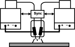

In the tandem MIG/MAG process, two wires are fed into a single molten pool through the same torch, but they are electrically isolated from each other and connected to two separate power sources, Fig.1. The process is commercially available in Europe and is beginning to be applied in the USA and Japan. At the time of writing it is estimated that between five hundred and one thousand systems have been sold worldwide. The main advantages of the process are claimed to be faster travel speeds and increased deposition rate [1-3] .
Fig. 1. Single torch, tandem wire MIG/MAG system with electrically isolated contact tips

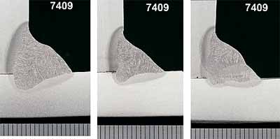

The literature review revealed the main process benefits to be increased welding speed, deposition rate and penetration, reduced porosity and better tolerance to variations in fit-up compared with conventional single wire MIG/MAG welding. Travel speeds and deposition rates are typically 2-3 times higher than for conventional single wire MIG/MAG welding. The process has been chiefly applied to steels, and some aluminium alloys with thicknesses in the range 1.5 to 25mm for steel, and 2 to 6mm for aluminium. In the experimental work, a single pass 10mm leg length fillet weld was produced in the PB position on 10mm thick mild steel plate at a travel speed of 600mm/min, twice that at which a single pass, single wire weld was produced. At the same travel speed of 600mm/min, three passes were required to complete the joint using single wire MIG/MAG, Fig.2. Not only was productivity found to be significantly higher with the tandem process, but the bead profile and penetration were also improved. The tandem process gives a deeper and more bowl-shaped penetration profile, which is likely to be beneficial in mechanised welding, where variations in fit up and joint position may occur.
Fig. 2. Macrosections of 10mm leg length fillet welds. From left to right: A single pass tandem weld made at a travel speed of 600mm/min, a single pass single wire weld made at a travel speed of 300mm/min and a three-pass single wire weld made at 600mm/min

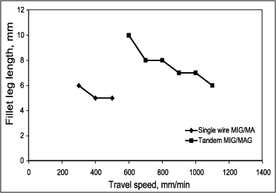

The fillet size vs. travel speed data are compared in Fig.3 for single wire and tandem processes operating at the maximum stable deposition rate condition for each process. A 6mm leg length fillet weld was produced using the tandem MIG/MAG process at 3.67 times faster travel speed and 3.5 times the deposition rate of the single wire weld.
Fig. 3. The effect of increasing travel speed on fillet size for single and tandem MIG/MAG processes
A 4mm leg length fillet weld was made on 6mm thick plate at a travel speed of 1800mm/min at a deposition rate of 4.5kg/h and under these conditions pulsed transfer was found to reduce undercut. The authors anticipate that fillet welds could be achieved at travel speeds in excess of 2000mm/min on thinner material.

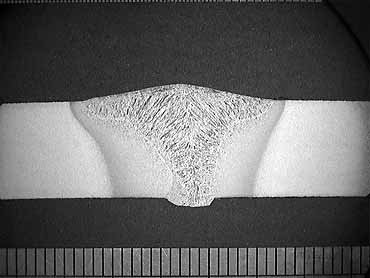

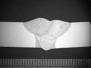

Similar improvements in deposition rate and travel speed were found for butt welds in 10 mm thick plate. Pulsed transfer was found to be more tolerant to burn-through than spray transfer for the root run, which was completed at a travel speed of 700mm/min. The butt joint was completed in two passes, Fig.5. The same preparation required five single wire passes to fill in this work, although an optimised single wire procedure would typically require three passes, Fig.4.
Fig. 4. A 5-pass single wire 10mm butt weld
Fig. 5. A 2-pass tandem wire 10mm butt weld
