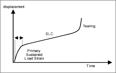

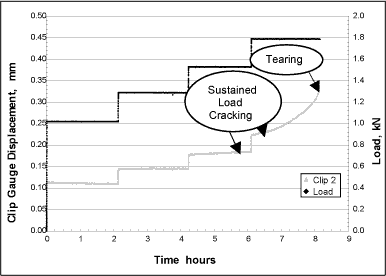

The form of the clip gauge displacement versus time traces is shown in Fig.3, for a specimen from the MIG weld metal. This graph shows, schematically, the stages of the test and the difference between plastic deformation due to primary sustained load strain ( Fig.3a) and crack growth due to SLC ( Fig.3b). Micrographs of the fracture faces of one of the specimens are shown in Fig.4. The deduced values of K init and K th are listed in Table 4 for each specimen (both shown as ratios against K max , but K th is also shown as an absolute value). Summaries of K init /K max , K th /K max and K th are presented in Table 5, for the parent metals.
Fig.3a) Schematic diagram showing sustained load stain versus time for titanium alloys
Fig.3b) Load and clip gauge displacement versus time during step loading testing of SENB samples from parent material M4, postweld heat treated at 650°C for one hour. Black line shows the load, and the grey line shows data from the clip gauge

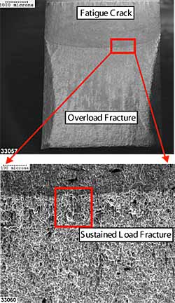

Fig.4. Scanning electron images showing the fracture face morphology of a SENB test specimen, of parent metal M4, postweld heat treated at 650°C for one hour. 15kV secondary electron image, nominal magnification scales shown
4a) overview - fracture face
4b) as above but at greater magnification. Note the mixed ductile and 'brittle' fracture morphology
4c) as in b, but at greater magnification.
