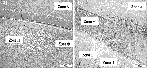

The first butter layer has been diluted by the low alloy steel and exhibited some partly-fused 'swirls' of steel-rich material between adjacent weld passes (i.e. at inter-run positions). This occurs since the melting temperature of the alloy 625 (~1350°C) is somewhat lower than that of the alloy steel (~1500°C). As well as these 'inter-pass swirls' there were also 'intra-pass swirls' that form along the length of the weld beads of the first layer of butter deposit, as a consequence of periodic variations in weld penetration.
A narrow (typically a few tens of microns wide) PMZ is present between the non-fused steel parent and the bulk of the weld deposit, and has a chemical composition that lies between that of the steel and that of the bulk of the first layer. After PWHT, it is anticipated (and substantiated in the present work) that carbon migration from the steel to the Cr/Mo/Nb rich butter deposit creates a decarburized zone in the alloy steel adjacent to the fusion boundary and a carbon-enriched zone in the immediately adjacent fused metal. The microstructures and chemistries of the inter- and intra-pass swirls were complex, with a gradation in composition across the swirl and the material immediately around it (Figure 1b). Whilst individual swirls showed broadly comparable features, each was relatively unique due to slight variations in geometry, dissolution and chemistry. In comparison, the mid-bead position of the interface was quite reproducible (Figure 1a).
Fig.1. Micrographs of the dissimilar interface
a) at mid-bead position;
b) at an inter-pass position
The microstructure across the dissimilar interface was found to consist of six different morphological zones. Not all of these zones were found at all positions, but when present were, in order of low alloy steel HAZ to the bulk of the first butter layer, as follows:
  1. Parent material showing a fine ferritic microstructure, with occasional 'fingers' of highly diluted butter deposit penetrating into the steel, apparently at prior austenite grain boundaries;
  2. A narrow decarburized zone in the region of the forging immediately adjacent to the fusion boundary and containing occasional high atomic number particles (labelled Zone Δ);
  3. Immediately at the fusion boundary (mostly within the PMZ, but perhaps extending slightly into non-fused steel), iron-rich martensite-like laths extending a few microns into the PMZ, primarily at inter-pass positions and within inter-pass and intra-pass swirls of diluted steel penetrating into the butter deposit (labelled Zone M). No similar features were found at mid-bead positions away from intra- and inter-pass swirls;
  4. A featureless region on the butter side immediately adjacent to the fusion boundary and exhibiting an apparently homogeneous single-phase microstructure on a microscopic scale (labelled Zone Φ);
  5. A region containing numerous high atomic number particles (labelled Zone Π). These particles exhibited an inter-dendritic distribution, consistent with the expected segregation of Mo and Nb during solidification of this highly diluted region of the butter deposit;
  6. The bulk of the first deposit layer and subsequent layers with close to alloy 625 chemistry, and a less populous inter-dendritic distribution of Nb/Mo particles.
Zones 3 to 5 constituted the partially mixed zone (PMZ) within the weld metal, as determined from the extent of the chemistry gradient between the parent metal and the bulk of the first butter layer. This PMZ mainly consisted of Fe, Ni and Cr with proportions that were closer to that of the forging close to the interface, and closer to the alloy 625 weld deposit further away, with a width from a few tens to a few hundreds of microns (although mostly at the lower end of this scale).

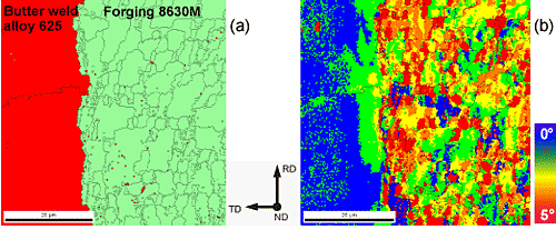

At the mid-bead positions, the 'butter side' exhibited a face centred cubic (FCC, or 'austenitic') structure with large grains; while the 'steel side' showed a fine grained body centred cubic (BCC) (ferritic) structure (Figure 3a), with no discernible martensite. The particle-free region (Zone Φ) consisted of large and elongated (in the direction parallel to the fusion boundary) grains, often restricted to this zone, as opposed to continuing seamlessly into the bulk of the butter deposit. The grains of the bulk weld bead were elongated perpendicular to the fusion boundary. The swirls exhibited a mixture of fine lath grains and equiaxed grains, depending upon location, with the lath grains found predominantly in positions where the swirl appeared to be partially dissolved by the butter weld metal. Fully automated EBSD analysis could not differentiate between the BCC ferrite and the BCT martensite, but carefully set up detailed semi-automatic analysis clearly identified martensite in the swirl regions, corresponding to the laths identified metallographically (Figure 1b). The high atomic number inter-dendritic particles observed in Zone π were identified as having primarily a niobium carbide crystal structure, NbC.
A small plastic strain was found in the PMZ, adjacent to the interface at the mid-bead positions (Figure 3b), but this was lower than that found in the adjacent ferrite. Limited local plastic deformation was also identified within the particle-free region of the PMZ (Zone Φ, with a lattice distortion of up to 2° similar to that found at the mid-bead position). It was clear, however, that the amount of plastic strain in the PMZ and steel was relatively small, consistent with what would be expected from relief of residual stress during PHWT. Plastic strain levels were comparable in interpass regions, with the strain around the martensite no greater than that found locally elsewhere.
Fig.3. EBSD analysis at the mid-bead position a) Phase map showing the FCC in red and the BCC in green b) Kernel average misorientation (KAM) map showing the deformation distribution

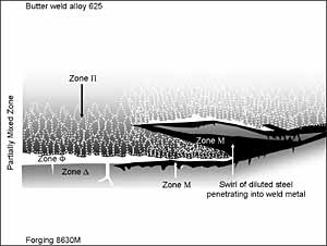

The dissimilar joint between 8630M and the alloy 625 butter showed several microstructural zones on traversing across the dissimilar interface. Based on the examination summarised in the present paper, a microstructural model was established and is presented in Figure 6.
Fig.6. Microstructural model of the dissimilar interface of a 8630M buttered with alloy 625. An interpass swirl is shown on the right hand side, whereas the left hand side is comparable to a mid-bead position
Macroscopically, 'swirls' of steel penetrating up to a few hundred microns into the first butter layer were present at inter-pass positions, and intra-pass locations where local perturbations in penetration had occurred. The inter-pass positions, including at partially dissolved steel swirls, also exhibited martensite as a consequence of the higher dilution in this zone. Fingers of butter weld metal penetrating into the steel were also present, akin to shallow liquid metal penetration along the austenite grain boundaries of the forging GCHAZ at high temperature. No cracking was observed in these 'fingers' and it is not believed that these features have any significance in terms of structural performance.
The PMZ, immediately adjacent to the fusion boundary, consisted of a featureless particle-free zone (zone Φ) and, further into the butter deposit, a region with an interdendritic distribution of primarily NbC (zone π). It is postulated that zone Φ forms as a consequence of the high Fe and C dilution from the parent steel, both reducing the proportion of Mo and Nb segregates and changing the solidification mode to planar (thereby avoiding interdendritic segregation completely).[4] The transition to zone π occurs when the solidification mode changes to dendritic.
During post weld heat treatment, diffusion of interstitial species, in particular carbon, across the dissimilar interface dominates the microstructural changes experienced. A narrow decarburized zone was present within the steel, immediately adjacent to the fusion boundary, accompanied by a peak of carbon in zone Φ of the PMZ, formed due to a 'pile-up' of carbon. Given that zone Φ has been enriched in carbon, diluted from the parent steel during welding, and then further enriched in carbon, as a consequence of its diffusion from the steel during PWHT, it is somewhat surprising that no carbides have formed, especially considering that the carbon solubility in nickel is typically lower than that in iron. However, it is believed that the microstructure in the featureless zone after PWHT consists of carbon in a supersaturated solid solution, perhaps accompanied by a fine dispersion of nano-sized carbides. The equilibrium solubility limit of C in ferrite (pure iron) is at most 0.1at% (0.02wt%). However, this represents equilibrium conditions and thus assumes adequate mobility of all elements. At the PWHT temperature the mobility of strong carbide formers is very low and thus assumptions of para-equilibrium conditions (i.e. considering only the diffusion of carbon) are more appropriate. This has been exploited for low temperature carburisation surface hardening of stainless steel,[5,6] where by control of temperature and carburising atmosphere, supersaturated solid solutions containing as much as 12at.%C (3wt%) can be achieved together with hardness levels in excess of 600HV.[7.8] The PWHT temperatures of relevance to the present work, although greater than that used to produce such massively supersaturated solid solutions, are still expected to permit quite significant supersaturation.
