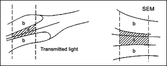

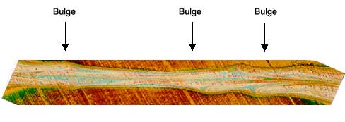

Transmitted light microscopy showed that welds with reasonable mechanical properties generally had one or more bulges (see Fig.1), or even double bulges (probably marking the transition from laminar to turbulent flow [7] ), separating the central weld region from the region of flow lines leading out to the flash, Fig.1 (weld 126, 2Nmm 2, 6sec). The central weld region contained a well defined centreline, but was otherwise relatively featureless and perhaps non-spherulitic: this would correlate with the lower crystallinity than in the parent, and would be in common with the non-spherulitic appearance of vibration welds in other semicrystalline thermoplastics such as PP, PA 6, and PA 6,6. As the welding time increased, the width of the region containing flow lines increased at the expense of the central weld region. At lower welding pressures, lack of fusion defects (1Nmm -2) or welds lacking the characteristic bulges (1.5Nmm -2) were evident. Using too high a welding pressure (4Nmm -2) produced a weld which, although it had bulges, was very narrow at the centre (4 sec), or which failed at the weld centreline on sectioning (8 sec).

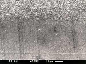

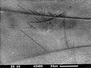

The SEM photomicrograph taken from the centre of etched weld 126 (2Nmm -2, 6sec) is shown in Fig.2a, where the weld centreline, visible heat affected zone (VHAZ), and the parent material adjacent to the VHAZ were revealed. The attack on the parent material had taken the form of pitting, the weld region was smoother and contained much finer pits, and the weld centreline had undergone preferential attack. The VHAZ consisted of deformed spherulites. Figure 2b shows the 'flow' region to the left of the left hand bulge in Fig.1: the photomicrographs are mirror images, so the relationship between the areas in each are shown in Fig.3. Region 'a' in Fig.2b was similar to the weld region in Fig.2a, and the centreline was present, and the outer edges of the flow region, 'b', were comprised of oriented material.

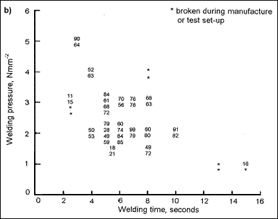

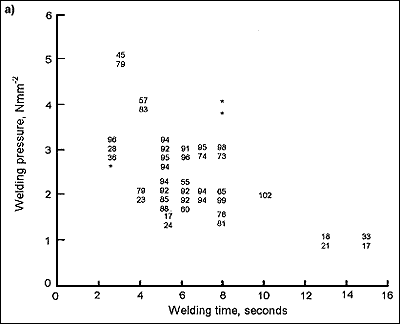

At a weld pressure of 1Nmm -2 maximum weld strength was 33% of the parent tensile strength (107Nmm -2) with welding times of 13 to 15 seconds, while three tensile-impact specimens fell apart during machining, and the fourth gave 16% of parent strength. At a pressure of 1.5Nmm -2, increasing the welding time from 5.25 to 8 seconds increased the tensile strength from around 20% to 80%, and tensile-impact strength from 20% to 49-72%. Figure 4a indicates the optimum welding conditions (based on tensile results) to be 5 seconds at a pressure of 3Nmm -2 which gave welds which were 92 to 95% of the parent strength. This was a higher pressure than would typically be used for PP (around 0.5 to 1.0Nmm -2) as more energy is required to melt PEEK than PP. Figure 4b shows that these welding conditions were also near optimum for the tensile-impact behaviour. At a pressure of 4Nmm -2, 4 seconds gave tensile strengths of 57% and 83%, and tensile-impact strengths between 52 and 63%; and welds produced at 8 seconds fell apart during machining. For the weld made at 5Nmm -2, with a time of 3 seconds, tensile strengths were 44% and 79%, and tensile-impact strengths were 64%, and 90%.
Fig.4. Variation of mechanical properties, as % of parent material strength, with welding pressure and time: Fig.4a) tensile strength
Fig.4b) tensile-impact strength

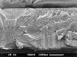

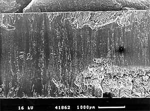

Examination of the fracture surfaces of the broken mechanical test specimens showed the lowest tensile and tensile-impact strengths were associated with failure in the VHAZ. Highest strengths were also obtained when failure occurred in the VHAZ, but with a more irregular fracture surface appearance, Fig.5a. In the tensile tests, failure occurred predominantly in the VHAZ, whereas under tensile-impact testing the majority of samples failed at the weld centreline, Fig.5b. The presence of inclusions on the fracture surface did not appear to affect the strength of the welds, unless these were large enough to cause beach marks. The fracture surfaces did not show the zones of vertically structured material along the outside edges which were observed in PA 6,6 vibration welds and were associated with failure initiation within the flow lines leading out to the edge of the welds [4,8] .
