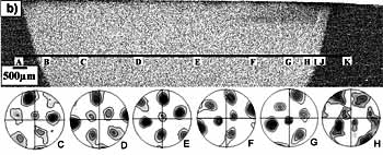

A more detailed examination of the weld microstructure of a weld made at 400rev/min and 60mm/min using high resolution electron backscattered diffraction (EBSD) is shown as an orientation image map in Figure 5a. The EBSD data was acquired using a 3µm step size in the plane perpendicular to the travel direction with an FEI Sirion FEGSEM equipped with an HKL Nordlys CCD camera controlled by HKL Channel 5 acquisitionsoftware. The map, which covers the top 4 mm of the whole weld, shows distinct orientation regions across the weld which are labelled A to K and a surface layer labelled L. Regions A and K are in parent material and contain a strongrolling texture and a spheroidised alpha microstructure. There appears to be some slight coarsening of the microstructure on both sides of the weld as the weld is approached, but there is no evidence of deformation. This is confirmedby the texture in region J (retreating side) which is almost identical to that of the parent material. Just beyond J there is a subtle orientation change that is approximately 250µm wide (Region I). The pole figure of this regionhas changed but has many similarities with the parent material suggesting that this region has perhaps been heated above the beta transus, (~990°C), but has experienced no deformation. To examine this further the map in Figure 5a has been plotted ( Figure 5b) showing only boundaries with a misorientation greater than 12° and which also do not correspond to a misorientation between alpha transformation variants from the same beta grain 2). This highlights theposition of the prior beta grain boundaries. Thus it can be concluded from Figure 5b that region I has experienced significant beta grain growth.
Fig.5
Fig.5
a) An Euler contrast orientation image map and
b) A beta grain boundary construction map using Burgers misorientation. {0002} pole figures represent alpha phase textures in the regions highlighted in the map. Pole figure L is the texture for the surface layer of the weld. Each contour in the pole figures represents 1x random intensity. Regions A and K are on the advancing and retreating side, respectively.

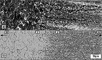

This is further confirmed by high resolution maps of regions I and J shown in Figures 6a and 6b. These maps clearly show the as-rolled microstructure in region J and a fully acicular alpha structure transformed from large equiaxedbeta grains in region I. The adjoining region, H, also has a similar transformed microstructure but the texture has become diffuse suggesting that the prior beta grains have been slightly plastically deformed before transformation back to alpha. Hence, we believe region H defines the edge of the thermo-mechanically affected zone (TMAZ). A similar situation also exists on the advancing side (the detailed analysis is not shown in Figure 5) except that the equivalent regions are slightly larger. Work is now ongoing to confirm these observations with emphasis on static heat treatments above and below the beta transus of the parent material to identify the textures of heat affected only material.
Fig.6
Fig.6
a) High resolution orientation image map (Euler contrast) of retreating side of the weld in Figure 5
b) Beta grain boundary construction of a) using Burgers misorientation. Highlighted boundaries represent a misorientation >12°.
For material closer to the weld centre the microstructure again consists of an acicular alpha microstructure but the width of the similarly orientated regions is of the order of 2mm. In all cases these regions have relativelydistinct textures clearly different from the parent but with intensities at the same level of the parent's texture. It is unclear at this stage, however, if these textures are transforming from deformed or recrystallised beta grains.Work is now ongoing to reconstruct the beta morphology and texture in order to gain evidence for distinct TMAZ (non-recrystallised beta) and nugget (recrystallised beta) zones. Information already in hand ( Figure 5b), however, shows the beta grain size to be relatively uniform at approximately 50µm throughout the whole cross-section of the weld suggesting that there are no major regions of accelerated grain growth withinthe weld.
For material at the surface of the weld, region L, there is a significant change in texture from the bulk with the development of a strong transverse basal texture to a maximum depth of about 250µm. The microstructure is alsochanged with a considerable reduction in prior beta grain size. It should also be noted that this surface layer extends beyond the pin affected region of the weld to fit exactly the area underneath the stationary shoulder and,therefore, we believe this layer has its origin in the shear force generated by the forward motion of the stationary shoulder. Moreover, below this layer the texture immediately returns to the textures described previously indicatingthat the effect of the stationary shoulder on microstructure evolution is limited to a relatively thin surface layer.
On a more bulk scale, the complete textures of the advancing and retreating sides have been analysed and they show an interesting symmetry relationship. If there was no forward motion in the weld then the advancing side's texturewould look the same as the retreating side's texture when viewed from the opposite face of the viewing plane. This was not the case for the current weld but the textures were similar and they were made nearly identical, as shown in Figure 7, by a rotation of about 30° about the vertical direction of the weld.
