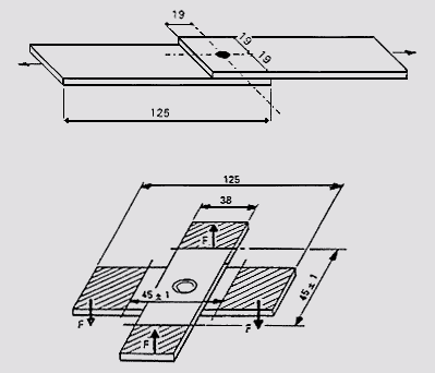

Static tests were conducted on a 200kN Avery Denison tensometer. The shear and cross-tension test samples were made according to the French standards A 87-001 and NF A 89-206, see Fig.1. The fatigue tests were conducted on a 20kN Amsler Vibrophore at a test frequency of approximately 100Hz and a load ratio of R = 0.1 (min/max load during the cycle). A two spot shear test sample was used in this case, as shown in Fig.2.
Fig.1. Static tensile-shear and cross-tension test specimens (dimensions in mm)

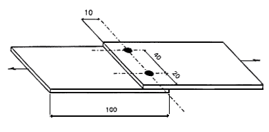

Fig.2. Fatigue specimen (dimensions in mm)

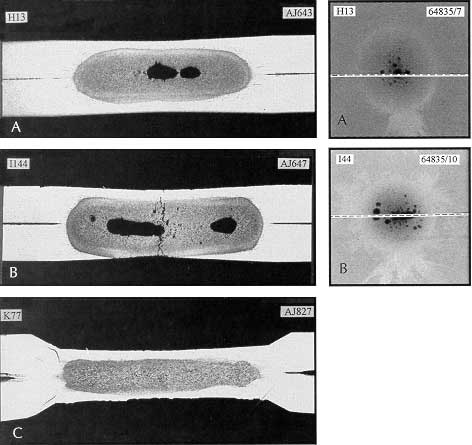

Standard series welds showed satisfactory nugget penetration with some lack of symmetry. There was substantial porosity in the nugget although the periphery was clear as shown in Fig.3a. Increased porosity was present in the low electrode force welds with a central pore usually 2 to 3mm diameter and often associated with cracks ( Fig.3b). The deeply indented spot welds (series K) had 40 to 50% indentation at the centre and greater than 1.2mm sheet separation 10mm from the weld edge. However, there was no porosity in the narrow weld nugget ( Fig.3c).
Fig.3. Metallographic sections of aluminium alloy spot welds comparing discontinuities. Radiographs show the plan view, as-welded and are marked to show the position of the subsequent section.
a) Standard series (H) - weld H13 (26.6kA)
b) Excessive porosity (I) - weld I44 (24.3kA)
c) Heavy indentation (K) - weld K77 (32.7kA)
The results of the static tests for the standard series (H) and series I, HP and K are given in Table 3. All the cross tension tested welds gave a button/plug failure, although the welds with excessive porosity or deep indentation were significantly weaker than the standard series. The shear test samples were of a similar strength except for the drilled out welds, and interface failures occurred in all but the deeply indented welds. In many cases the normal scatter of results exceeded the effect of the discontinuities or of welding conditions.

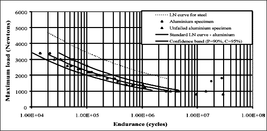

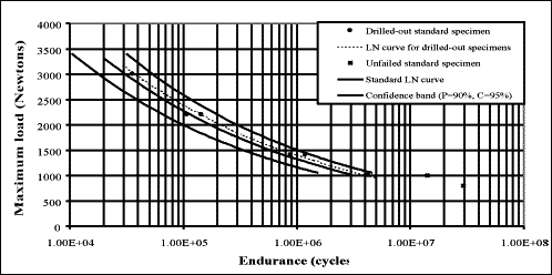

The fatigue test results are shown in Figs 4 to 6 for comparison of the effect of discontinuities with the standard series. The welds with excessive porosity failed at a slightly lower load than the standard series (1.1kN compared to 1.3kN at 10 6 cycles) but within the scatter band showing 90% chance of failure ( Fig.4). In addition, the failure mode was similar in each case, with a crescent shaped crack growing through the thickness from the edge of the nugget. The results for the drilled out samples gave the same fatigue performance as the standard series ( Fig.5).
Fig.4. L-N curves for specimens with excessive porosity (1.5kN electrode force, series I) plus comparison with standard specimens in aluminium and welds made with high force (6.5kN)
Fig.5. L-N curves for drilled-out spot welds (series HP) and comparison with standard specimens in aluminium

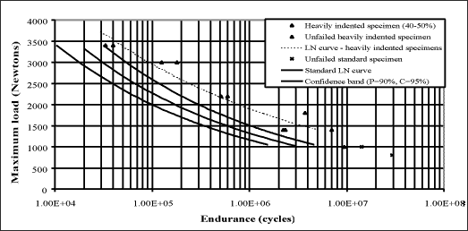

Fig.6. L-N curves for heavily indented specimens (series K) and comparison with standard specimens in aluminium

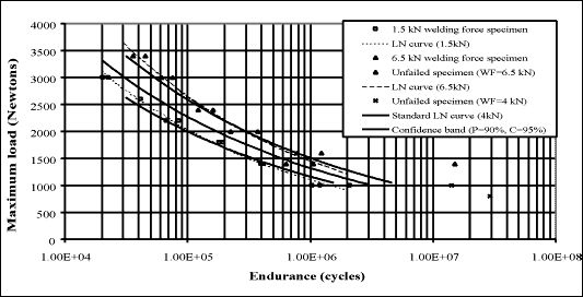

As a means of checking the effect of force on fatigue properties, some untested low force welds were pressed cold between the welding electrodes at 4kN. This treatment improved the fatigue properties as the test results for these samples (e.g. 1.5kN at 10 6 cycles) were within the scatter band for the standard series. Furthermore, additional welds made at an even higher force of 6.5kN, using domed electrodes, gave a higher load than the standard series at 10 6 cycles of 1.5kN, on the upper limit of the scatter band ( Fig 4).
The deeply indented welds ( Fig 6) failed at a substantially higher load (1.9kN at 10 6 cycles) than the standard series (1.3kN). In addition, the fatigue cracks started in the parent material 2 to 5 mm outside the notch at the interface.

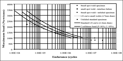

The fatigue results showed less difference between the weld sizes than did the static results ( Fig 8 and 9). At low endurance, the small welds withstood a lower fatigue load than the standard series scatter band. At these conditions, the L-N curve for the large welds was slightly better than the standard series, but remained within the scatter band. In all except the small welds, which failed across the interface, classical failure occurred. This comprised a crescent shaped crack, starting from the edge of the weld or bonded zone and propagating through the material thickness. At high cycle/low load conditions, there was no significant difference between the weld sizes. All of these welds showed the classic failure mode, described above.
Fig.8. L-N curves for small spot welds (series L) and comparison with standard specimens in aluminium

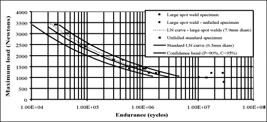

Fig.9. L-N curves for large spot welds (series M) and comparison with standard specimens in aluminium
The results for the large welds were also very similar to the standard series with individual values lying within the scatter band over the whole test range. All of these welds showed the classic failure mode, with the crescent shaped crack starting from the edge of the weld or bonded zone and propagating through the thickness.

Influence of Electrode Force
Although, fatigue properties of welds were fairly insensitive to the discontinuities studied, electrode force appeared to play a more important role. It would appear that higher electrode force, or a post weld squeeze, improved the fatigue performance. This may be because the higher forces modify either the residual stress at the edge of the weld, where the fatigue cracks initiate, or reduce the sharpness and stress concentration at the notch. The radial residual stress in this zone, due to the cooling of the weld, was shown to be tensile and close to the material yield stress to aluminium [13] . Furthermore, mechanical treatment of welds [13] was shown to increase fatigue life tenfold, although thermal treatment gave no improvement. Post-weld compressive loading of spot welds in steel is a recognised means of improving fatigue performance by introducing compressive stresses at the edge of the weld.
The bonded zone is not normally considered as contributing strength to welds in aluminium alloys and the cross-tension tested welds showed failure at the edge of the fused zone. However, at low load fatigue conditions, there is sometimes sufficient strength to promote cracking from the outer edge of this zone.
