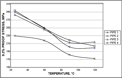

The 0.2% proof strength of the material was measured on round tensile specimens at various temperatures to provide data for loading the specimens for the environmental cracking tests (in compliance with paragraph B.3.4, ISO 15156-3, 2003[3]).

Table 3 tensile test results for parent 316/316l pipe material at the temperatures at which scc tests were performed
 0.2% proof strength/MPa
25°C 60°C 90°C 120°C
Pipe 1 290 250 202 199
Pipe 2 294 249 219 204
Pipe 3 283 246 213 214
Pipe 4 230 218 182 172
Fig.3. Measured 0.2% proof strengths of parent materials tested

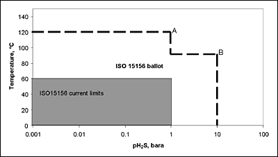

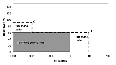

Diagrams of the parent material data produced during this test program are shown in Figures 5-6 against the current ISO 15156-3 sour service limits for Type 316 stainless steel. The ISO limits include the corrigenda published recently by ISO[7] including changes from data balloted by Kane.[4] Figure 5 summarizes the test results from the 1 000mg/l chloride, nominal pH3.5 environment. Figure 6 summarizes the test results from the 50 000mg/l chloride, nominal pH4.5 environment.
Fig.5. Data A and B submitted for ISO ballot, based on parent material SCC tests. Environment contained 1 000mg/l chloride, nominal pH3.5
Fig.6. Data C and D submitted for ISO ballot, based on parent material SCC tests. Environment contained 50 000mg/l chloride, nominal pH4.5
ISO ballot
Based upon the results of the test program, ballot tables for the following conditions were prepared, and at the time of writing await response from the ISO committee, all with 10bara pCO2:
These were all conditions where welded material had been tested under the same conditions and had passed also, so that the data can be more confidently applied to materials selection for welded products. However, specific testing will still be required to qualify materials and welding procedures for service application.
A 1 000mg/l chloride, 120°C, 1bara pH2S, nominal pH3.5 (PASS)
B 1 000mg/l chloride, 90°C, 10bara pH2S, nominal pH3.5 (PASS)
C 50 000mg/l chloride, 90°C, 0.01bara pH2S, nominal pH4.5 (PASS)
D 50 000mg/l chloride, 60°C, 10bara pH2S, nominal pH4.5 (PASS)
Further to this, it is suggested that tests include typical weldments to support the limits for the 'any application' tables. Where the results have impacted upon the potential application envelope of 316/316L, or indeed other CRA, in sour service, but where the test results are not suitable for ballot (for the accompanying reasons below), these should be reported to NACE TG299, Oversight Committee for ISO 15156/MR0175. This will benefit industry awareness, specifically regarding derivation of knowledge of potential boundary conditions through accumulation of data over time.
