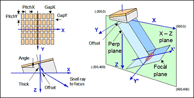

Figure 1 shows the parameter definition in SimulUS. It shows the three possible planes on which the model can be evaluated, denoted as the X-Z plane, the perpendicular plane and the focal plane (or any plane parallel to the latter plane). The transducer is generalised to a two dimensional array which becomes a single crystal when the array size is 1 by 1. Note also the definition of the wedge thickness as a key input parameter (referred to as 'Thick' inFigure 1).
Fig. 1. Definition of parameters in SimulUS and the three simulation planes
(Reprinted with permission from Peak NDT, UK)

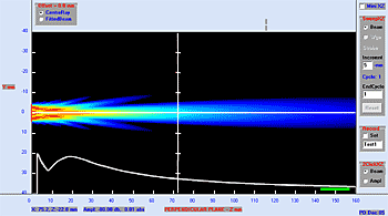

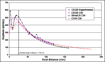

As an example, Figure 2 shows the pressure field in the X-Z plane for the 4MHz 8mm x 9mm rectangular single crystal.
Fig. 2. Pressure field along the beam axis for the 4MHz 8mm x 9mm rectangular single crystal generated along the X-Z plane by SimulUS.

The sound pressure along the main beam axis (on axis) and the pressure profile perpendicular to the beam axis (crossbeam) at several ranges were used for validation. Table 2 summarises the data presented in this paper. The range refers to the distance along the main beam axis from the index point (the geometric point on the interface where the sound is incident on the material from the wedge) along which outputs were generated in SimulUS. The simulation results are presented in section 4.1.

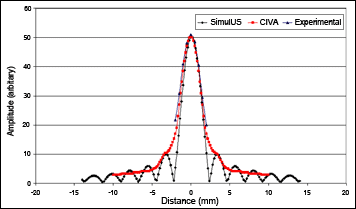

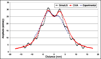

The crossbeam data are evaluated on the focal plane (see Figure 1). The profile along the X' and Y' axes (see Figure 1) are extracted from the two-dimensional output; the sound field is only refracted along the X-Zplane and is un-refracted along the Y-Z plane. Both the on axis and crossbeam data are presented as profiles for comparison with experimental data and the output from the other models. As an example, Figure 3 shows the two-dimensional crossbeam data evaluated on the focal plane by SimulUS for the 2MHz 20mm x 22mm rectangular single crystal at a range of 66mm.
Fig. 3. The crossbeam of the 2MHz 20mm x 22mm rectangular single crystal at a range of 66mm. The sound pressure profiles along the two focal plane axes X' and Y' are traced in white along the red cursors.

As in the case of single crystals, pressure profiles along two orthogonal axes on the focal plane are used in the validation. However, the two axes are referred to as the active and passive axes, corresponding to data on there fracted and un-refracted planes, respectively. The differing terminology is used to help differentiate between the direction along which the sound field is electronically manipulated (phased) by the array - the active axis - and the direction along which the radiation of sound is not controlled electronically - the passive axis. The selection of cases presented in this paper are summarised in Table 3 and presented in Figures 10 to 15.

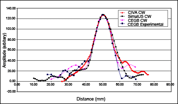

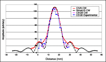

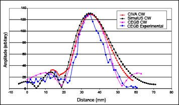

The on axis pressure profiles of the 4MHz 8mm x 9mm rectangular single crystal are shown in Figure 4. The experimental data and the model data from the NDTAC are shown along with the modelling results from SimulUS and CIVA.Figure 4 shows that all three continuous wave models are accurate to within 1dB in the far field, ranges greater than 50mm; the experimental evidence is not sufficient to comment on the accuracy of the three models below this range. At ranges shorter than the near field length (N) the sound field is known to fluctuate rapidly with distance along the main beam axis and off axis. It is believed that all models have limited application within this region and find it difficult to predict actual field variation. Continuous wave models exaggerate the fluctuations due to strong interference patterns and for this reason TWI does not recommend the use of any continuous wave models at ranges less than the near field.
Fig. 4. The on axis pressure profiles of the 4MHz 8mm x 9mm rectangular single crystal

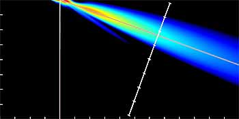

Figure 5 shows the sound pressure field evaluated by SimulUS in the perpendicular plane for the 4MHz 8mm x 9mm rectangular crystal. Note the sound pressure field profile along the main beam axis (on axis) outlined in whiteat the bottom.
Fig. 5. The pressure field of the 4MHz 8mm x 9mm rectangular single crystal evaluated in the perpendicular plane by SimulUS

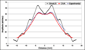

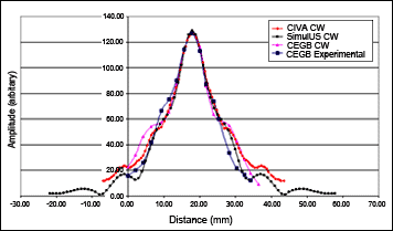

Figures 6 and 7 show the crossbeam profiles along the un-refracted and refracted planes, respectively, at a range of 66mm for the 2MHz 20mm x 22mm rectangular single crystal. The predicted 6dB beam widths are accurate to within 10% along the un-refracted plane (Figure 6), but below the 6dB point from the peak strength, all three models show variation of up to 10dB compared to experiment and they generally overestimate the beam width. Along the refracted plane (Figure 7) the predicted 6dB beam width is again accurate to within 10%. Again, as along the un-refracted plane, the models become inaccurate when more than 6dB below the peak signal strength. The models are accurate, to within 10dB of experimental strength, along the least refracted edge of the beam (left of the peak) and are less accurate (to within 20dB of experiment) along the most refracted edge of the beam (right of the peak). In general, note that CIVA shows closer agreement to experiment along the least refracted edge (left of the peak), while the NDTAC model shows better agreement along the most refracted edge (right of the peak).
Fig. 6. The crossbeam profile along the un-refracted axis for the 2MHz 20mm x 22mm rectangular single crystal at a range of 66mm
Fig. 7. The crossbeam profile along the refracted axis for the 2MHz 20mm x 22mm rectangular single crystal at a range of 66mm

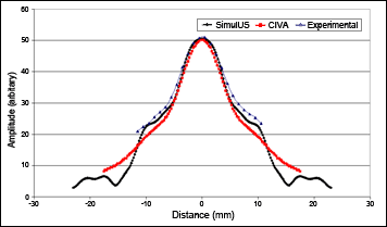

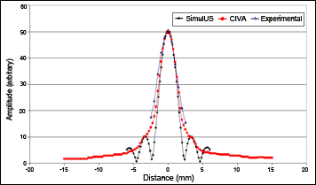

Figures 8 and 9 show the crossbeam profiles along the un-refracted and refracted planes, respectively, at a range of 99.5mm for the 4MHz 8mm x 9mm rectangular single crystal. Along the un-refracted plane (Figure 8)all the models predict the 6dB beam width accurately to within 10% and remain equally accurate up to the 8dB beam width. The continuous wave nature of the models is clearly illustrated at distances away from the main beam (beyond the20dB beam width). Along the refracted plane all the models overestimate the 6dB beam width by up to 60% in the case of SimulUS, 45% in the case of CIVA and only 20% in the case of the NDTAC model. The difference is less along the least refracted edge (left of the peak) than along the highly refracted edge (right of the peak). In this respect the NDTAC model predicts the experimental profile better than both SimulUS and CIVA.
Fig. 8. The crossbeam profile along the un-refracted axis for the 4MHz 8mm x 9mm rectangular single crystal at a range of 99.5mm
Fig. 9. The crossbeam profile along the refracted axis for the 4MHz 8mm x 9mm rectangular single crystal at a range of 99.5mm
For the inspection configurations considered in this study, SimulUS is able to predict the on axis pressure field profile of unfocused probes to within 1dB at ranges greater than 1.2 near field lengths. Similarly, when refraction is involved, the prediction of the 6dB beam widths at ranges greater than N is accurate to within 10% along the un-refracted plane but the accuracy decreases along the refracted plane.

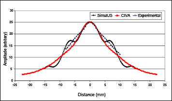

Figure 10 shows the crossbeam profile of the 2MHz linear phased array probe along the active axis at the focal depth when the beam is steered at 0° and focused to a depth of 100mm. The experimental data was collected at TWI; CIVA was run with a finite broadband pulse input but SimulUS was run in its continuous wave mode. Both models are accurate to within 10% in their estimate of 6dB beam width. The strong side lobes of energy predicted by the SimulUS model are due to the single frequency content in its input pulse (continuous wave), unlike CIVA which has a finite spectrum that effectively averages the energy distribution to eliminate points of maxima and minima. The continuous wave mode appears not to affect the ability of SimulUS to effectively estimate the 6dB beam width.
Fig. 10. The crossbeam profile along the active axis at the focal depth when the beam is steered to 0° and focused at 100mm depth (2MHz 22-element linear array)
Along the passive axis, beyond the focus at the downstream position the 6dB beam width is again estimated to within 10% (similar to CIVA) in the case shown in Figure 11 (beam steered to 0° and focused at 100mm depth),but the general features of the crossbeam profile along the passive axis are exaggerated by SimulUS, whereas CIVA tracks the experimental pressure profile curve better. Similar levels of accuracy in crossbeam profiles at the focal depth are achieved in the case of steering to 6° and focusing to a depth of 100mm, as outlined in Figures 12 and 13, with maximum inaccuracy of 20% for SimulUS (in the active axis case).
Fig. 11. The crossbeam profile along the passive axis at the downstream position when the beam is steered to 0° and focused at 100mm depth (2MHz 22-element linear array).

As in Figure 11, the continuous wave nature of SimulUS is apparent in its prediction of the passive axis profile shown in Figure 13, but the exaggeration of the double hump by SimulUS, apparent in experiment, is less than 2dB.
The 6dB beam width estimate of SimulUS is within 10% for the case shown in Figure 14. The upstream position (as in Figure 14) is within the region of the material where beam forming takes place for a phased array transducer and the sound pressure fluctuates rapidly with position (as in the Fresnel region of single crystal unfocused transducers). In the case of focusing to a depth of 200mm while steering the beam to 4.92° shown in Figure 14, SimulUS performs well with regard to beam width estimates (within 10%) and predicting the double hump feature, but both models overestimate the second hump by ~2dB in comparison to the experiment.
Figure 15 shows the passive axis crossbeam profile where SimulUS underestimates the 6dB beam width by around 20% but is more accurate than CIVA which underestimates the 6dB beam width by up to 30%.

The 6dB beam width measurements are summarised in Table 4.
Table 4 Summary of beam width measurements for the linear phased array cases (note that the quoted accuracy is rounded up to the nearest multiple of 10 %).
CaseExperimental 6dB beam width (mm)CIVA 6dB beam width (mm)
(% accuracy)
SimulUS 6dB beam width (mm)
(% accuracy)
1 3 2.96 (10%) 2.9 (10%)
2 17.6 16.5 (10%) 17.1 (10%)
3 3.5 3.25 (10%) 2.9 (20%)
4 20 18 (10%) 20.2 (10%)
5 14.5 15 (10%) 14.2 (10%)
6 18 13.5 (30%) 15.4 (20%)
