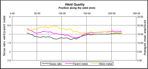

Fig. 6. Incorrectly forged FSW butt weld after statistical signal processing
Figure 5 and Figure 6 show the data collected from the samples after statistical signal processing. The algorithm imports 3D volumes of data out of the raw inspection data from the specified areas within the weld and parent plate. It then performs a volumetric moving average type function to smooth out the individual noise amplitude values. This method also minimises the effect of spurious indications in the scan data, which generally appear singularly and not in clusters. The algorithm then compares the manipulated noise data of the weld root with that of the parent plate. The ratio of the two is a quantitative indicator of the weld quality.
Figure 5 shows a weld where the noise level in the parent plate is much higher of that at the root of the weld nugget, hence the weld quality indicator lies between 0 and 0.5. The spark eroded notch however (located ~230mmalong the weld) reaches a value greater than 1.2. Figure 6 shows a weld the quality indicator of which lies almost entirely over the value of 1, indicating a high noise level at the weld root and hence an incorrectly forged nugget.
