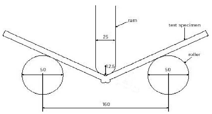

A typical bend test, such as the one defined in EN 12814-1, uses a parallel-sided test specimen, an example of which is shown in Figure 3. This is then subjected to a three-point bend, as shown in Figure 4. In this standard, the tests are performed at room temperature, using a ram displacement velocity of 50mm/min. The ram displacement or bend angle at which either fracture occurs or a crack appears is measured.
Fig. 3 Typical geometry and dimensions of bend test specimen, as defined in EN 12814-1
Fig. 4 Schematic diagram of bend test as defined in EN 12814-1

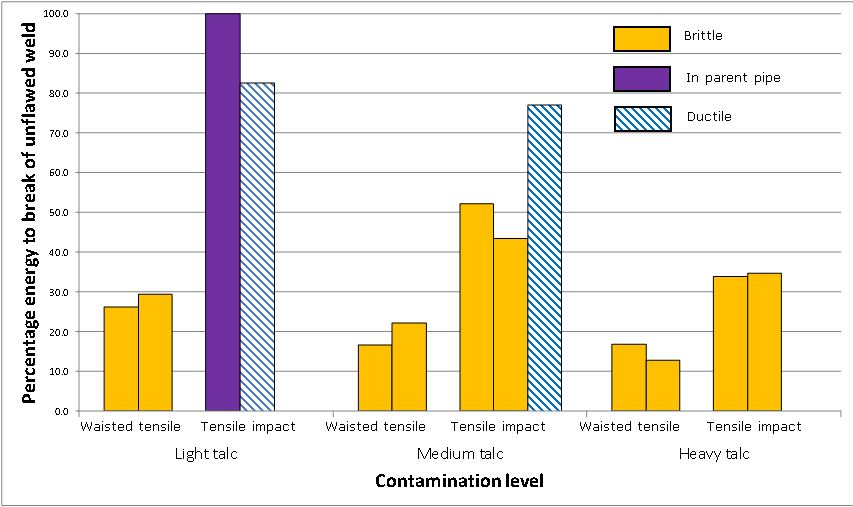

Figure 20 shows that, for the 180mm SDR17 PE80 pipe, even light loadings of fine particulate resulted in a reduction in the energy to break the waisted tensile test specimens by around 70% compared to unflawed joints. This increased to around 90% for higher loadings of talc. In addition, all of the contaminated joints failed in a brittle manner, whereas the unflawed joints all failed in a ductile manner. The results for the high speed tensile impact tests, however, showed that, even with a heavy loading of talc, the specimens still failed in the parent pipe; the energy to break values compared to those for the unflawed joints were related to variations in the parent material properties, not the joint properties. Unfortunately, it was not possible to cut high speed tensile impact test specimens from the joint containing a light loading of talc. However, it would be expected that these would also fail in the parent pipe.
Fig. 19 Failure modes for high speed tensile impact test: a) in parent pipe, b) ductile, c) mixed and d) brittle
Fig. 20 Energy to break waisted tensile test and high speed impact test specimens from talc-contaminated butt fusion joints in 180mm SDR17 PE80 pipe as a percentage of energy to break specimens from unflawed joints
