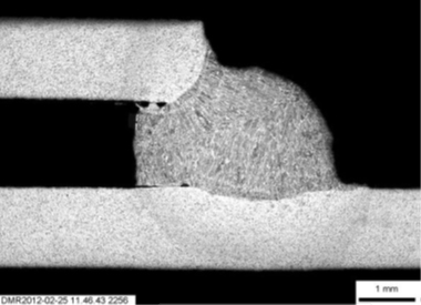

However, recent work on lap joints at TWI ( Melton, 2012) has shown that the weld bead  suffer from poor wettablity , are often peaky and that the gap bridgeability between sheets was not improved compared to conventional dip transfer, see Figure 5. It is believed that these processes would be more widely adopted with process improvements and increased education on process optimisation by for example selection of the best shielding gas.
Figure 5 -Typical weld bead with a controlled short circuit welding process

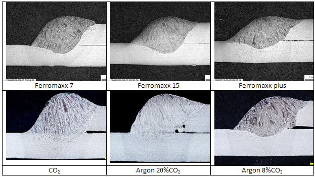

Welds were assessed in accordance with BSEN ISO 5817:2007 for visual appearance, geometry, penetration. Macrosections of welds for each shielding gas made at a travel speed of 1m/min are shown in Figure 7.
Figure 7 - Macro-sections of lap welds for each gas at a travel speed of 1 m/min
For a CO2 shielding gas the welds made at a travel speed of 0.75 and 1 m/min without voltage correction (programme 182 for CO2) had an irregular bead shape and a peaky profile with excess reinforcement. Penetration into the bottom plate was low.
Argon - 20% CO2  produced welds with greater penetration and a flatter profile but there was a tendency to undercut on the top edge for most welds. Also, although the
profile of the welds appears good in section and similar to those welds produced using Ferromax Plus, the weld bead is very irregular compared to that achieved with Ferromax Plus
Argon – 8% CO2  produced cold peaky weld beads which for some settings were quite irregular . For a travel speed of 1.0m/min, voltage adjustment resulted in either a peak bead or undercut with low penetration. An improvement in bead shape was obtained by reducing the travel speed to 0.75m/min, with no voltage trim but the bead was still slightly peaky  although smooth and consistent with good wetting at the toes.
With Ferromaxx 7 shielding gas (using programme 191) the best results were obtained with a voltage correction of +1V. The weld bead was observed to be cold and peaky, but less so than with CO2. In places, some undercut was observed, although the bead was generally regular.
Improvements were obtained with Ferromax 15  which at a voltage trim of +1V produced a weld bead with a flatter profile and good wetting at the toes. Occasional undercut was noted on the top edge, but generally weld profile and consistency was improved.
With Ferromaxx Plus the bead shape improved dramatically with an increase in voltage trim to +3V. These welds exhibit a wider and smoother profile with good wetting at the toes. The best results were obtained at a travel speed of 1.0m/min at the higher travel speed of 1.25 m/min slight undercut was observed and the appearance of small root imperfections. Reducing the voltage to +2V resulted in a smoother weld profile with less ripple.
Overall the best results were achieved with Ferromax Plus with a voltage trim of +2 to +3 volts.
