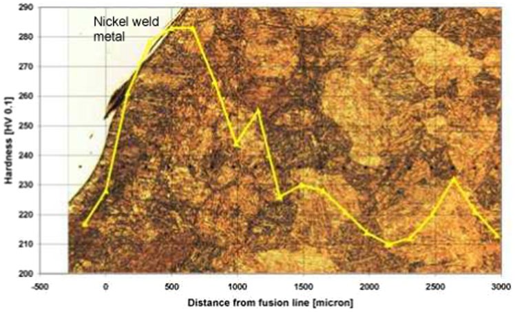

Weld repairs carried out in Swedish power plant have been reviewed by Storesund and Samuelson.152 Most of the repairs were to 0•5Cr–0•5Mo–0•25V steel, but some involved repairs related to service-induced damage in dissimilar welds between low alloy and 12%Cr steels. No repairs were found in pipework of 9–12%Cr steels. They gave the following recommendations relating to repair welding:
(i) avoid welding procedures that may cause a strongly creep soft HAZ. The HAZ will always have a creep-soft part (the fine-grained and intercritical parts). That part, as well as the whole HAZ, will be wider with increasing heat input. A wider HAZ decreases the creep strength of the weld. Coarsening of carbides may be more pronounced during the weld thermal cycle with higher heat input, particularly in the HAZ. The coarsening of carbides results in lower creep strength, so the use of a heat input as low as practically possible is recommended. To avoid wide HAZs, it is also recommended to use interpass temperatures of #300uC. (Higher than 250uC would be more appropriate for 9%Cr steels.)
(ii) select design solutions that minimise system stresses as (even) small system stresses reduce the creep life of weldments significantly. If the repair was not dictated by the presence of appreciable system stresses, it is very important to reduce or eliminate these
(iii) select materials for weld repair that are somewhat overmatched (creep strong) in relation to the remaining service-exposedmaterial. Hardness testing, replica testing or the extraction of boat samples, service data and chemical analysis give understanding of the creep strain resistance in the aged material. New weld metal should be tested corresponding to an ordinary weld test. These investigations will help selection of weld repair material and procedure. Typically a new weld metal of the same material as the service-exposed ones will give a strongly overmatched repair
(iv) wide and medium deep geometry of the excavation is optimal for the lifetime of a weld repair. Deeper or full repairs are, however, necessary if cracks, microcracks or creep cavities are present deep in the material. Repair of at least the whole width of the original weld, including the HAZs is always recommended, even if the damage is local, such as cracks in the HAZ only at one side of the weld.
Table 4 Summary of the advantages and disadvantages of the use of ferritic and Ni-based consumables for repair
welding150
Ferritic Nickel-based
Advantages Advantages
Minimal material discontinuity Lower residual stress
Ultrasonic inspectability Intrinsic resistance to hydrogen-assisted cracking
