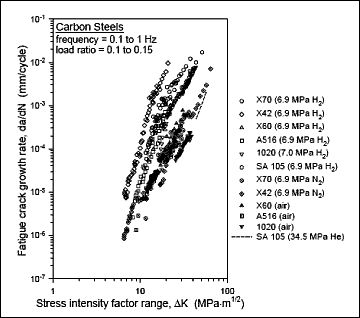

The fatigue crack growth rates in hydrogen environment, when compared with those in air, were generally found to be accelerated. The extent of acceleration depends on many factors as described below.
Influence of ΔK magnitude
The acceleration of crack propagation rates in hydrogen environment was found to be more pronounced at high ΔK.[7,8] This can be seen in Figure 2 based on the review by Somerday et al.[9] At ΔK values near the threshold stress intensity factor range, ΔKth, the effect of hydrogen environment on crack growth or on ΔKth was not evident. Similar observations were also reported in the tests carried out at R=0.05 on the specimens pre-exposed to hydrogen environment.[10,11] They attributed this behaviour to the mutually offsetting effects of environmental damage and a local reduction in crack driving force from a crack closure related mechanism, resulting in crack growth rates in low ΔK ranges and ΔKth insensitive to hydrogen environment.
Fig.2. Influence of ΔK magnitudes on the acceleration of fatigue crack growth rates in hydrogen environment.[9]
Fig.2. Influence of ΔK magnitudes on the acceleration of fatigue crack growth rates in hydrogen environment. [9]
However, in the work carried out by Suresh and Ritchie,[12] the fatigue crack growth rates in dry hydrogen were found to be accelerated not only in the high ΔK regime, but also near the threshold. They carried out fatigue crack growth tests in both air and hydrogen environment for four pressure vessel steels, with yield strengths ranging from 290 to 770MPa. The compact tension (CT) specimens were tested at cyclic frequencies ranging from 0.5 to 50Hz, stress ratio R from 0.05 to 0.75, and at hydrogen pressures of 0.138 and 6.9MPa. The tests in hydrogen were carried out in an environmental chamber at ambient temperature. It was reported that the crack growth rates in dry hydrogen were accelerated, when compared with the data obtained in air, in two distinct regimes, namely at ΔK> 632N/mm3/2 (20MPa √m) and near the threshold (ΔKth was defined as a growth rate of 10-8mm/cycle in this investigation) at low load ratios. Little effect of hydrogen near ΔKth was seen at high R ratio (R=0.75). The acceleration of crack growth rates in the high growth rate regime, typically > 10-5 mm/cycle, was attributed to the HE mechanism, while the enhanced crack growth rates near ΔKth was assumed to be associated primarily to the dry, oxygen free environment, which minimizes the decelerating effect of oxide-induced crack closure. The degradation of the near-threshold fatigue properties of a low strength C-Mn steel in hydrogen gas was also reported by Wachob and Nelson. [13]
It is not clear why there were conflicting test results with respect to the hydrogen effect on fatigue crack growth rates near the threshold regime. It appears that, to observe the degraded crack growth resistance near the threshold regime, the crack growth rates must be sufficiently low and the hydrogen gas must be kept dry to avoid any crack closure related mechanism.

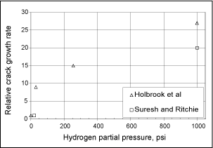

Effect of hydrogen pressure
Fatigue crack growth rates were found to increase with increasing hydrogen pressure. Holbrook et al[7] carried out fatigue crack growth tests on X42 pipeline steel at several different hydrogen partial pressures, ranging from 0 (1000psi nitrogen), 30, 250 to 1000psi. All tests were conducted at a constant ΔK of 695N/mm3/2, R=0.25 and a loading frequency of 0.1Hz. The detrimental effect of hydrogen on fatigue crack growth rates increased with increasing hydrogen partial pressure, Figure 3. Based on the test results, the following relation was proposed[7] to describe the effect of hydrogen pressure on the accelerated fatigue crack growth rates:
[1]
where PH2 is absolute hydrogen pressure in psi. The weak pressure dependence described by Equation [1] suggests that no catastrophic increases in fatigue crack growth should occur at some threshold pressure. The maximum design hydrogen pressure for boilers and pressure vessels is defined by ASME[14] to be 15,000psi (103MPa). According to Equation [1], this corresponds to an increase of crack growth rate by a factor of 71 when compared to that in air.
Fig.3. Effect of hydrogen partial pressure on fatigue crack growth rate when compared to that in air, ΔK=695N/mm3/2. The stress ratio R used in the tests was 0.25 by Holbrook et al[7] and 0.15 by Suresh and Ritchie [12]
It seems that 100psi hydrogen partial pressure is the 'tipping point' for increased concern on the part of regulators and the public perspective. This pressure is commonly defined as the threshold for high pressure hydrogen service by Chevron Company.[15] However, it can be seen from Figure 3 that a significant acceleration in crack growth rate, by a factor of about 9, was evident at a hydrogen partial pressure as low as 30psi.
Suresh and Ritchie[12] investigated the fatigue crack growth rates of a pressure vessel steel (A516-70) at two different partial pressures: 20psi and 1000psi. They found that the fatigue crack growth rates at the higher hydrogen partial pressure increased by about 20 times when compared with those obtained at the lower partial pressure, Figure 3.

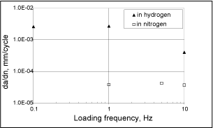

Effect of loading frequency
Fatigue crack growth rates in hydrogen were generally found to increase with decreasing cyclic loading frequency.[16,7,12,17] Holbrook et al[7] conducted crack growth rate tests on X42 steel in hydrogen gas at several different loading frequencies, all at a constant ΔK of 626N/mm3/2. While the loading frequency in nitrogen did not have noticeable effect on the fatigue crack growth rates, it did in hydrogen, Figure 4. A stronger effect of loading frequency on fatigue crack growth rates was reported by Walter and Chandler[16] in SA 105 steel and by Lindley et al[17] in 1%CrMo steel. The fatigue crack growth rate increased by a factor of ~5 as frequency decreased from 1 to 0.001Hz[16] and about one order as frequency decreased from 10Hz to 0.1Hz[17] in the high ΔK regime. This was expected since, when the maximum applied stress intensity factor, Kmax, exceeded the subcritical crack growth threshold, a crack can even grow under a high static load in hydrogen environment. Therefore, a slower loading frequency at high ΔK regime would allow a longer period for crack growth in one cycle, resulting in higher fatigue crack growth rate. In the near threshold regime, however, the fatigue crack growth data in hydrogen at cyclic frequencies of 5 and 50Hz coincided,[12] which did not suggest a noticeable effect of loading frequency near the threshold regime.
Fig.4. Effect of loading frequency on fatigue crack growth rates in hydrogen and nitrogen gases, ΔK=626N/mm3/2, 1,000 partial pressure, R=0.25[7]
Fig.4. Effect of loading frequency on fatigue crack growth rates in hydrogen and nitrogen gases, ΔK=626N/mm3/2, 1,000 partial pressure, R=0.25 [7]

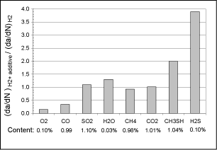

Effect of gas composition
During the fatigue tests carried out in Battelle Laboratories,[7] it was found that the crack growth rates of some specimens tested in gaseous hydrogen were similar to those obtained in air. The subsequent analysis of the gas composition suggested that the gas had been contaminated by oxygen during the fatigue tests, resulting in retarded crack growth. The repeat tests carried out later, with strict control of the gas composition, all exhibited acceleration in fatigue crack growth rates in hydrogen, different from the first test result.
The effect of additives to hydrogen gas on fatigue crack growth was comprehensively investigated by Fukuyama et al.[8] The fatigue crack growth rates of 2.25Cr-1Mo steel in hydrogen with small amounts of different additives were determined at a constant ΔK of 758N/mm3/2 and a hydrogen gas pressure of 1.1MPa. The results are shown in Figure 5. It will be seen that, compared with the crack growth rate in pure hydrogen gas, addition of O2 and CO gas to hydrogen retarded the fatigue crack growth rates, while addition of H2S clearly accelerated the fatigue crack growth rates. In the near threshold regime, Suresh and Ritchie[12] found that the crack growth behaviour in moist hydrogen gas was essentially similar to that in air - hydrogen did not exhibit detrimental effect on fatigue crack growth rates in the low growth regime.
Fig.5. Effect of additives to hydrogen gas on fatigue crack growth rates[8]
Fig.5. Effect of additives to hydrogen gas on fatigue crack growth rates [8]
Therefore, it is essential strictly to control the hydrogen gas composition during fatigue tests to determine the effect of hydrogen. On the other hand, it is possible that the detrimental effect of hydrogen can be reduced or even avoided by 'contaminating' hydrogen gas with some additives. This is an area which attracts increasing research interests.[8,18]
