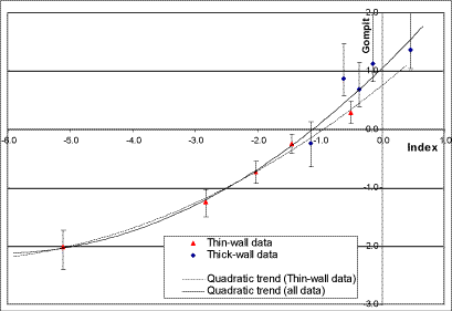

Schneider and Georgiou, [9] for instance, studied the relationship between the POD p of welding flaws inspected by radiography and an 'index of detectability' I theory , which had been adapted from earlier deterministic models of radiographic detectability. [10-12] The index of detectability depends on IQI sensitivity, radiographic unsharpness, flaw orientation and flaw gape as well as through wall extent (TWE). It was found that a 'quadratic gompit' model fitted the experimental data better than models (such as the log-odds model) based on the logit function. The fitted model took the form:
(1)
where the coefficients A, B and C were estimated from the experimental data, by means of logistic regression. [13]
The model is illustrated in Figure 1. Statistical software-based tests [14] can help to confirm that the model gives an adequate fit to the data. This case study also illustrates how deterministic models can help in the identification of suitable statistical models for the detectability of flaws.
Fig. 1. Plots of estimated gompit function against index of detectability

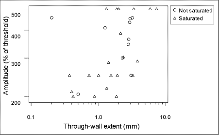

Figure 2 shows the results of trials of a system for the automated ultrasonic testing (AUT) of pipeline girth welds. The pipeline operator wished to qualify the inspection to detect planar manufacturing flaws of 2mm TWE with 90% POD with 95% confidence. A total of 31 such flaws were deliberately introduced into four test welds. Figure 2 gives the maximum amplitudes recorded by the system, and shows that all 31 flaws were detected. Data shown as 'saturated' lie at an indeterminate value above the plotted amplitude. These points do not all lie at the same amplitude because different saturation limits applied to different channels of the AUT system. These data points are examples of 'censored' data.
Fig. 2. AUT response versus size data for planar flaws in pipeline welds
29 of the flaws are less than 4mm in TWE, so the methodology of Section 2.1.1 can be used to demonstrate, with 95% confidence, that flaws of 4mm TWE are detected with 90% POD. But this method cannot be used to establish 90% POD with 95% confidence for flaws smaller than 4mm, even though all 31 flaws gave signal amplitudes more than 6dB above the inspection threshold. Moreover, the methodology of Section 2.1.2 cannot be used; since there are no non-detections, it is impossible to establish a functional dependence of POD on TWE. The usual method [1,8] of dealing with such data is to assume a relationship of the form:
log S = A + B log h    (2)
where S is signal amplitude and h is through-wall extent.

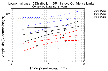

Figure 3 shows the regression line (the central solid line) fitted through the response versus size data of Figure 2 by the method of Maximum Likelihood. The Maximum Likelihood method properly accounts for the saturated data. [1] In a quite fundamental sense, it provides estimates of the slope and intercept of the regression line (and the spread of data about this line) that maximise the likelihood of obtaining the observed data. In this sense, the resulting estimates are those that agree most closely with the observed data. Figure 3 plots the 'exact' data only (where the signal was not saturated) even though the saturated data is taken into account in estimating the position of the regression line. This is why the regression line does not lie centrally among the data points. Figure 3 also shows estimates of the 10 th and 90 th percentiles of the distribution of signal amplitudes about the regression line, which correspond to the threshold levels that are needed to achieve 90% POD and 10% POD respectively. The centrally positioned straight lines are the best estimates of the percentiles, whereas the curved lines correspond to one-sided 95% confidence limits on these percentiles. [14] The lowest dashed curve indicates that flaws of 2mm TWE are detected well above the inspection threshold with a POD of 90%, with 95% confidence.
Fig. 3. Regression analysis of response versus size data from Figure 2
It should be noted that regression analysis does not always give reliable estimates outside the range of the measured data; there is, after all, no way of assessing whether the same linear relationship applies outside these limits. However, regression is considered to be reasonably reliable close to the mean of the data, even if the relationship between the two variates is not precisely linear. Fortunately, in the above case study, there is a concentration of data around a TWE of about 2mm, so the predictions are considered to be reasonably reliable for flaws of this size. As in the previous case study, statistical software-based tests [14] can help to confirm that equation (2) gives an adequate fit to the data.

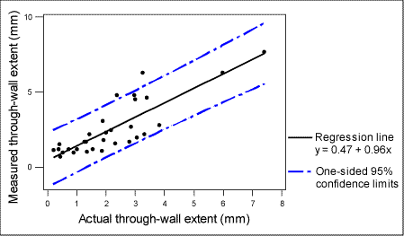

Sizing errors are usually assessed by comparing the maximum size of a flaw reported by the NDT with the true maximum TWE of the flaw (as determined by sectioning), since this is generally the key dimension in determining the fracture resistance of the weld. It is usually assumed that ultrasonic sizing errors are normally distributed. [15] This means that confidence limits for sizing errors can be estimated by ordinary linear regression.
Figure 4 illustrates AUT sizing data for the same 31 flaws considered in Section 2.2. The lower dashed curve, for instance, indicates that flaws of 4mm TWE will, with 95% confidence, have a measured TWE of at least 2.5mm. This information can be used to base acceptance criteria on fitness for purpose principles. Suppose, in the above example, an Engineering Critical Assessment (ECA) shows that the pipeline can tolerate flaws larger than 4mm TWE. Then an acceptance criterion based on 95% reliability will require rejection of all welds containing flaws having a measured TWE larger than 2.5mm.
Fig. 4. AUT flaw sizes versus sizes determined by sectioning
For many applications, it can be assumed that the sizing errors do not vary with flaw size. [15] This effectively forces a slope of one on to the regression line, and yields confidence limits that are parallel to the regression line. The confidence limits can then be estimated from the mean and standard deviation of the sizing errors as percentage points of Student's t distribution (obtained from standard statistical tables, e.g. Ref. [16] ).
