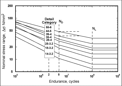

3.3.1 Design S-N curves
All the fatigue design specifications for welded aluminium alloys present a series of S-N curves for particular weld details, with a classification scheme linking a description of the welded joint with the appropriate design curve. Examples of the S-N curves provided are shown in Fig.5. The classification usually depends on the joint type, geometry, loading direction and mode of fatigue failure, as illustrated for one group of joint types in Eurocode 9 in Fig.2. Rather less comprehensive guidance is given by the Aluminum Association [4] which only refers to joint types and loading direction. The S-N curves are derived from linear regression analysis of log S versus log N fatigue data to establish mean curves and statistical lower bound, usually mean - 2 standard deviations of log N. The S-N curves have the form:
S m N=A, where A and m are constants.
Fig.5a) Aluminum Association [4]
Fig.5b) IIW [3]
Fig.5c) Eurocode 9 [7]
Fig.5. Examples of fatigue design S-N curves for aluminium alloys in recent specifications
Fig.6. Eurocode 9 [7] allowance for reduction in fatigue strength due to marine corrosion
The curves are assumed to extend up to stress levels corresponding to the static design limit for the material, and down to a fatigue endurance limit. A constant amplitude fatigue endurance limit is introduced at an endurance of 5x10 6 cycles in all the aluminium specifications. Two basic approaches have been used to define the design S-N curves:
(a) An arbitrary grid of S-N curves, usually equally spaced on log-log scales, is defined and the curve closest to the selected lower bound to experimental data of a particular detail is allocated to that detail. The IIW Recommendations [3] are based on this approach with the S-N curves defined in terms of the stress range in N/mm 2 at 2x10 6 cycles (See Fig.7(a)).
(b) The design S-N curves are derived directly from experimental data. In some cases, the fatigue lives of different details are so similar that the experimental data can be combined to produce a single class for all of them. The resulting S-N curves, which are not usually equally spaced, may be described in terms of the fatigue strength at 2x10 6 cycles, and possibly the slope m of the S-N curve as in draft Eurocode 9 [2] , or by arbitrary letters such as Class A, B, C, etc, in the Aluminum Association's specification [4] (see Fig.5(b) and (c)).

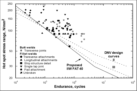

3.3.6 Hot-spot stress approach
Only the DNV note [6] gives specific guidance on the use of the hot-spot stress fatigue design procedure. That guidance is related to four S-N curves from the ECCS [7] recommendations, one for unwelded material, two for welded connections and the fourth for welds exposed to a corrosive environment (presumably sea-water). The corresponding ECCS design curves are as follows:
DNV ClassMaterialECCS S-N curve
I Unwelded Unwelded high strength 7020 alloy
II Welded Flush ground butt welds
III Welded As-welded transverse butt welds with good profile
IV Welded, in corrosive environment Not included: 25% reduction in design stress from Class III curve
Thus, for as-welded joints it is assumed that the butt weld design S-N curve is applicable to both butt and fillet welds if the hot-spot stress is used. The reason for the choice of the S-N curve for the highest strength of unwelded aluminium alloy (lower curves were provided for other aluminium alloys) is not known. The corresponding S-N curves in Eurocode 9 are lower than those in the ECCS rules.
The curves are used in conjunction with specified stress concentration factors, K, by which stress ranges obtained from the specified design curve are divided, for a variety of typical welded connections used in ships. The range is not totally comprehensive and, as will be seen later, no guidance is offered for some relevant details.

Limited data presented in terms of hot-spot stress range are also available and these will be used to assess the proposed hot-spot stress S-N curves. Finally, some data have been obtained under variable amplitude loading. These will be used to assess the validity of Miner's rule and the methods proposed to modify the S-N curve below the constant amplitude fatigue limit to take account of the damaging effect of low stresses. The variable amplitude fatigue data will be considered in terms of the equivalent constant amplitude stress range, calculated on the basis that Miner's rule is correct using the constant amplitude S-N data obtained in the same investigation. This equivalent stress range is as follows:

Finally, in order to assess the DNV hot-spot stress S-N curves [6] mentioned earlier, they are included in Fig.15. As will be seen, both curves look reasonable. However, it should be mentioned that many of the results in Fig.16, virtually all those for 24mm thick specimens, lie below curve III, suggesting that the thickness effect correction should be introduced at a lower value than that currently specified (i.e. 25mm) in the DNV note.
