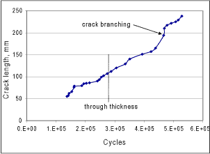

Fig.8. Primary through-thickness crack growth of 914mm diameter T joint under axial loading [7]

Compared at the same HSS range, the crack growth rate under axial loading was often found to be faster than that under OPB loading. This can be seen from Figure 11 which compares the crack growths of four specimens in K/KTjoints at a similar HSS range of ~190MPa, two under axial and two under OPB loading. It demonstrates that, under OPB loading, the crack growth rates were slower and the remaining lives of through-thickness cracks, as indicated by the ratio N/N3 at the end of the test, were longer. In one test under OPB loading, the primary crack branched away from the weld toe into the chord soon after it penetrated through the chord thickness. There was no secondary cracking involved during the crack propagation. The crack growth rate decreased as it grew far into the chord, see Figure 12, and even stopped growing when the actuator reached its limit.[6] The test was finally terminated. The development of this crack is schematically shown in Figure 13.
