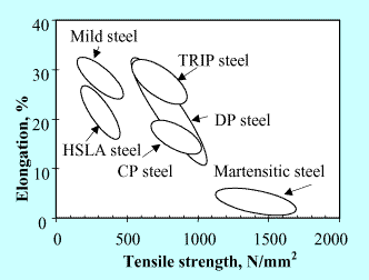

2. High strength steels for automotive applications
High strength steels obtain their strength from grain refining, solution strengthening, transformation hardening and precipitation strengthening. Transformation hardened steels are the most recently developed type. These use relatively high levels of carbon and manganese, together with heat treatment to increase their strength. The finished product has a duplex microstructure of ferrite with varying levels of martensite. A great increase in the availability and application of HS steels that can meet the requirements of the automotive industry has occurred in the last 20 years. These include transformation induced plasticity steel (TRIP), dual phase steels (DP), complex phase (CP) and martensitic steels, with tensile strengths up to 1400N/mm 2. [1-4] Fig.1 compares the tensile strength and elongation of these and other steel types.
Fig.1. Tensile strength and elongation of high strength steels
DP steel is a class of HS steel having a microstructure of soft ferrite and, depending on strength, between 20 and 70% volume fraction of hard phases, normally martensite. The soft ferrite phase is generally continuous, giving these steels good formability and ductility. When these steels are deformed, strain is concentrated in the lower strength ferrite phase, creating the unique high work hardening rate exhibited by these steels. DP steels are designed to provide a tensile strength up to 1000N/mm 2. Strengthening in DP steels is achieved by a combination of grain refinement and the formation of hard martensite, and they can be produced by either hot or cold rolling. The strength level is controlled by the amount of martensite in the steel, as well as the heat treatment during processing.
TRIP (Transformation Induced Plasticity) steels have become of considerable interest in recent years because of their exceptional combination of high strength and ductility. The microstructure in TRIP steels is composed of ferrite, bainite, martensite and a large volume fraction of retained austenite. TRIP steels have a higher carbon content than DP steels, together with silicon and/or aluminium to lower the martensite finish temperature to below ambient temperature, in order to retain the austenite phase. The retained austenite transforms into martensite during subsequent deformation, and provides excellent formability for manufacturing complex parts. In addition, high work hardening during crash deformation, for example, provides excellent energy absorption. TRIP steels are suitable for complex structural parts demanding high strength and automotive parts with good crash resistance.
Complex phase (CP) steels consist of a very fine microstructure of ferrite, bainite, martensite, carbide precipitates and retained austenite. These steels use many of the same alloy elements found in DP and TRIP steels, but additionally have small quantities of niobium or titanium to form fine strengthening precipitates. CP steels have tensile strengths of 800N/mm 2 and above, and are characterised by high deformability, high energy absorption, and high residual deformation capacity. Typical candidate applications for CP steels are those that require high energy absorption capacity in the elastic and low plastic range, such as bumper and B-pillar reinforcements.
In martensitic steels, the austenite that exists during hot rolling is transformed almost entirely to martensite during fast cooling on the run-out table. Martensitic steels are based on a low carbon with several alloying element additions. Martensitic steels can provide very high strength (up to 1550N/mm 2) and relatively good formability due to high strain hardening. Martensitic steels are often subjected to post-quench tempering to improve ductility, and can provide reasonable formability, even at extremely high strength. Typical candidate applications for martensitic steels are wheel discs, chassis parts and body reinforcements.

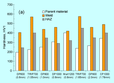

3.2. Weld Hardening and HAZ Softening
High strength steels usually have a higher hardenability than for low carbon steels because of the increased level of carbon and alloying elements. When these hardenable steels are resistance spot welded using conventional settings, the subsequent rapid cooling from the quenching effect of the electrodes in contact with the sheet surface produces a weld with a brittle martensitic structure. [5-8] Such a weld fails more easily across the interface between the sheets, in a brittle manner, when tested in peel or tension. [7] This may lead to a reduction in tensile strength and impact performance of the joint, and possible cracking of the weld.
The weld and HAZ hardening is mainly dependent on the composition of the parent steel. Carbon strongly affects the hardness of martensite, so increasing carbon content leads to an increasing susceptibility to cleavage fracture. TRIP steels have a higher carbon content than the other types of HS steel, giving a higher weld hardness (see Fig.2a). The alloying elements that increase the hardenability of steels, such as manganese, also significantly increase the weld hardness of HS steels.
The sheet thickness also has an influence on the hardening behaviour. Whilst the thicker sheet promotes greater quenching and hardening in arc welds, the opposite is the case for spot welds, where the cooling is provided principally by the water cooled electrodes, and thinner sheets can be more sensitive to hardening.

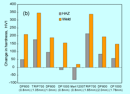

In general, the weld hardness level for most of the HS steels of ≥ 600N/mm 2 is above 400HV as shown in Fig.2a, and this is much higher than low carbon and lower strength HS steels.
The hardness profile of HS steel welds, which is related to the metallurgical characteristics of the steel and welding conditions used, can have a significant influence on the weld properties. Generally, a fully hardened weld and HAZ is obtained in HS steels having a tensile strength below 1000N/mm 2. However, a fully hardened weld but softened HAZ is produced in HS steels with a tensile strength above 1000 N/mm 2, as shown in Fig.2b for the high strength DP and martensitic steels.
Fig.2. Weld hardening and HAZ softening of spot welds (5 √t diameter) for different HS steels welded using 4kN force, 10-12 cycles welding time and 10 cycle hold time: Fig.2a) Hardness of weld metal and HAZ
Fig.2b) Weld hardening and HAZ softening
As the applied load on a weld concentrates the stress on the notch at the edge of the weld at the sheet interface, this can cause fracture across the interface microstructure with low ductility. If HAZ softening occurs, this may allow the fracture to propagate through the sheet thickness, giving the preferred plug failure. This softened HAZ may, therefore, improve the overall ductility of the weld, but its response to early local necking under tensile loading could possibly limit the strength of the weld. Thus, the joint strength depends on the relative strength of the weld and HAZ.

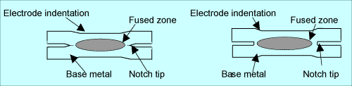

3.3. High Susceptibility to Partial Plug or Interface Fracture
Plug failure is normally required on peel or chisel testing in most automotive standards, as it demonstrates weld toughness and is a reliable method of checking weld diameter. It is more difficult to achieve this mode of fracture in higher strength steels, compared to low carbon steels. The reason lies in the predominant occurrence of interface failure and partial plug failure under static tests, which reduces the weldability lobe to an unacceptable value, according to some standards. This is particularly true for steel grades exhibiting the highest values of carbon equivalent such as TRIP steels.
The high susceptibility to interface fracture of the welds in HS steels is related to their hard and brittle microstructure, which exhibits high notch sensitivity. [5,9-11] In the case of sharp notches at the edge of the weld (see Fig.3a), the stress concentration in front of the notch tip is very high, leading to the preferential occurrence of the interface failure mode. On the contrary, for square morphologies ( Fig.3b), stress concentration is reduced. Moreover, the maximum stresses are located at the corners of notches, away from the interfaces. Cracks initiate principally at these corners and propagate directly within the HAZ towards the sheet interface giving a full plug failure. [5]
Fig.3. Schematic illustration of the notch geometry of resistance spot welds: a) Sharp notch tip b) Square notch tip
The notch morphology of welds for given materials mainly depends on the electrode force and welding current. Lower electrode forces will not allow the molten and heated metals to be forged sufficiently, leading to formation of sharp notches. Misalignment of electrodes will also cause problems. For HS steel, a sharp notch is more likely to be produced due a greater resistance to deformation. The notch geometry can be possibly changed from sharp to square by increasing both the electrode force and welding current, and hence, weld size. However, it may be difficult to control notch shape reliably under production conditions.
For most HS steel welds, the presence of hard martensite essentially allows easier propagation of cracks and more readily generates interface failures. [12] The joint geometry, in terms of the weld diameter to sheet thickness ratio, also affects the fracture appearance of welds. For a low ratio, stress concentrations at the edge of the weld are high and weld cracking can initiate. A high ratio reduces the degree of stress concentration at the weld edge and can promote plug failure through the HAZ, [12] rather than interfacial failure through the weld. Consequently, larger than normal weld sizes are sometimes suggested for HS steels.
