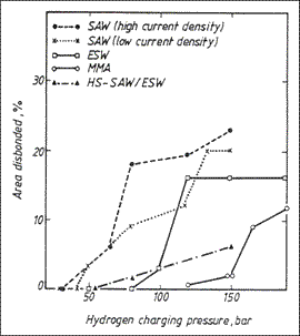

Several investigators have reported on studies of the effect of welding variables on susceptibility to disbonding, primarily in relation to high temperature hydrogen service. [1-6,13] Gittos et al [13] demonstrated that manual metal arc cladding was more resistant than high deposition rate processes, such as submerged-arc strip cladding and electroslag cladding (Fig.1), although the latter was better than the former. The main difference between the processes that was concluded to have played a role was the geometry of the interface: the manual metal arc interface was much more irregular than that of the high deposition processes, possibly contributing to restriction of lateral crack extension. Both the work of Gittos et al [13] and by Sakai et al [5] demonstrated that Ni-Cr alloy deposits were more resistant to disbonding than austenitic stainless steel deposits (Fig.2).
Fig.1. Hydrogen disbonding test results showing the effects of different welding processes using type 309L/347 stainless steel combinations [13]

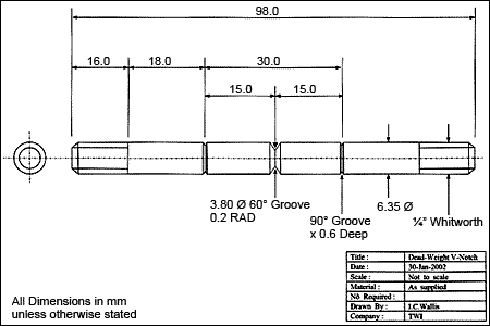

Testing Range of tests. In the course of test development, three basic designs of test specimen were employed. These comprised slow strain rate tensile, constant and rising load notched tensile and square-section bend with EDM notches. The specimen geometries are given in Fig.4. The notches in the tensile specimens were cut such that the buttering weld interface was 'slightly inclined' to the notch. This angle was measured on a metallographic section to be 3°. The application of these tests is described in the succeeding sections.
Fig.4. Test specimen geometries:
a) Slow strain rate tensile
 b) Constant load/staircase load notched tensile

Notched tensile tests. Initially, a series of rising ('staircase') loading tests, with holding periods of three days, was carried out. The results were used to define loading conditions for sustained load tests. The samples were tested in seawater at ambient temperature under cathodic protection at -1100 mV SCE . No pre-charging under cathodic protection was performed prior to loading. The samples were held at constant load for three days before raising the stress to 80% of the 'cross-weld proof stress'. The load was increased every three days until fracture occurred.
The first alloy 625 sample failed at the notch location at a nominal stress of 981MPa (142ksi). The second alloy 625 sample, which was intended to be held at constant load for seven days, failed at a lower nominal stress of 927MPa(134ksi) within two hours of the commencement of the test. In the case of the alloy 725 sample, fracture occurred at a nominal stress of 995MPa (144ksi), but in the steel threaded region of the sample. The fractures exhibited regions of flat fracture of similar appearance to those observed in the slow strain rate tests, Fig.6.
