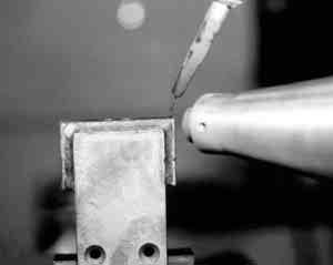

The specimens were held vertically in a vice (akin to the position they would take in the reactor pressure vessel, which can be seen in Figure 1). The welding head was positioned in relation to the workpiece as shown in Figure 3. All welding was performed in the vertical-up position. Filler wire, when used, was fed into the leading edge of the molten pool at an angle of approximately 60° to the laser head, using a MIG wire feeder system. In the repair procedure, an A18 mild steel MIG filler wire, 1.2 mm diameter, was used. A coaxial nozzle with a 20mm diameter outlet and 5mm stand-off distance, attached to the beam delivery system, was used to protect the weld zone from oxidation during processing. In addition, the coaxial nozzle was also used for plume control. Helium gas (at flow rates of 50 lpm) was used as the processing gas.
Fig.3: Position of the welding head and filler wire with respect to the sample
