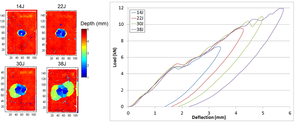

The panels were impact tested at four energy levels with an Instron Dynatup 9250HV Impact testing machine adhering to the D7136/D7136M standard(8) where applicable. Impact energies of 14, 22, 30 and 38J all resulted in a dent depth less than barely visible impact damage (BVID) level (0.3mm). Each energy level was repeated four times on four separate panels. The resulting impact damage was assessed using ultrasonic testing (UT) for all panels and computed tomography (CT) was undertaken on four panels containing damage from each impact energy for validation purposes.
UT was undertaken in a USL immersion tank with a 5MHz probe and a scanning increment of 1mm in the XY plane. Raw ultrasonic data in the form of A-scans at each inspection point were post-processed in matlab to produce time of flight (TOF) C-scans which illustrate delaminations detected at varying depths in the laminates. Examples of TOF C-scans for each impact energy can be seen in Figure 1 . The plotted colours correspond with the depth of the detection within the laminate. The TOF images provided evidence of the delamination pattern of propagation found in literature for impact damaged CFRP laminates(9). Specifically, the delaminations were observed to be oblong shaped, stretched in the direction of the fibre orientation of the ply immediately below, thus forming the ‘spiral staircase’ or helix shaped damage due to the stacking sequence. It is worth noting that any delamination that is located nearer to the transducer shadow those located further from it, because the ultrasonic beam is reflected from the uppermost delamination. Due to this shadow effect, only the part of the deeper delaminations not covered by those above can be detected.
Figure 1 TOF C-scans of impacted panels and load/deflection plots

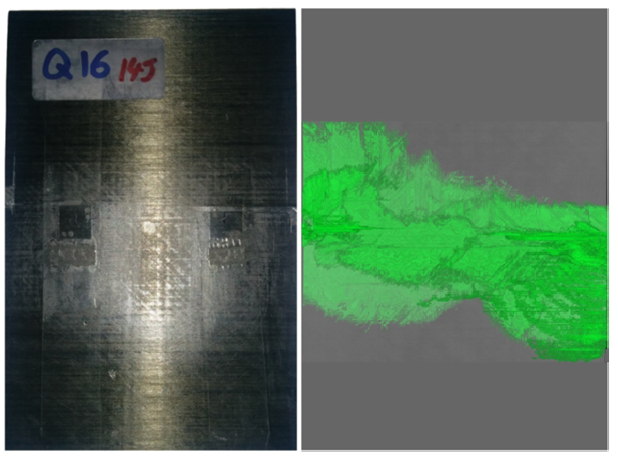

Figure 12 and Figure 13 use the 14J panel as an example of the experimental and simulated panel prior to CAI failure. It can be seen that there is good agreement between the failure location and extent of delamination propagation up until failure.

Figure 12 14J panel after CAI test (a) CT inspection of panel (b)
