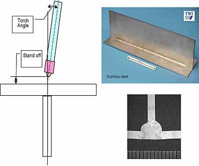

Keyhole plasma welding
The most significant difference between GTA and plasma welding lies in the ability of plasma welding to operate in the keyhole mode. Compared to GTA welding, the keyhole plasma welding technique has several advantages including deep penetration and high welding speeds. The keyhole plasma welding technique can penetrate stainless steel material thickness up to 10mm. However, despite the apparent advantages of the keyhole plasma technique, it has not been as widely exploited as the microplasma technique. In the past, several factors have discouraged its more widespread use, but these have been largely overcome in recent years as a result of welding equipment improvements, which can be summarised as follows:
  • Lower cost plasma welding equipment.
  • Improved design and reliability of plasma welding torches.
  • Improved control of welding parameters including plasma gas flow. This is necessary for closing the keyhole in pipe welds for example.
The deep penetration characteristics achievable with the keyhole plasma welding technique have been exploited to develop novel welding procedures for a range of alternative joint designs in 2.5mm thick austenitic stainless steel.These joint designs could not be easily welded with conventional GTA and GMA welding:
  • T-joints can be produced from the external side using a two pass sequence resulting in a fully fused weld with a reinforcement fillet on the internal side ( Fig.2). The level of distortion is also very low.
  • Full penetration stake welds in plates of 2.5mm thickness can be produced successfully from one side.
  • Similarly, edge lap welds can be made between overlapping 2.5mm thick plates, welding from either side of the joint.
  • Full penetration spot welds between overlapping 2.5mm thick plates can be made from one side.
These novel welding procedures offer the possibility of increased flexibility in the design and manufacture of thin sheet components. When using conventional GTA and GMA processes, the design of such components is influenced by the relatively high distortion associated with these processes and the access requirements needed for manufacture. Some of these limitations can be overcome by the use of the laser beam process, particularly with respect to the control of distortion. The present work has demonstrated that similar benefits (but to a lesser extent) can be accrued through the use of the keyhole plasma technique but with modest capital equipment costs and without the need for exacting joint fit-up.
Fig.2. Keyhole plasma welding of a T-joint in thin austenitic stainless steel to give full penetration welds
Courtesy of Rolls Royce

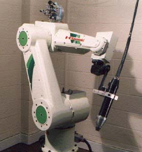

Two main types of laser have been used industrially for welding thick section steel - CO 2 gas lasers and Nd:YAG solid state lasers. CO 2 lasers generate light in the infrared regime at a wavelength of 10.6µm and are available at power levels up to about 45kW. The light is transmitted from the laser to the workpiece by a system of mirrors,before being focussed to a small spot for welding. This type of laser is now being used in European shipyards for different aspects of ship fabrication, where the reduced distortion enables the costs associated with rework to be dramatically reduced.
Nd:YAG lasers, in contrast, generate light at a wavelength of 1.06µm, which is also in the infrared regime, but can be transmitted by a fibre-optic cable. This is a major advantage, as it enables the complex set of mirrors used for the beam path of a CO 2 laser to be replaced by a simple fibre and welding head that can be mounted on a welding robot - Fig.7.
Fig.7. Nd:YAG welding head positioned in robot arm, showing fibre delivery capability
Advances in laser technology have led to rapid increases in the power available in Nd:YAG lasers and 4kW Nd:YAG lasers are now extensively used in production.
Recently, low power fibre lasers, which have been used in communications for many years, have been developed to the stage where power levels suitable for welding and cutting are available. The lasing medium is a Yb:YAG fibre and thewavelength of light emitted is 1070nm, very close to the Nd:YAG wavelength. Manufacturers claim that fibre lasers have better beam quality than Nd:YAG lasers of a similar power, enabling greater stand-off distances when welding.Additionally, wall plug efficiency is estimated to be between 20 and 30%, significantly greater than Nd:YAG or CO 2 sources; thus relatively low input power and reduced cooling is required. Fibre lasers are also smaller than Nd:YAG or CO 2 lasers of similar power.
Welding performance data for the fibre laser are now available (Verhaeghe 2005). In very broad terms, the results obtained when using a fibre laser are at least as good as those obtained from a comparable Nd:YAG laser. As greaterpowers and increased electrical efficiency are associated with the fibre, it is clear that this new laser source may have many industrial applications.
Laser welding using any source, however, is a very demanding process and tight control of fit-up and steel composition is required to produce welds of satisfactory quality and performance.
