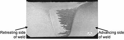

FSW butt-weld AA2017A-T451
Weld AA2017A-T451 was made using a rotation speed of 300rev/min and a traverse speed of 120mm/min. A macro photograph of the welding zone ( Fig.4) shows that a fully consolidated weld was produced.
The downforce required to weld this material was relatively high, 85kN, with a high torque of 240Nm. The recorded traverse force was 18kN and lateral force was 6kN. These values reduced as the weld approached the edge of the plate except for the lateral force, which showed a small increase. This could be due to heat reflecting at the plate edge. The high forces and torques generated during welding are due to the material properties as 2xxx alloys maintain significant strength at the welding temperature. With a parent material hardness of ~170Hv, the hardness in the heat affected zone reduced to ~120Hv ( Fig.5). The loss of hardness in the heat affected zone (HAZ) is typical of 2xxx welds made in thinner sections.
Fig.4. Macro photograph taken from weld AA2017-T451
