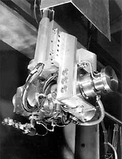

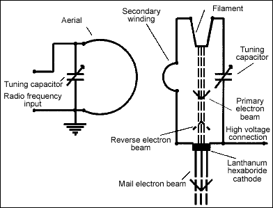

The heart of the development is the use of RF excitation in the gun cartridge (typically 84MHz) [6] . A single turn winding collects the RF power and produces a high current in a ribbon filament. Electrons are drawn from the filament every half cycle producing a beam that then heats the main cathode. This is shown in Fig.1. The innovation here requires only one cable connection to the high voltage supply so that a single core flexible cable can be employed. TWI uses this technology in its 150kV, 100kW guns and the gun can be housed in a 0.2 x 0.2 x 0.2m 3 cube. With a side entry high voltage cable termination, the overall gun column length is around 750mm, housing two focusing lenses, a high-speed deflection system, a TV camera and coaxial viewing system, and a DC current transformer. The gun is shown in Fig.2.
Fig.1. Circuit diagram and principles of operation of an RF excited filament and indirectly heated cathode
Fig.2. RF excited 150kV, 100kW in-chamber mobile gun - covers removed
Another facet of the development has been the change from a triode to a diode gun. Diodes do not surge in current if flashovers occur but instead the beam current is reduced. Thus they are to be preferred for reducing the risk of defects in high value added components. In addition, EB flashovers are best controlled by the use of switch mode power supplies. TWI pioneered their use in 1986 for high power EB welding (>100kW) and they have a number of advantages over alternative methods. In particular, the associated control equipment is independent of accelerating voltage and beam power, and the gun column is free of high voltage supply components.
In summary, RF excitation, diode guns and switch mode power supplies with flashover control, have been very significant advances in the last decade, enabling more compact and more reliable guns to be developed, delivering greatly enhanced beam quality.

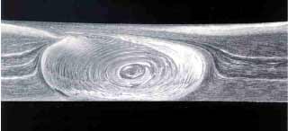

xperiments with these new tools have shown that for Al alloy plates of 25mm or greater, one pass welds can be made with excellent quality as shown in Fig.8(a). For example, with 6082 alloy, 25mm thick welds have been made at up to 250mm/min and 7075 alloy, 25mm thick welds at up to 60mm/min. In contrast, when using the same materials and thicknesses along with conventional threaded tools, welds were of very poor appearance and quality.
Fig.8. Cross sections of various friction stir welds (a) 7075 Al alloy, 25mm thick;
(b) Type 316 stainless steel, 5mm thick

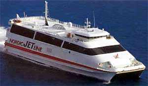

 Fig.9. Recent FSW applications (a) Decks in a high speed aluminium ferry;

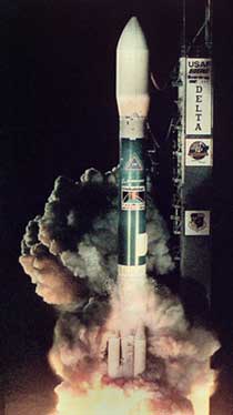

(b) Fuel tanks in recent Delta 2 rocket launched by NASA

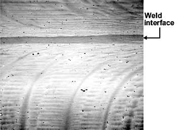

Whilst the idea of linear motion was patented in 1969 [13] the development of suitable machines for welding engineering size components only started just over a decade ago. A consortium of four British companies was formed in mid '80s led by TWI which designed and built prototype machines with a linear reciprocating mechanism. Based on an electromechanical system, the machines provided a reciprocating frequency of 5-75 Hz and a reciprocating amplitude of 0-±3mm, with a maximum axial welding force of 150kN. The process opens up new design and manufacturing possibilities for metals, and is capable of welding square and rectangular components in one shot with accurate alignment of parts. With appropriate tooling it can be used for more 'irregular' components such as turbine blades.
Early trials commenced with Ti-6Al-4V alloy Type 304 stainless steel, 6063 Al alloy and C-Mn steel and were successful in producing sound joints. Since then tooling has improved and section sizes of 20mm x 100mm are now possible. The process seems very well suited to the joining of intermetallics such as Ti aluminides [14] and successful welds can be made provided care is taken to control cooling rates.
To date, only the aircraft engine industry has used the process, e.g. for fan blade assemblies, including blisks, due mainly to the very high costs involved in machining and tooling. Figure 10 shows a linear friction welded blisk produced by MTU München for Eurofighter, while Fig.11 shows cross sections of a linear friction weld in a single crystal Nickel based cast alloy, where the technique is under development in the USA. However, there has always been strong interest in the process from other sectors, in particular mass production industries such as automotive components, and it is expected that applications will increase as the equipment cost drops. TWI is involved with a consortium of European SMEs to design and build a low cost machine, and this is now being assembled. This machine uses hydraulic actuation, allowing the use of novel stored energy approaches, and it is expected that the cost will be less than half of an electromechanical machine of similar capacity.

Fig.11. Linear friction weld in a single crystal cast nickel based alloy
